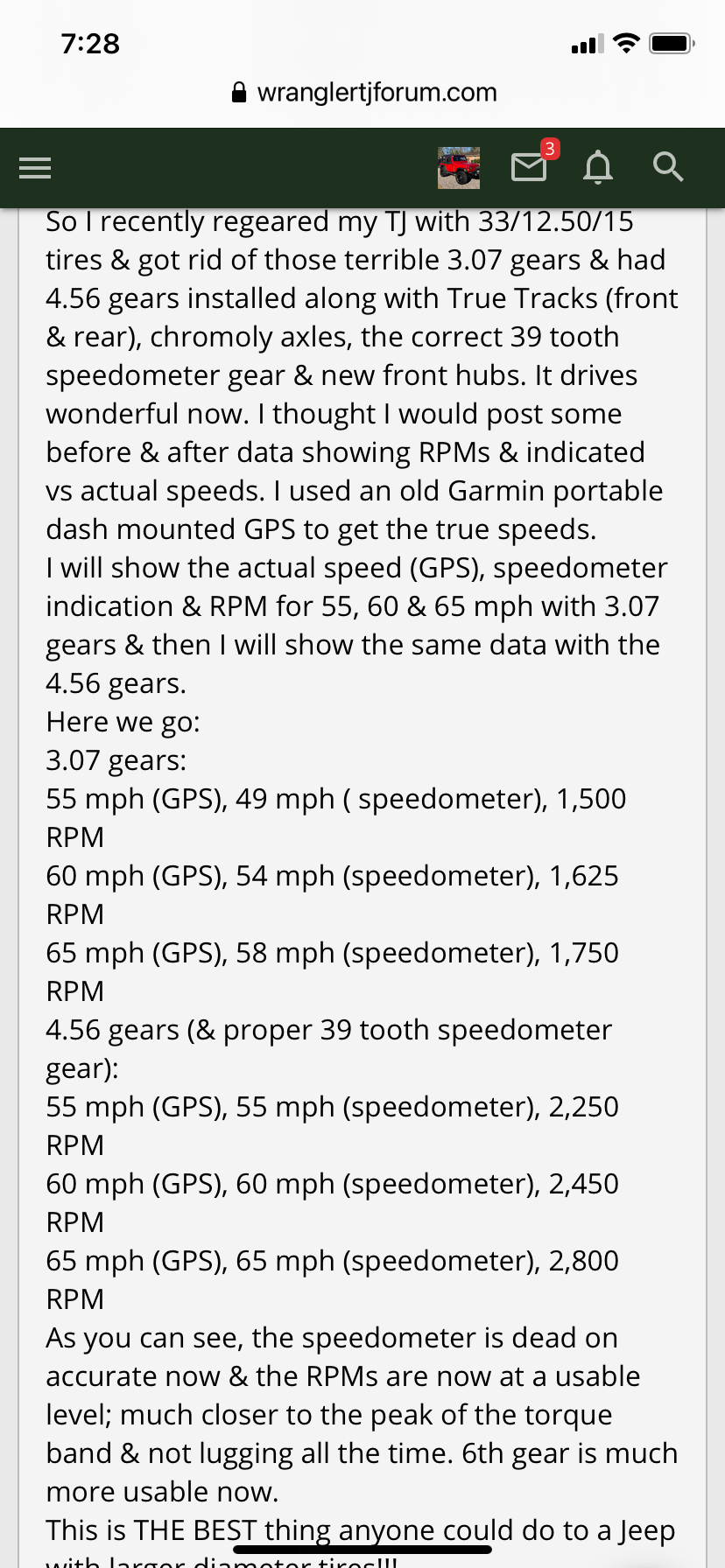

You’re going to love 4.10 gears. Honestly, I will never understand why they ever put 3.07 gears in Jeeps. Your gas mileage will improve because you won’t have your foot in the gas all the time trying to maintain highway speeds. 4.10 gears would also be good if you ever went up to 33” tires.
While you’re in there changing gears I recommend installing some kind of lockers or limited slips & chromoly axle shafts because you’re already in there changing gears.
I know that our Jeeps are different because I have 33” tires & 4.56 gears, but here’s some “before & after” data concerning my gear change & getting rid of those awful 3.07 gears.
