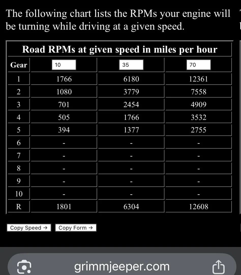

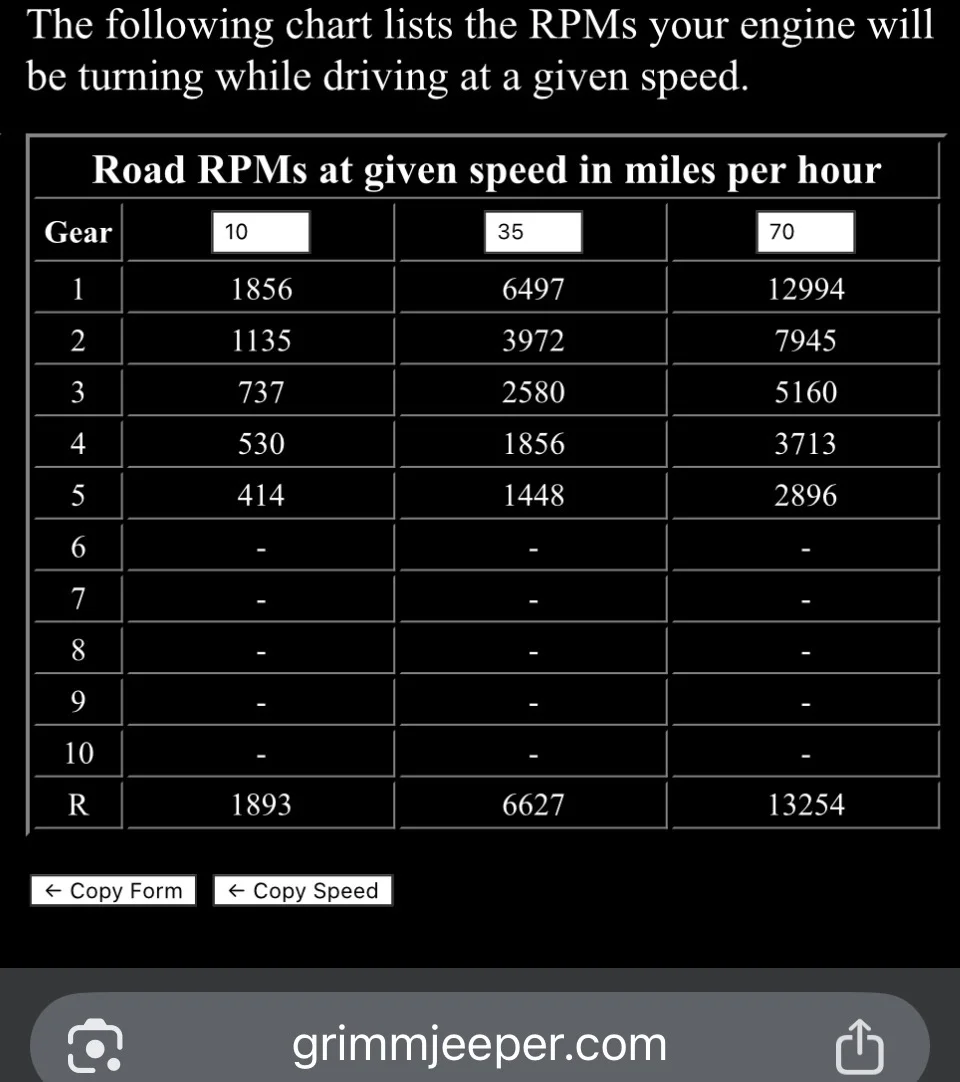

I have a regearing question that I'm open to suggestions and answers. I just bought another TJ (because one is never enough) and this one is a 2002 4.0L 5spd with dana 30 front and dana 35 on the back (LSD) . The stock gearing is 3.07. I'm going to be lifting it by 3.25 inches and putting on 33's. What gear ratio would best suit a general mix of driving conditions like city driving and moderate trail driving. For the most part this will be my daughters Jeep so it's likely to be more the pavement princess. Open to your suggestions Thanks!!
