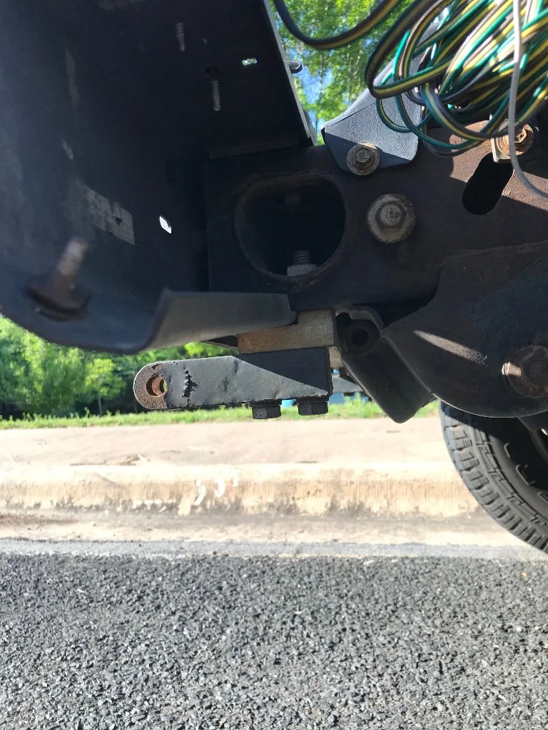

I'd like to remove some hardware that my Jeep has on the front bumper that was used to tow it. Take a look at the attached picture. What do I need to do to return it to stock? Thanks in advance.
There's only one bolt on the underside on each frame rail that holds the bumper in place. (2 on each side on top). Simply unbolt that device, and then get some shorter bolts and put them in. I believe 1/2-13 is the thread size. Flange bolts are preferred, but a standard hex and washer is fine. Get at least a Grade 5 bolt. Mine are 1.5" long.
