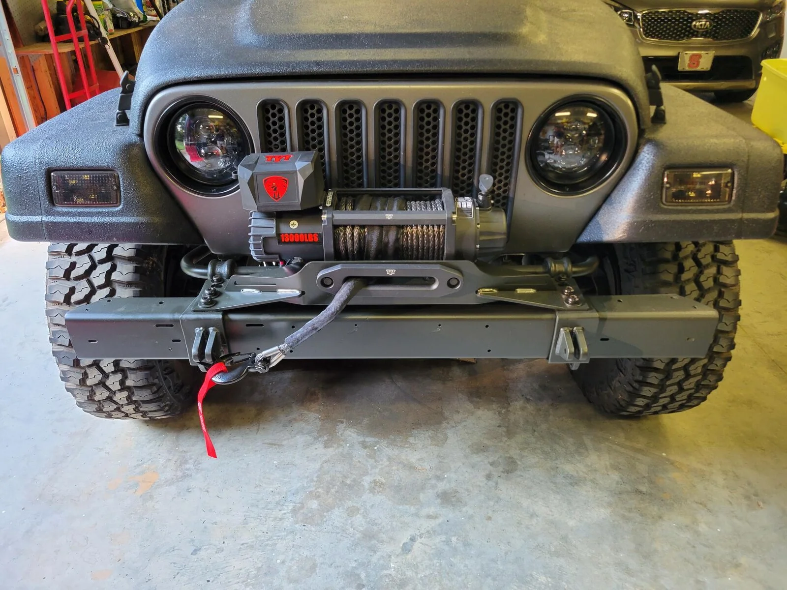

I did a search and didn't really see anything on this. My apologies if there's another thread already. Please point me in the right direction.
I'm looking for good LED fog & general purpose bumper lights that are compatible with the original wiring harness. I just removed the original 97 fog lights (I was amazed at how good condition they were still in and working lol but they don't go with my current theme) I'm looking for some with blacked out / smoked lenses if possible to match what I've done already, but that's probably not an option.
Any recommendations are greatly appreciated & thanks in advance you guys always give great advice.
