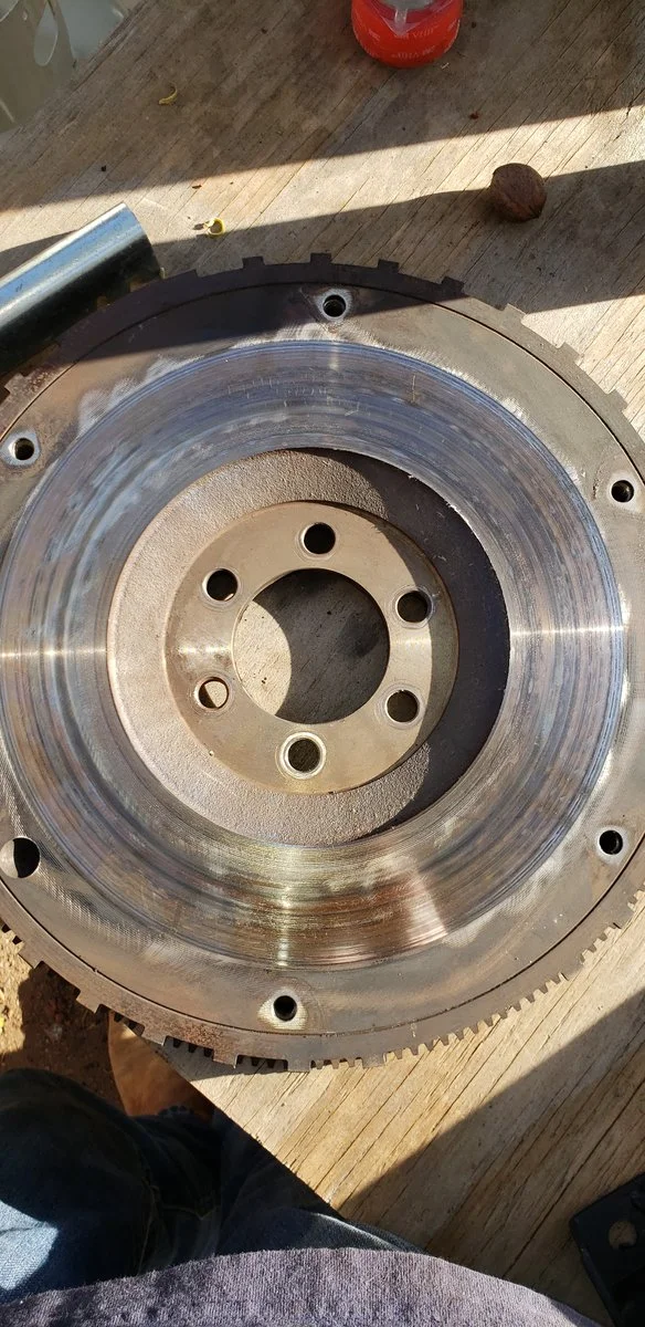

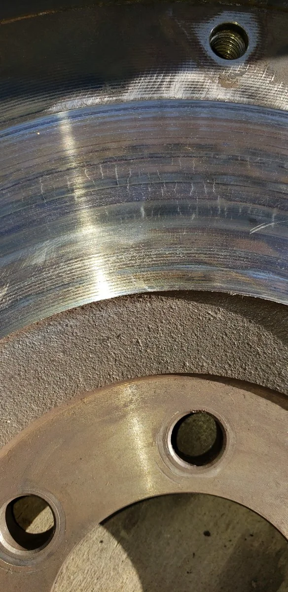

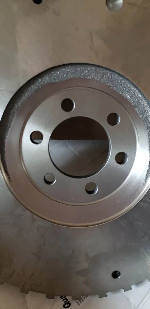

I am drawing alot of blanks on finding a good replacement flywheel for my 2006 LJ. I ordered a crown brand flywheel and one hole is to small and the milling is terrible. Turns out actual part number on product is referenced through other brands online for around $90(crown was $200). Luk lfw484 is no where to be found.
So my options are terrible quality for under $100, centerforce for $300, or OEM for $400. Surely I am missing something. Autoparts stores do not even bring anything up. I know it is a dual mass but I did not figure there would be so little support.
Old flywheel is toast at 65,000 miles. I think it is due to taking abuse from being under geared its whole life(3.73 and 35s).
Have it turned and run it, there are those who feel that the bevel grind the factory did is super important, I am not of that group. My 800 hp 572 hemi has a flat ground flywheel, came that way stock. Good luck, tim

It's a tough dilemma, and after I saw the options I went with Mopar. The cheaper Crown flywheel is a part I would use as a last resort, while Crown is a great source for Jeep parts, their quality is bleh. Centerforce wasn't worth the risk, they are known for high performance which the Wrangler is not, so Mopar was for me. I really wanted a Sachs flywheel but could not find one. Look up Sachs DMF91170 to see if you can find one.
I bought a Centerforce high inertia flywheel. It's almost twice the weight of stock, so it adds a lot of rotational inertia to the engine. Makes it nearly impossible to stall. I have had zero issues with it, and like having the extra weight. It fit perfectly.
Only problem is it is very expensive. More than most will want to pay.
