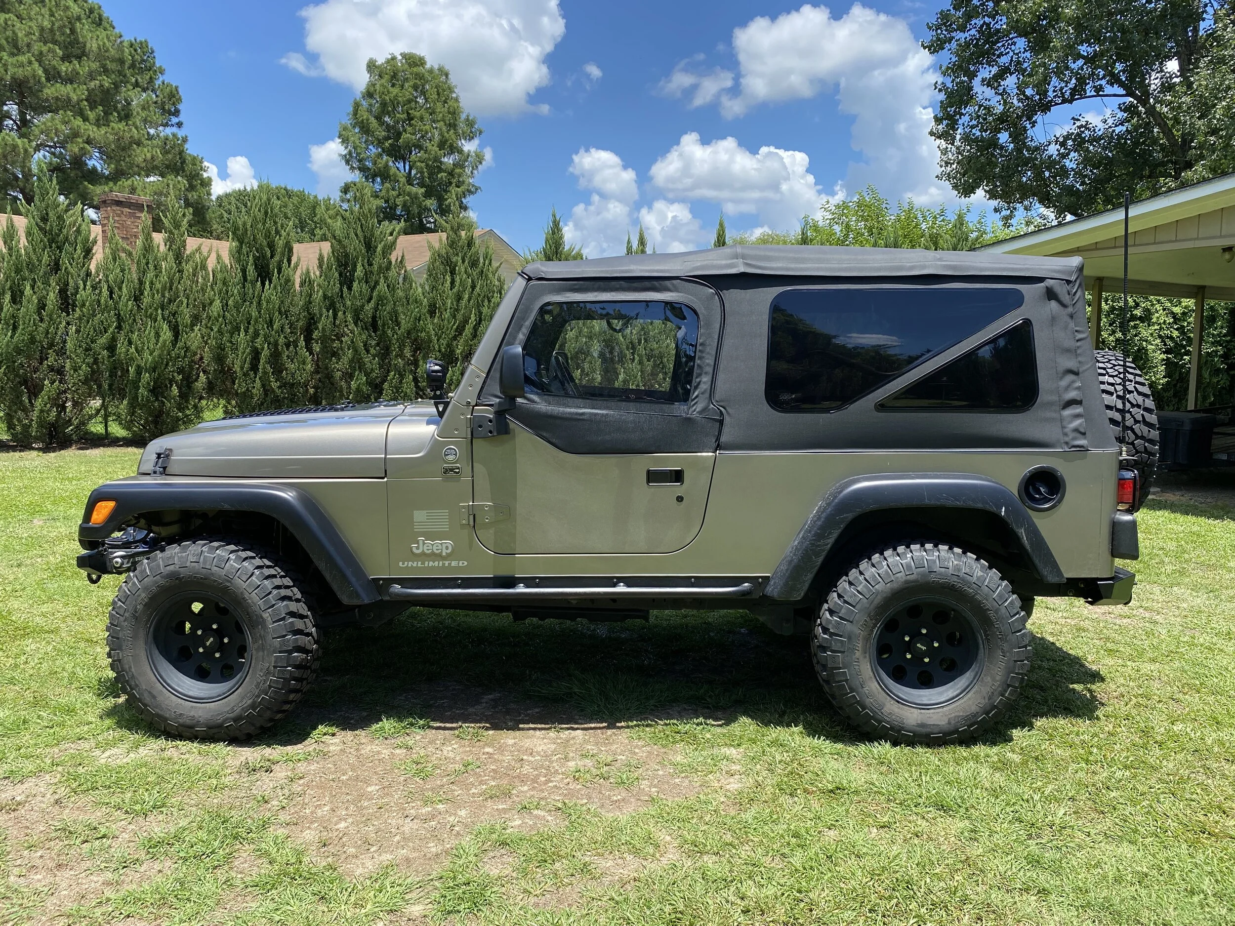

For closure on this thread.. I bought a set of used, straight frames, retro fit the uppers I had (quite possibly the hardest job I've done on the TJ).
Done.
You can get tinted soft uppers HERE . They are currently out of stock and about $60 more than when I bought them in 2021. :( It might be worth checking back every now and then though. Installed easily and fit well.

Those are a nice level of tint. I’ll keep an eye on them.
Also notice they don’t suffer from the same issue as the ones I have .. The back lower corner on yours fit the contour of the door surround better than mine. I can't get the upper down any farther. Pretty sure my issue is with the skin and not the frame..

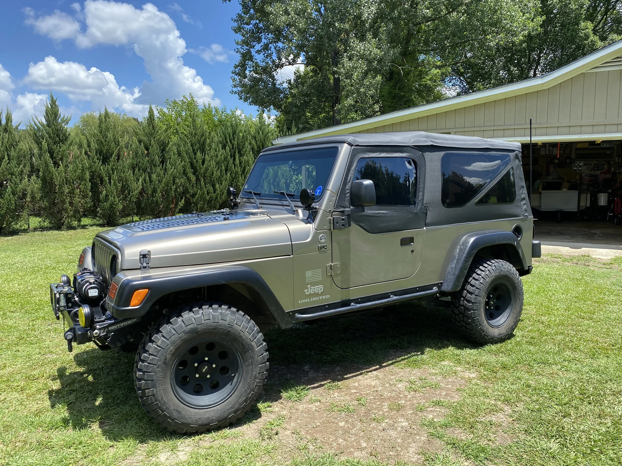

Those look nice! Any problems with quality 3 years later? They appear to match up pretty well with your top.
BTW I read through your entire build thread. You did a very nice job keeping that Jeep tastefully upgraded and still looking OEM. I’m in the process of doing something very similar but mine needs a ton of work done. I’m almost certain if it didn’t wind up in my possession it would up parted or in the scrap yard.
Reactions: MountaineerTom
I haven't had any quality issues. I only ran them a little while in the fall of '21, spring and fall of '22 and '23. They have leaked a little around the seal where the top front corner meets the windshield/door surrounds during really heavy downpours. I kind of expected that though. It did it occasionally with the full doors too and my RallyTops hard top leaks more than anything short of not having a top on at all. :LOL: My top was 4 years old when I added the tinted soft uppers, and I was pretty happy with the match.
