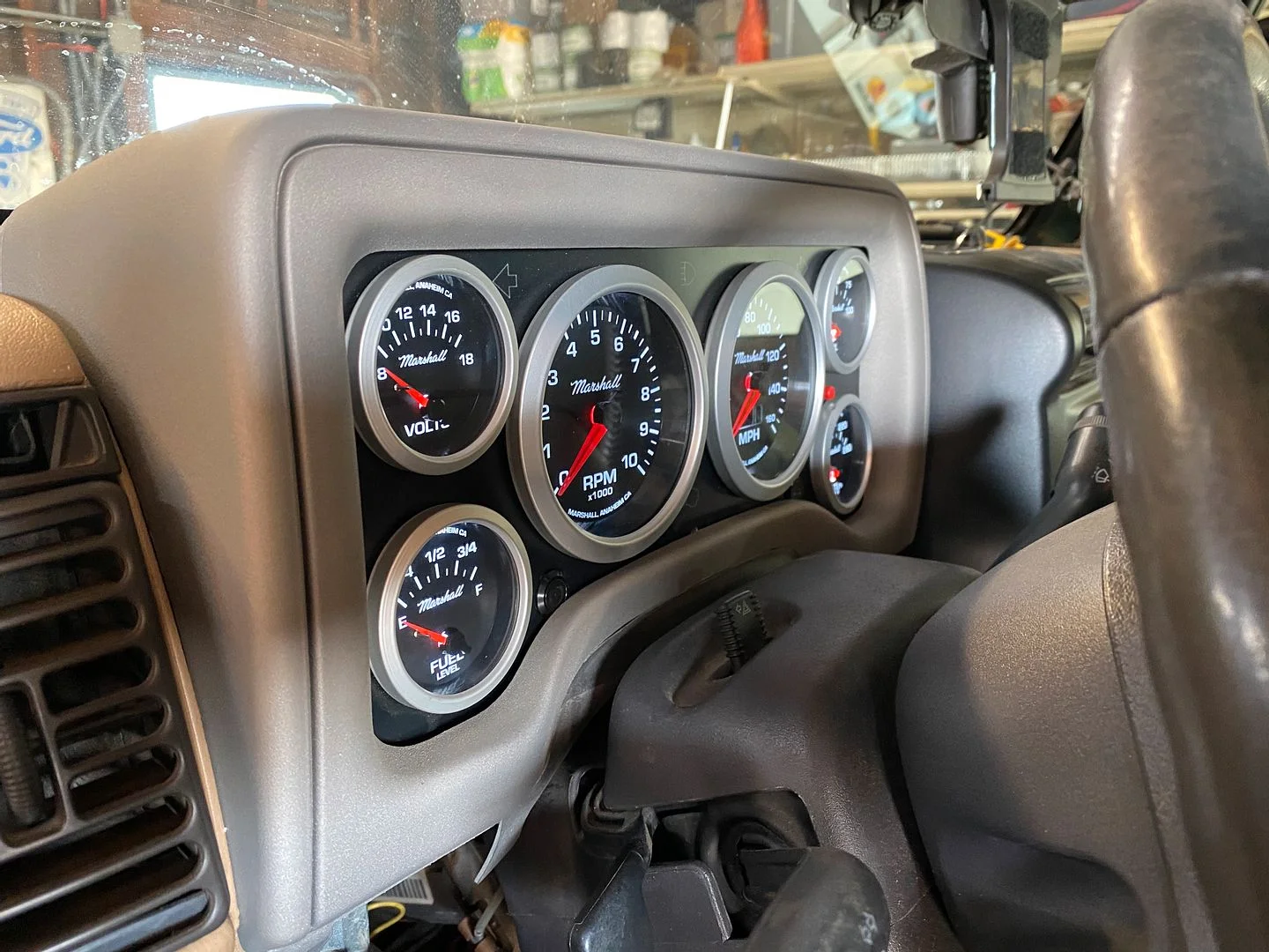

Dash:
I started by removing everything, airbag, plastic dash it self, metal frame the dash mounted to, and so on. Then I took a piece of 1/4 inch plywood and started making the flat piece that would go from one end of the jeep to the other, after that it was a matter of making the piece to fit on top so it would meet with the windshield. If anyone wants the measurements and or diagram for the dash just let me know and I can make a template so other people can use it. I do plan to refine it and or make it better so it is a bit easier to use and fit gauges in.
After I made the plywood template I prepped the plywood so I could use it to make a fiberglass version of it. Then after that it was just a matter of cutting whole for your gauges and any switches you would like to mount. By using fiberglass it made drilling very easy.

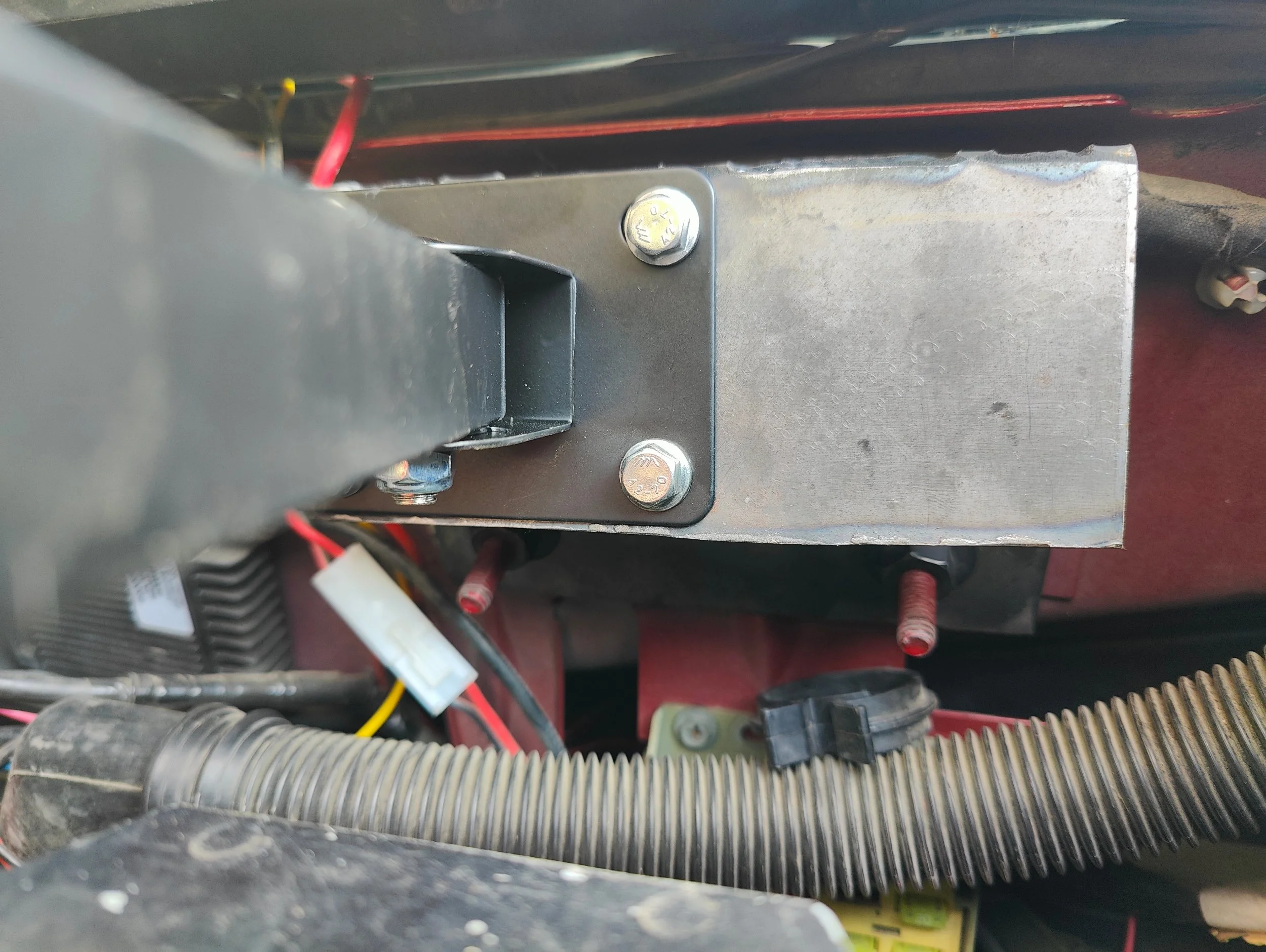

With this said I took a 20 gauge wire and spliced it into the existing speedo sender located at the rear of the transfer case shown in the picture below.
The wire color you are gonna wanna tap into should be white with I think a stripe but I don't remember but I know for sure it is white.
