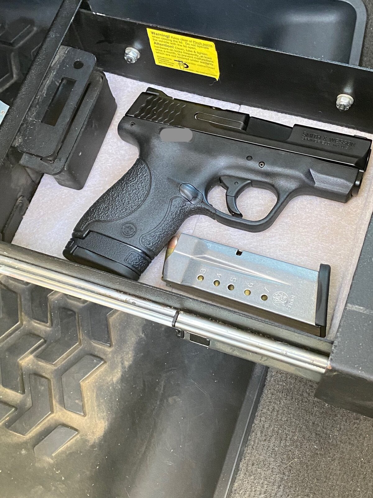

The smaller box fits my needs. ;)
The problem I have with putting my CCW in the Tuffy under seat box is that it requires the key to open it. That's like carrying without a round in the chamber. By the time you realize you need it and then get it out, you are screwed.
Oh mine is not always locked ;)
Only when leaving the jeep with the gun in the box do I lock it :)
