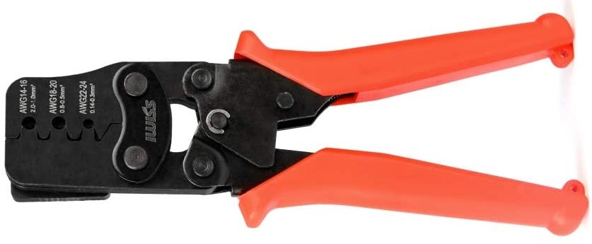

6. Crimp new terminals. I bought a crimper for this because it did both parts of the crimp, the wire part on the terminal and the sealing boot, at the same time. There are various types of these on Amazon but this (or a like model) is what I got.

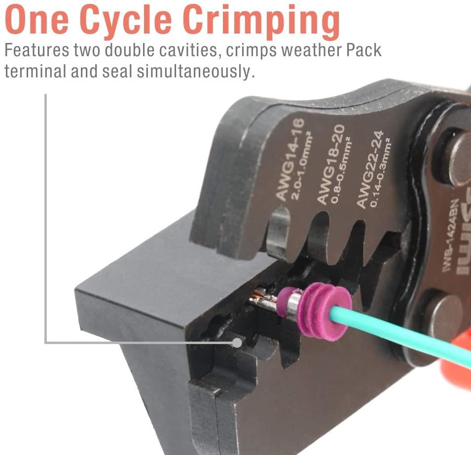

As mentioned, I used Amazon. I searched using the terms Delphi, Weather Pack, and Metri-pack. The key here being where the wire goes requires a tighter and different crimp than what the seals do. Most of the pliers I found have two different sections to do each step. I thought the one step approach would be better, but I still dressed up each crimp on the seal, so that was a wash.
The crimpers I got also came with a block that attachs on the rear face, supposedly to hold the terminals and index everything properly. Only I couldn't get the square terminal ends into the block deep enough, so I took it off and still got everything lined up just fine. Actually, I found it easier to do this way because I could see how the wire was in the terminal as I started crimping and readjust to keep it in the right spot, if necessary.
This is a closeup of similar crimpers in use.
