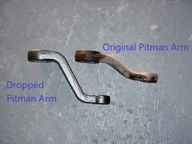

I'll start with your bump steer issue. Do you know if your Pitman arm is stock or "dropped"? This is what connects from the steering box in the front of the Jeep to the drag link. And look at the driver's side track bar mount, does it look like the one in the below photo, or has there been an additional bracket welded to the bottom of it that the track bar is bolted to?

thanks jerry! I have checked both of those, both are stock.

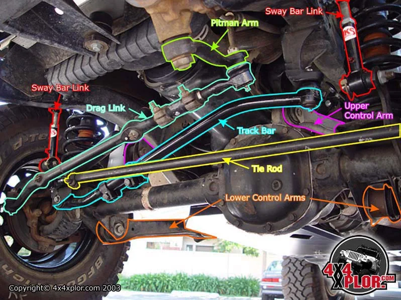

My recommendation would be to get your bump steer issue taken care of first. You need to ensure the drag link and Pan Hard a close to parallel, etc..... Possibly post up a picture of the front end and someone can see something that stands out.
