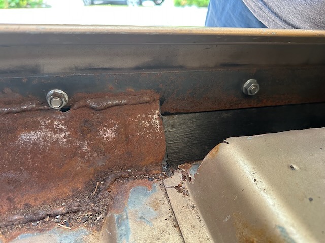

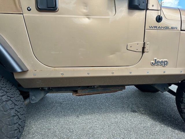

Here are pics of the rocker panels
Pic above is inside brace the guy welded in

Really though, doesn't the tub have to be smashed in to make a boat side type rocker for that? You'll probably end up needing to keep a rocker like that even if you cut out the rust

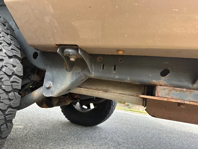

Looks like a boat-side rock slider with interior bracing, not a rocker repair. Am I missing something? Is there rust that you know of behind it? If you want to remove that and return to factory-like rockers, sell the Jeep and find another one.
I can't tell if it's the boat side or the tub below that's rusting

1. The rockers are a better job than most shitboxes I see for sale. And they even color matched the boat sides which is impressive as hell for desert sand pearl. Maybe pull apart and clean/paint. But that's a lot of work if there isn't any rust other than surface.

Being a fellow rust belt person, if the frame is actually really immaculate, I think you have plenty to work with there. The Tcase is really no big deal and good used ones pop up all the time on marketplace for 200-300 bucks, and its pretty damn easy to swap out, just make sure you do your research and get the right one, there are a few different ones.
I can't evaluate the rust from here. If you really hate the boatside rockers, you need to find a decent welder or learn to do it yourself. It's steel, anything can be cut and welded any way you want, and you can purchase or fab rockers that will look factory. Or just run it as is.

Bottom line: If the frame is truly good (i'd go over it very carefully) and the body isn't a total rust pile, you've got a good canvas. Finding anything with a good frame up here is tough for any kind of decent price.
