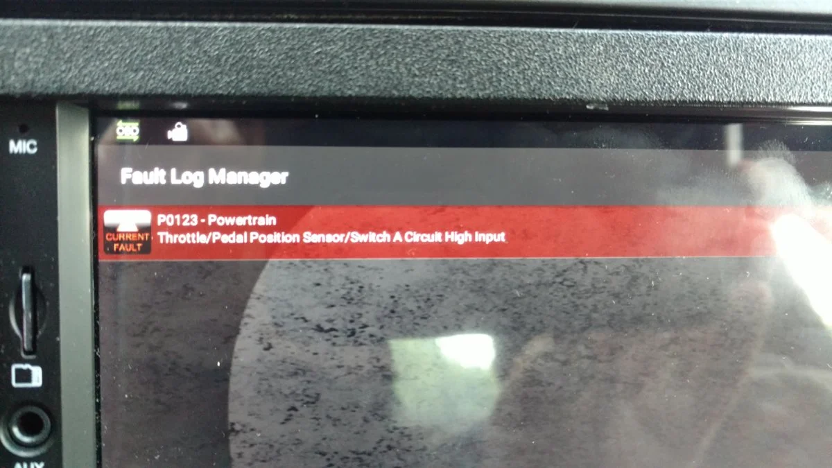

This is a summary of my TPS problems. I'm about to give up because I can't figure it out.
started with the p0123 error code with an additional p0121 sometimes at random.

when I clear the code I can drive around for 20 miles perfectly or so before the code pops up and the engine starts bucking so bad it's barely drivable. Then the same code comes back. the check engine light and engine bucking started twice when leaving a stop sign and making a left hand turn yesterday it was going straight down the road at 55 miles an hour steady. the other dozens of times were just at random that I don't remember. once the check engine light comes on it never goes off unless I clear the code.
