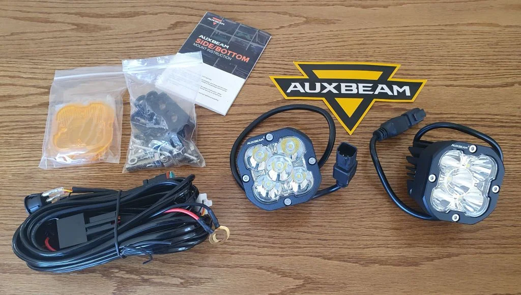

Here's what's in the box - two pod lights, a bag of hardware, two alternate yellow lenses, a wiring harness and a large Auxbeam decal. There's also a set of instructions, but they're the wrong ones - the instructions are for a light bar and have nothing to do with these pod lights. Instructions for these lights aren't really needed - installation is very simple and the included wiring harness is pretty much foolproof.
The light pod housings are substantial aluminum castings and serve as the heat sinks for the LEDs. The mounting brackets are powder-coated steel, and one thing I like about them is that they can be angled so the pod can be mounted on an angled surface.

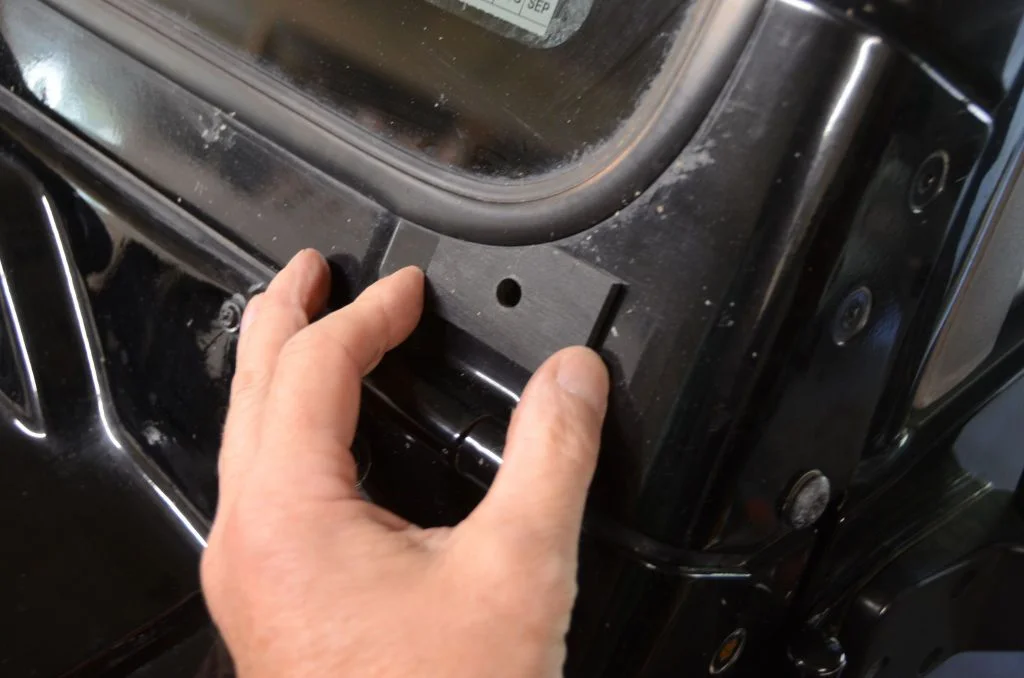

One angled surface they can mount to is a Wrangler windshield frame. Many other lights would require a separate bracket, but these can angle enough so the light can be bolted directly to a windshield frame bolt (more on that in a moment). I'm holding one of the pods in place against the LJ windshield frame in this photo:

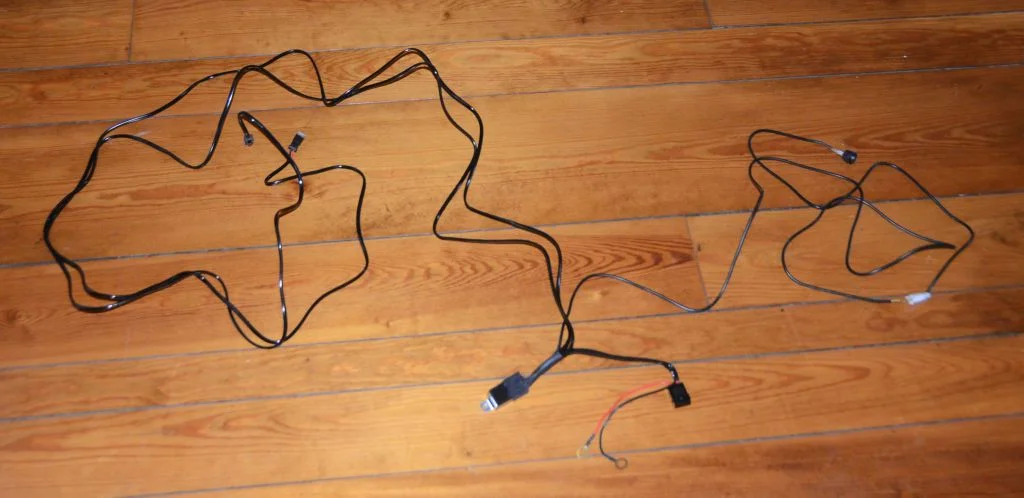

The wiring harness is well thought out - it's excellent and very complete. Each leg is about 10' long, so it's hard to imagine a situation where it won't be long enough. In this photo the harness is laid out on the floor and the light ends are at left, the engine compartment end is in the center and the cockpit end is at right.

For a the first mounting test, I installed them on my LJ's windshield frame. The TJ/LJ windshield frame has several different bolts these could attach to, but I decided to attach them to the uppermost bolt holes above the hinge for best clearance of the light beam from the hood. In this location, the base of the pod mounting bracket interferes with the windshield seal, so I made up simple spacers from 1/4" ABS.

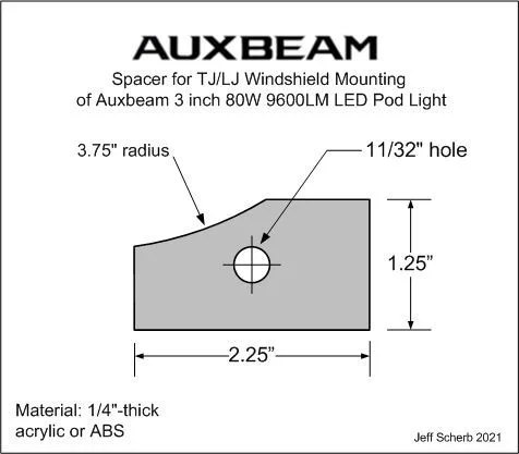

Mounting on a bolt hole below the windshield hinge (or on the windshield hinge bolts of a JK, or on a commercial windshield mount bracket) won't require a spacer. Here are the details of the TJ/LJ spacer, they're very simple to make:
The drawing above can be printed at actual size to serve as a template for making the spacers (that's what I did).
When you consider that a separate, extra-cost mount won't be required to put these on the windshield frame, I think the need to make up a simple spacer to mount them exactly where I want isn't too much to ask.

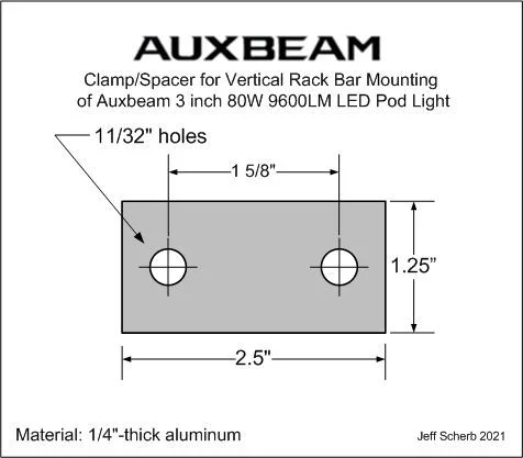

For real testing, I'm mounting the pods on the roof rack - this rack is used on both the LJ and the JKU so the lights will be there for whichever Jeep the rack is on at the time. I wanted to mount the pods on the vertical bars on the front of the rack basket so I made up a clamp to mount them. It's pretty simple, a couple of pieces of 1/4" flat aluminum with two holes drilled in each, and two bolts. The front piece of aluminum is to space the back of the pod housing away from the bar and the provide additional support for the Auxbeam mounting bracket. I also drilled two holes in the Auxbeam mounting bracket to accept the bolts.
Again, making up a couple simple pieces of flat aluminum is a simple task and avoided the need to buy separate, extra cost light mounts for the rack.

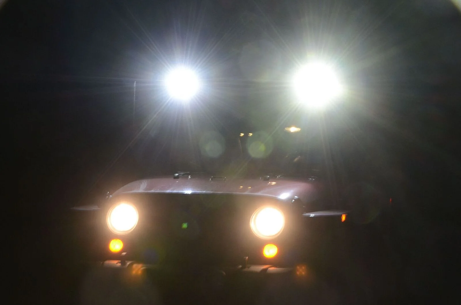

After dark I set up a quick test. I set my bicycle about 100 feet away from the Jeep. Left to right - low beams, high beams, LED pods:
The camera was set to manual exposure and manual shutter speed, so all of these photos are equivalent.
