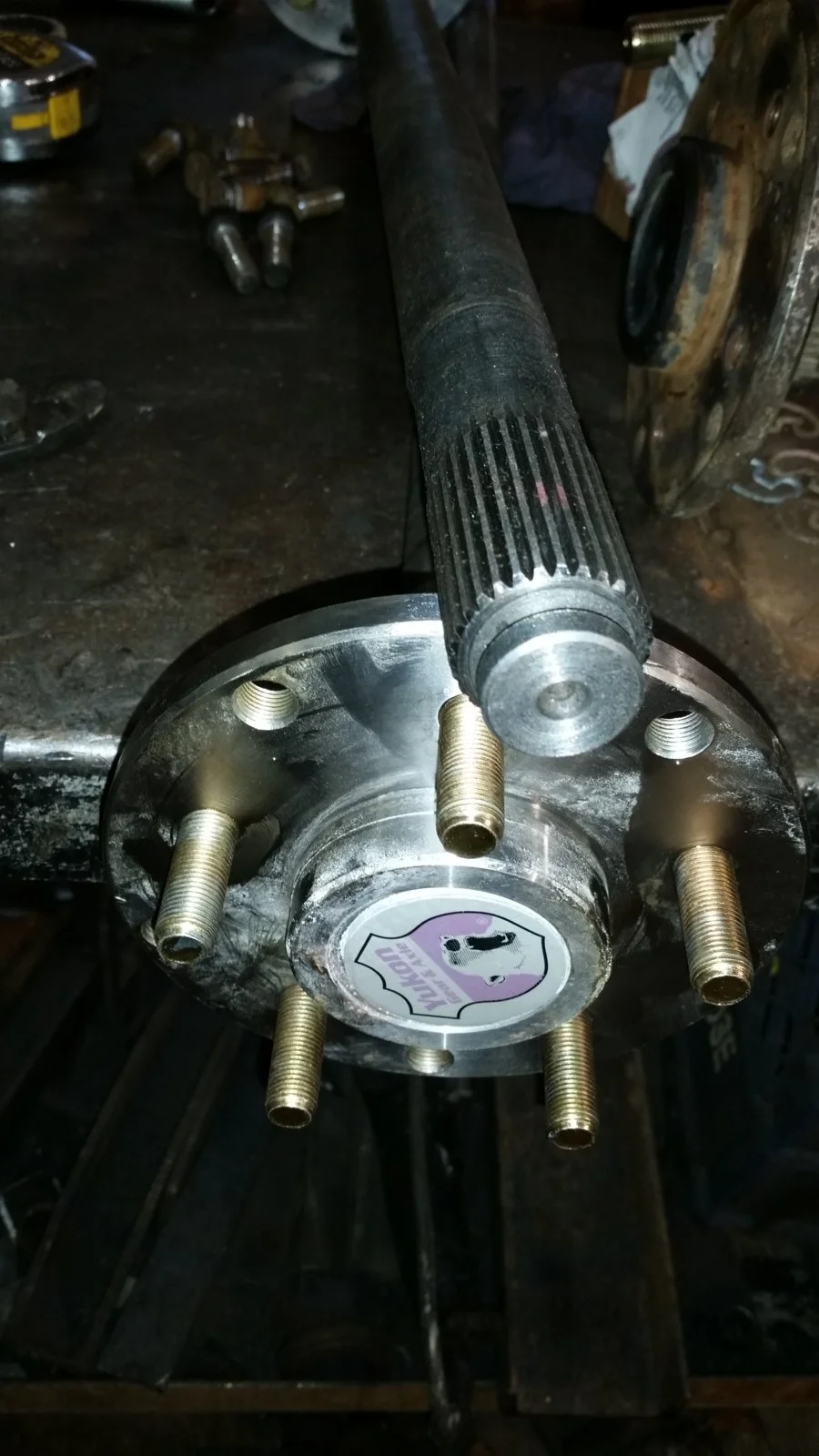

I build tons of m35's with 456/488's zip/grizzly and yukon 30 spline shafts. It lands in the 1500 range with a grizzly locker. parts and labor. Its tuff to find a stock tj44 around here under 1200, then it needs all the same parts in it as the 35 does on top of the price of the core.
For the daily driver that gets alot of trail usage with tires under 35" its very dependable. If you can bust the 30 spline m35 shafts, a 30 spline Dana 44 isn't an upgrade without 33 or 35 splines stuffed in it.
