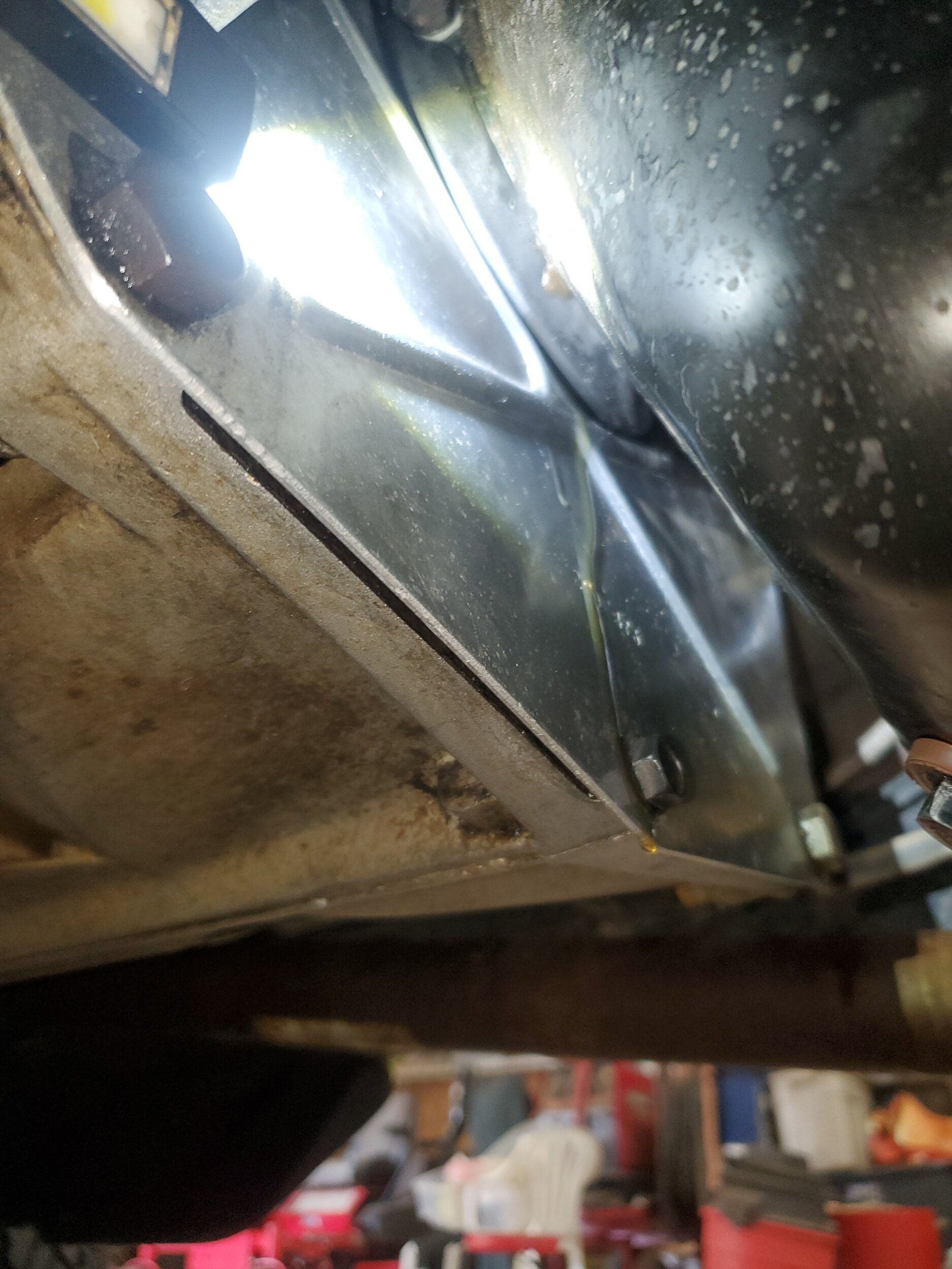

First rear main that I've had issues with getting resealed. Catalytic converters went out and figured I'd change it and oil pan seal while I had it all apart. Put it all together using anaerobic sealant off setting the seal and it started leaking instantly. After about 500 miles I finally decided to do it again using rtv like the dealership used 17 years ago. Same thing happened again. Uuugggghh frustrating!!! And to top it off went to pull oik cap and it broke the internal tab. Sorry just a rant.
First rear main that I've had issues with getting resealed. Catalytic converters went out and figured I'd change it and oil pan seal while I had it all apart. Put it all together using anaerobic sealant off setting the seal and it started leaking instantly. After about 500 miles I finally decided to do it again using rtv like the dealership used 17 years ago. Same thing happened again. Uuugggghh frustrating!!! And to top it off went to pull oik cap and it broke the internal tab. Sorry just a rant. View attachment 538684
Are you sure the leak isn’t the valve cover, PCV, or CCV gasket?
I did mine four times. Three Felpros and finally used a Mopar.

Good time to check timing chain tension and document your bearing numbers.
