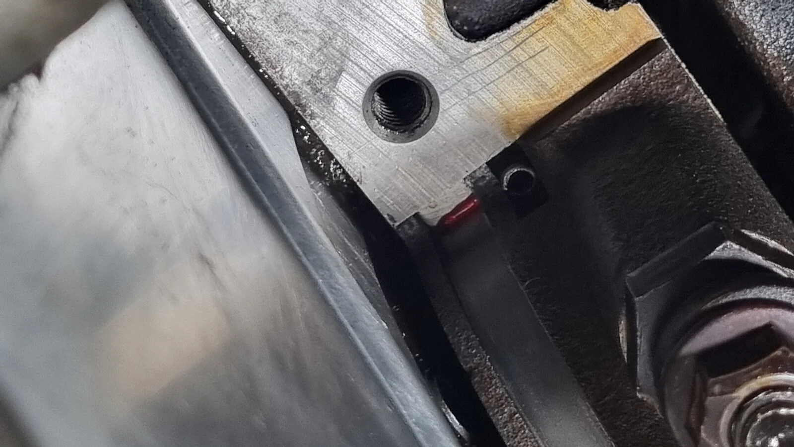

I did my best to do it by the book. I had a felpro oil pan gasket and RMS ready to go. Once I thoroughly cleaned the RMS bearing cap and all surfaces, I applied anaerobic sealant and a light dab of RTV to the ends of the RMS. I also set a slight offset too.

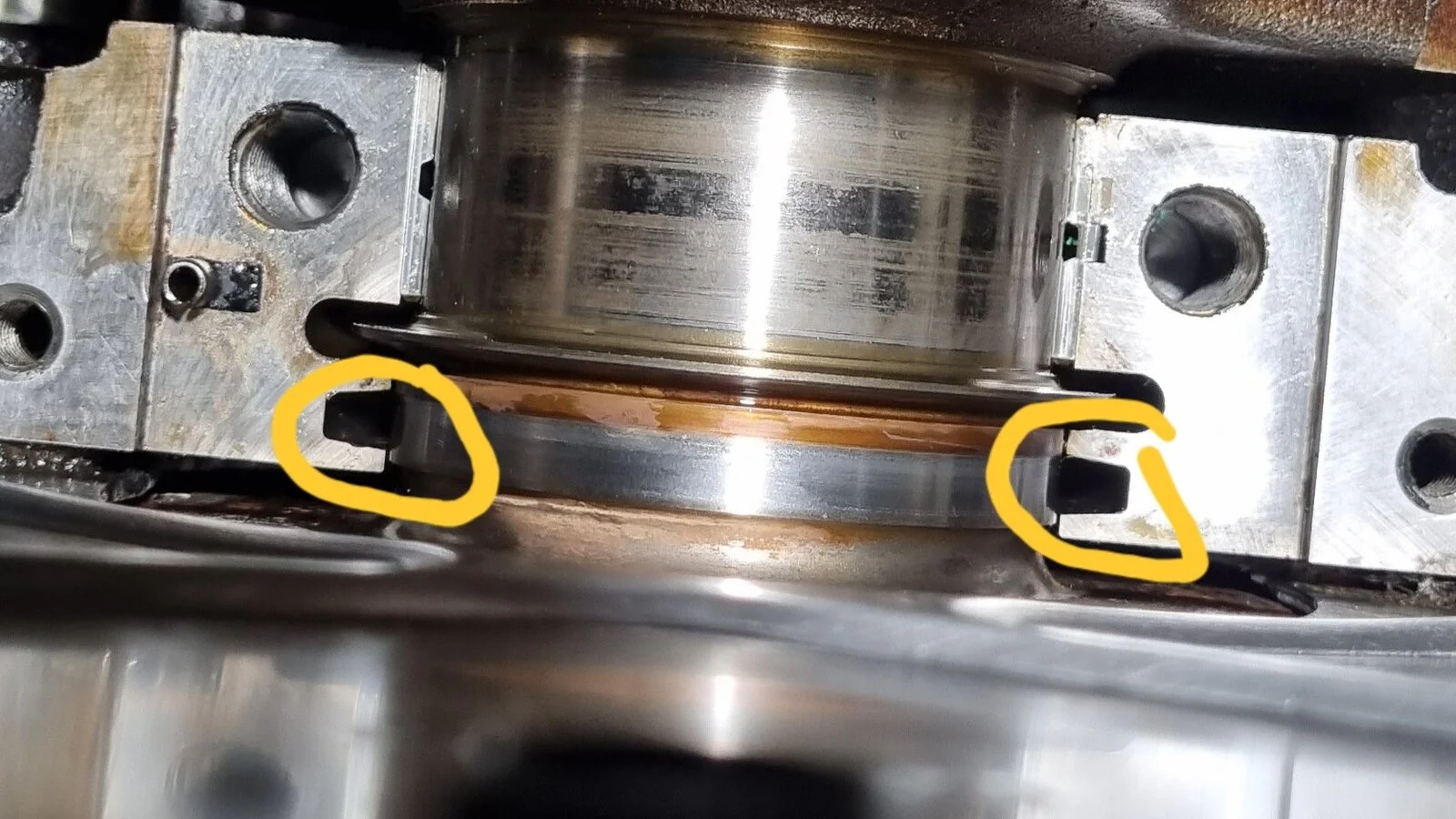

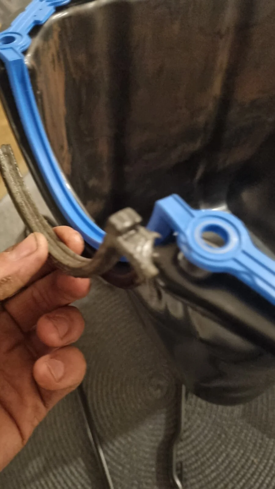

Tonight I got the oil pan off to inspect the oil pan gasket, which was a PITA because of the RTV in the leak prone areas. The gasket split when I took it off around the bearing cap area.
It's hard to tell if it was leaking past the oil pan or the RMS, but I have a few questions for the next RMS install tomorrow.
-How do you clean the top area where the top half of the RMS goes?
-Is it possible I didn't seat the oil pan gasket properly around the bearing cap? In which the RTV held it together initally but gave way on my way home?
-Does anyone have anything to add in regards to what I've done wrong or missed?
-Can anyone confirm if Mopar oil pan gasket's have the extra notch? Photo attached of my old oil pan gasket vs the new felpro.
-When I took the bearing cap off today, there was no residue from the anaerobic sealant. Is that normal? Or did I not put enough on? (Photo attached of when I first put it in).

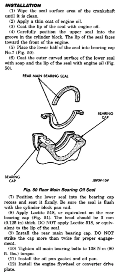

And is this the process you followed? (Locktite 518 is the anaerobic sealant)
Yes. If it was sticking out toward the rear.
I'm going through similar turmoil (thanks @Apparition for reminding me). Use Mopar RMS and RTV.
I don't think it does.
Based on my very limited experience and observations, this should not be the case. I think it washed out.

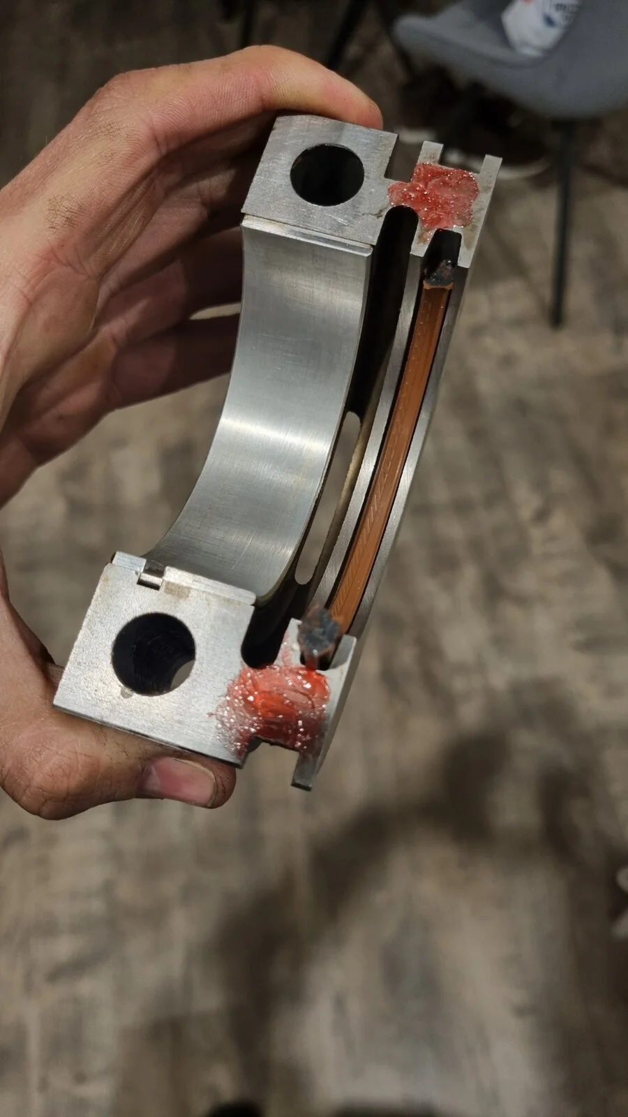

Yesterday i successfully replaced my RMS.
After the first 3 or 4 failed attempts i did noticed people mentioning to do seal offset, and as much as i ran that scenario in my head i could not see how that could be done successfully. Yesterday i was tinkering with that idea while laying under the engine, with everything before my eyes and i still came to the same conclusion. I dont know how tight everyone elses tolerances are in there, mine are tight enough to force me take my sweet time, otherwise sharp edges start cutting chunks out of the seal. And then try to force lower half in there while pushing or pulling upper half at the same time?
Now, lets take it one step further, lets say you successfully offset it without any damage to the seals, how are you sealing up the gaps between two seals?
1. Paper towel and brake cleaner. My main concern is oil free surface, any leftovers from anaerobic sealer is no big deal.
2. The way i see it when you tighten the oil pan, gasket will shift in its proper place or away from it. I dont see how it can be somewhere in between, or work one moment and not work few moments later. If it was badly seated, you would have seen the results of it shortly after (unless you did not check for 500 miles)
3. Try to apply more sealant.
It looks like you went with factory instructions, i did so as well my first 3 failed attempts. This time i used more sealant and everything worked out.
Note how there is enought sealant to fill into all the gaps between seal and bearing cap, as well as 2 cuts between upper and lower half.
4. I can only confirm no issues with FelPro oil pan gaskets, 4 or 5 times i used them after redoing RMS.
5. Anaerobic leaves a very thin layer when it dries. If you apply as much as in picture above, you would notice it due to a slight discoloration, it is still a very thin layer thought. If you take a blade to it you will see that there is not much of it.
