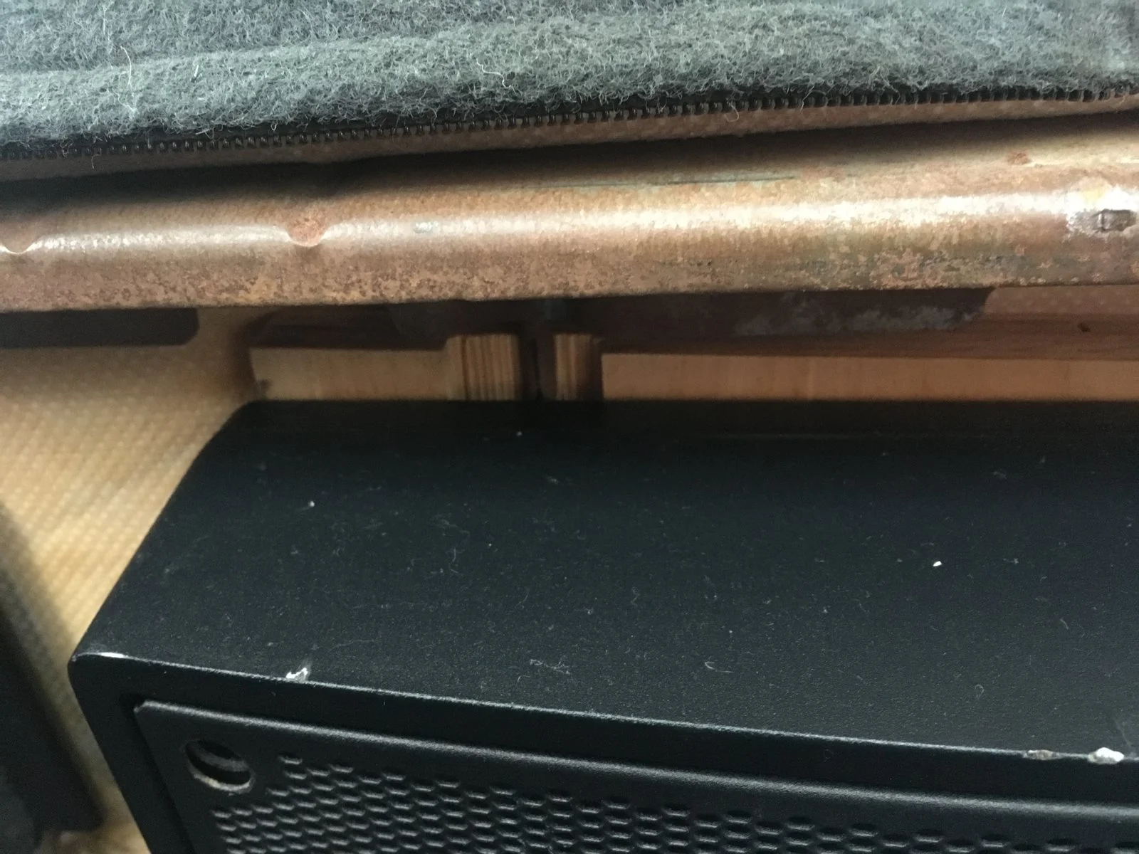

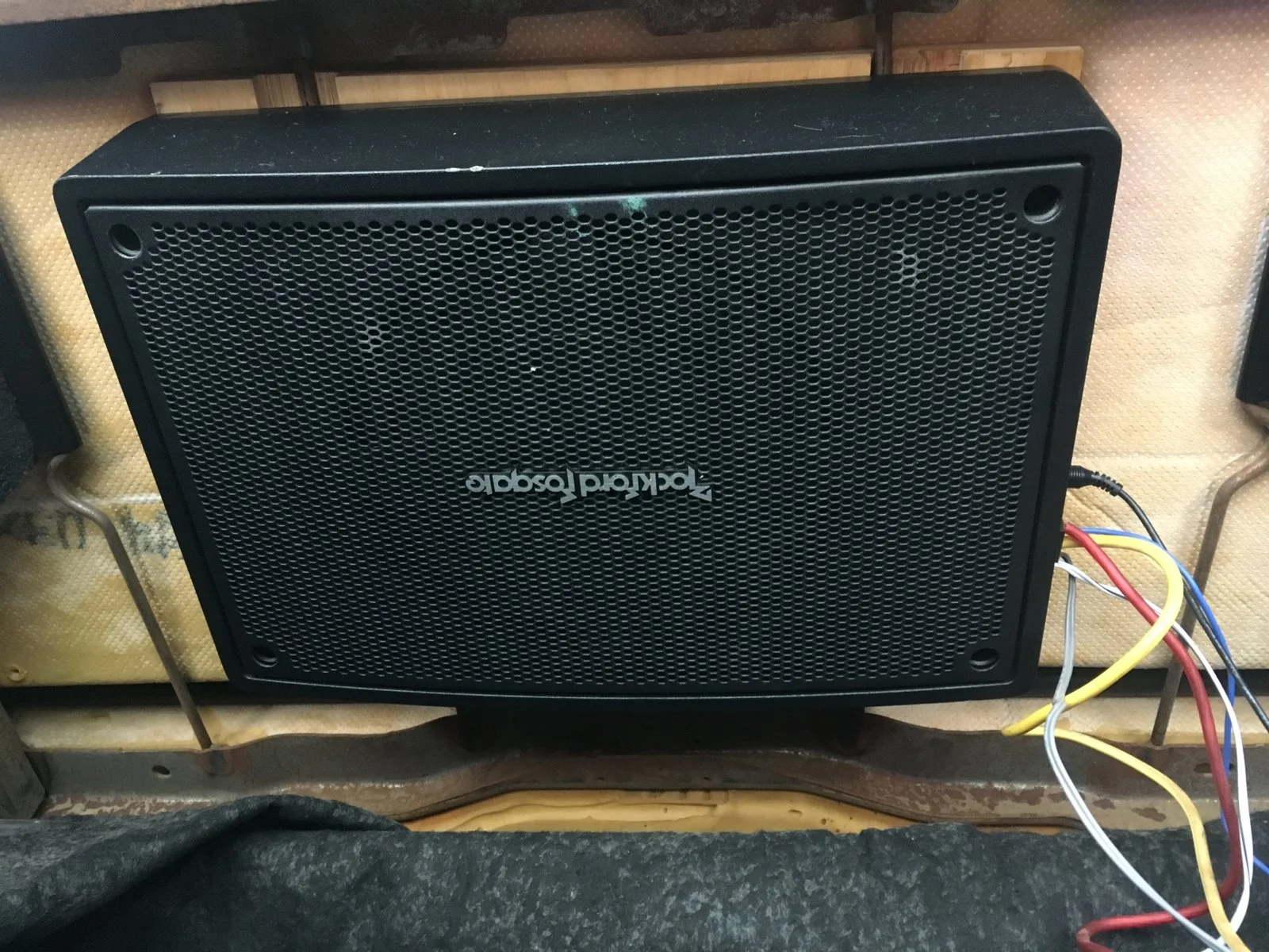

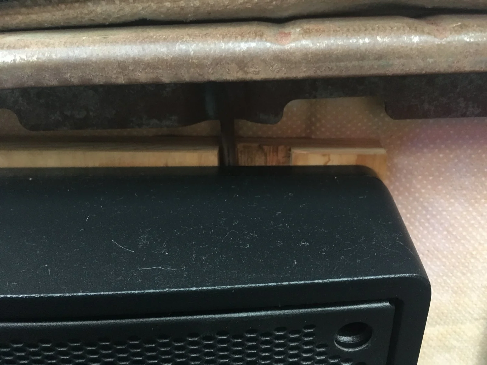

As @Rob5589 mentioned, I too use my rear seat for passengers, so I mounted it on the underside of the rear seat. Took a piece of ply a litttle larger than the dimensions of the PS-8, grooved out about 3/16” with my table saw to fit the wire supports underneath the seat and slid the ply under the wires into position. Then screwed the PS-8 to the ply. Been this way for over a year with no issues. Plus, you can detach and unplug it pretty easily if you remove the back seat for some reason. A bonus is it doesn’t infringe in any of the precious space in our TJ’s. I’ll attach pics in a bit. Sounds awesome

Well I mounted the sub under the rear seat per JMT's creative suggestion. Thanks again JMT. Did some temporary connections to make sure I wired it correctly. Pretty straight forward. I gotta say this sub amp kicks ass. I am so happy with the way it sounds. It's a whole new music dimension for me. Now comes running all of the cables under the carpet, fine tuning the amp and buttoning everything up. I'll post up a photo when I'm finished. Thanks to all that chimed in.

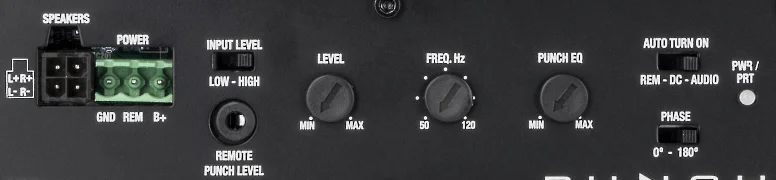

I caved and ordered one of these Rockford Fosgate PS-8 today.....
Since a few of you have installed already @JMT, I got a question. You've got your Ground, REM and Battery hookup. It's my understanding that if you hook up your RCA cables that run into your pre-amp on the back of the HU, you could put your switch on the PS-8 to "Audio" and wouldn't have to run a remote wire... Is that right or am I way off base? I've already got my pre-amp inputs hooked up to my HU, just need to run some cables to them under the dash.. did that in anticipation of my purchase.. :)
That may be right. I don’t remember. What I did was tie the remote into a wire behind the HU. I can look when I get home. I remember the remote wire is blue out of my HU. But I can’t remember what wire it ties into. Crutchfield gave me the answer at the time. I set my switch on the PS-8 to remote, but I recall there were a couple of ways to do it.
Generally the blue wire is a remote turn on used for amplifiers. Some can detect a signal though the rca's so you do not need the remote/blue wire.
Reactions: skrelnik
Ok, I reviewed the owners manual and it stimulated my memory. At first I also used the Audio sense selection. When the signal (music) came on, it took a second or two for the sub to detect it and activate. Since this was a little annoying and the preferred method was to get the signal directly through a 12v source, I hooked up the remote wire.
It will work through the Audio setting though. I hope this helps some. It will sound awesome as @MexiJeeper and others say!
