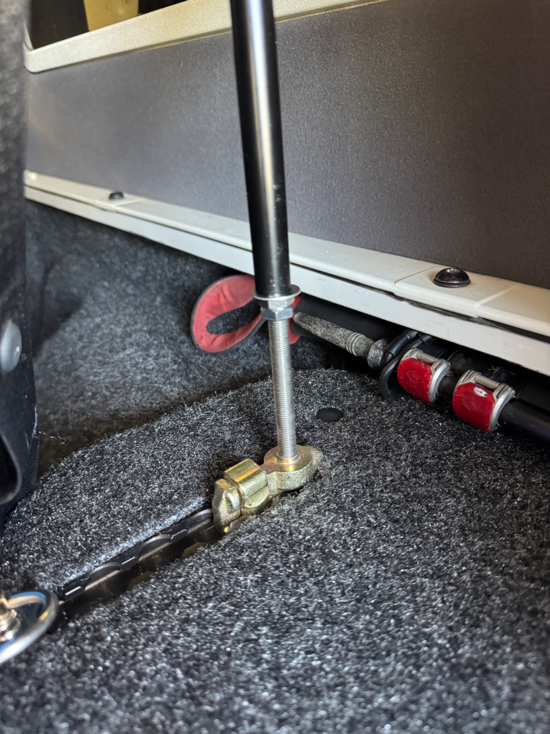

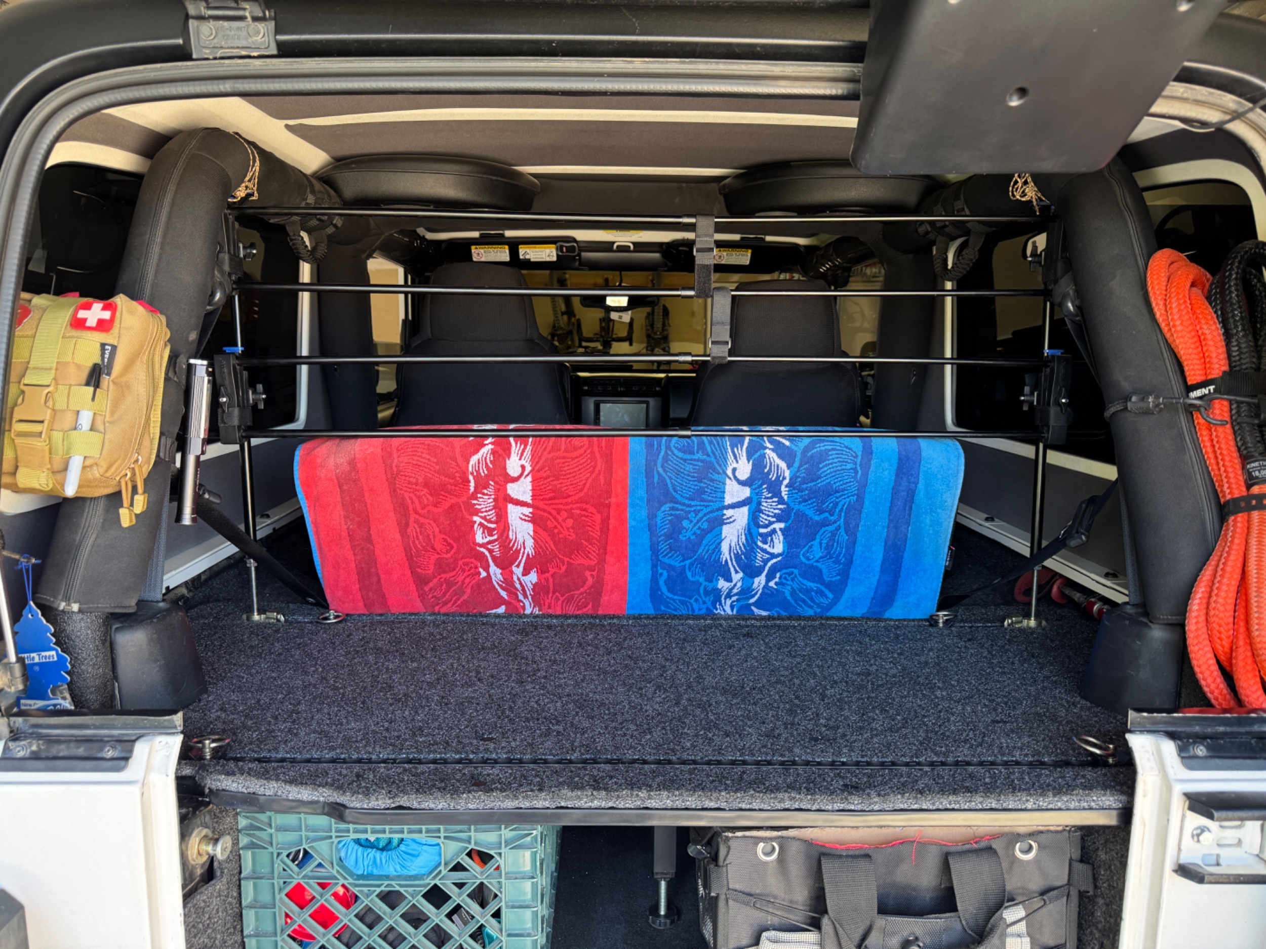

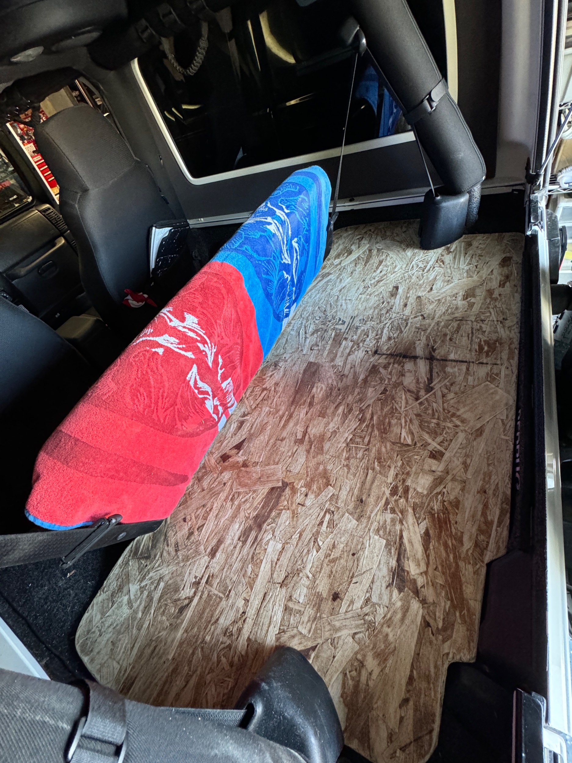

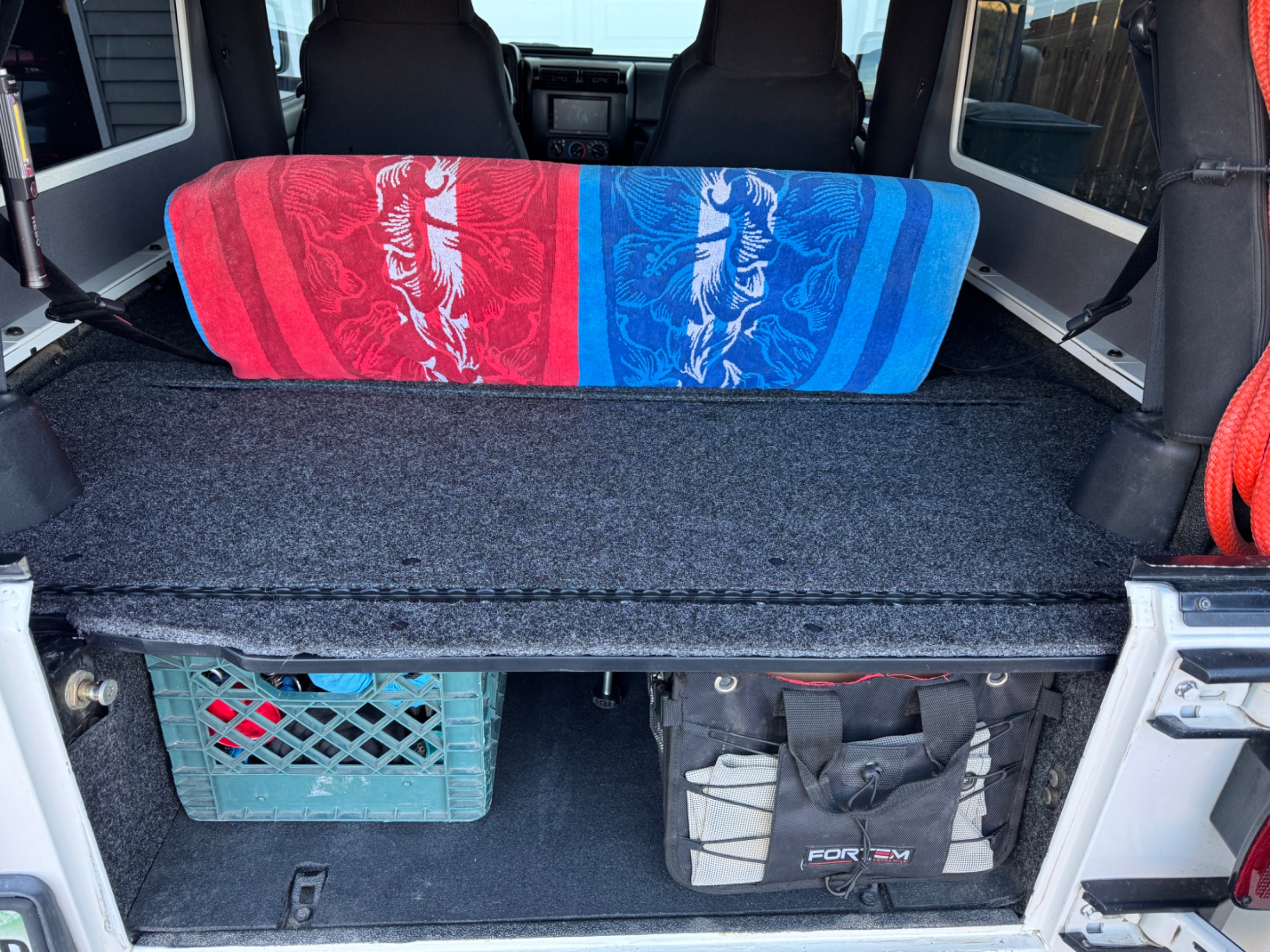

I'm a sucker for a clean and quiet-ish interior so just ordered a BedRug Carpet system (right now it's just truck bed liner), hot heads liner on the top, getting the sub woofer working, stereo system sounding a little better, and seat covers. After that I'm going to drive it as is for a few months while a fix any other odds and ends that pop up, while a figure out what I want the actual "build" to be.

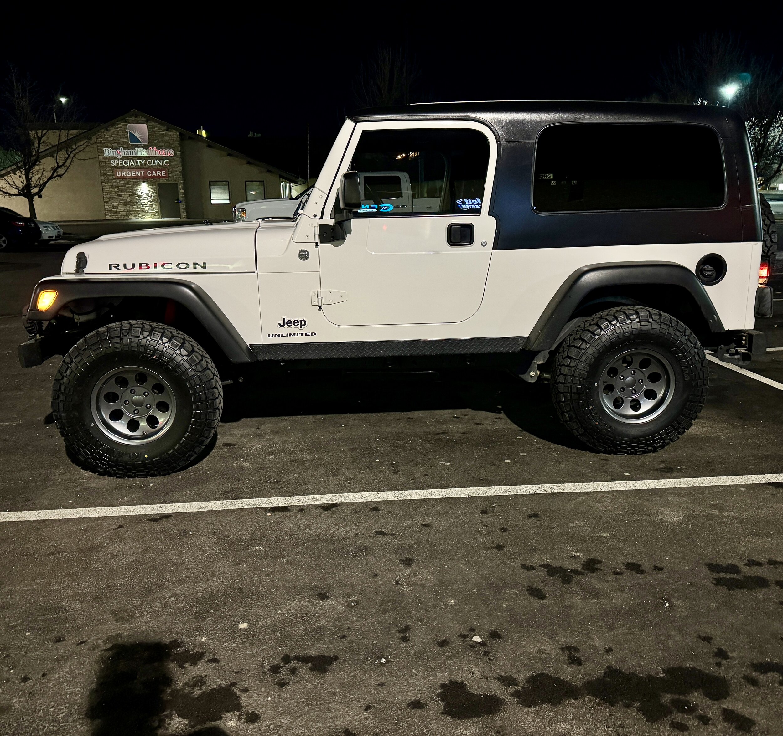

Cruised up a dirt road behind my house the morning after I bought it, cracked tires and all:

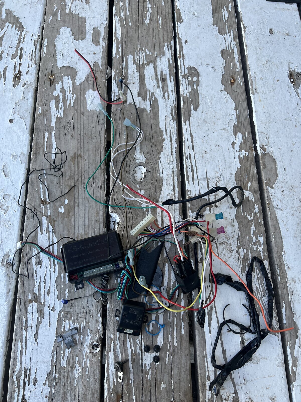

Guessing some of you will recognize this mess… and can probably guess how my afternoon is going. Whoever added all of that chaos also managed to break the cluster bezel and the trim piece under the steering wheel. Overall excellent effort from what I’m sure was a well qualified professional 🤦🏻‍♂️ 😂
  • Sad
Reactions: L J and Apparition

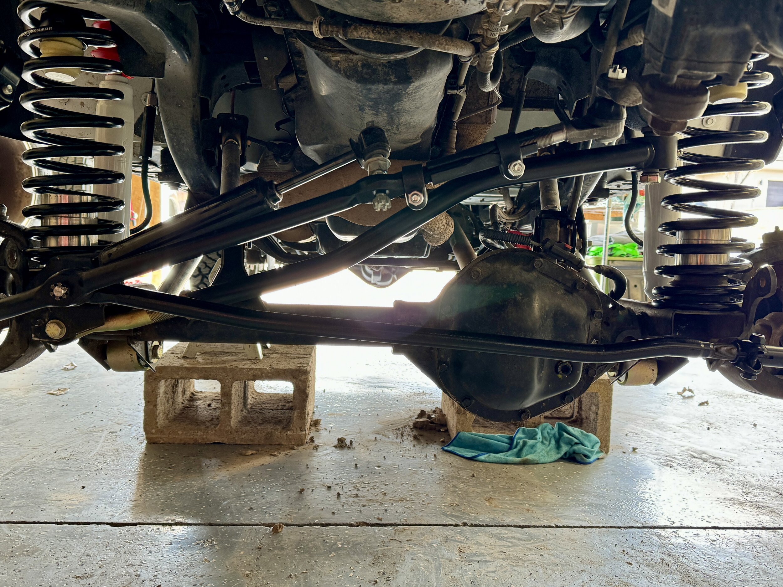

I’ve had vibrations at exactly 45mph and above 60 mph, so I sucked it up and installed some Savvy double adjustable control arms. I adjusted the rear pinion angle and completely eliminated the 45mph vibration, and pushed the higher speed vibration to only above 72mph. TODAY I put on new tires and rims. Haven’t had a chance to test it out at higher speeds but hope the freshly balanced tires\wheels help. I’ve got new u-joints ready to install when the new springs (Currie), and shocks (Rancho) show up so between the u-joints and potential driveshaft balance I’m hoping I can eliminate it entirely. Trying to make changes one at a time where possible to help narrow it down.

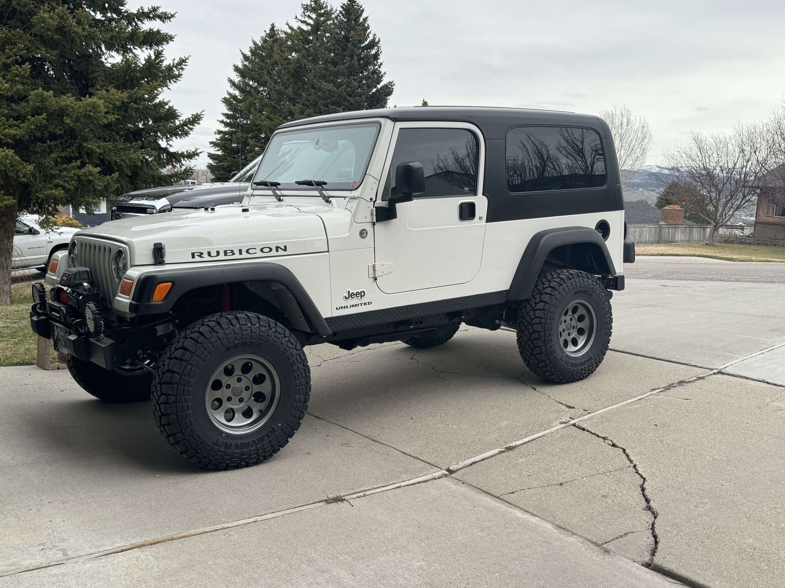

As it sits with new the new tires/wheels (33x10.5x15), narrower tire and better backspacing eliminated rubbing I had with the previous 33’s:
Great looking Lj :) .

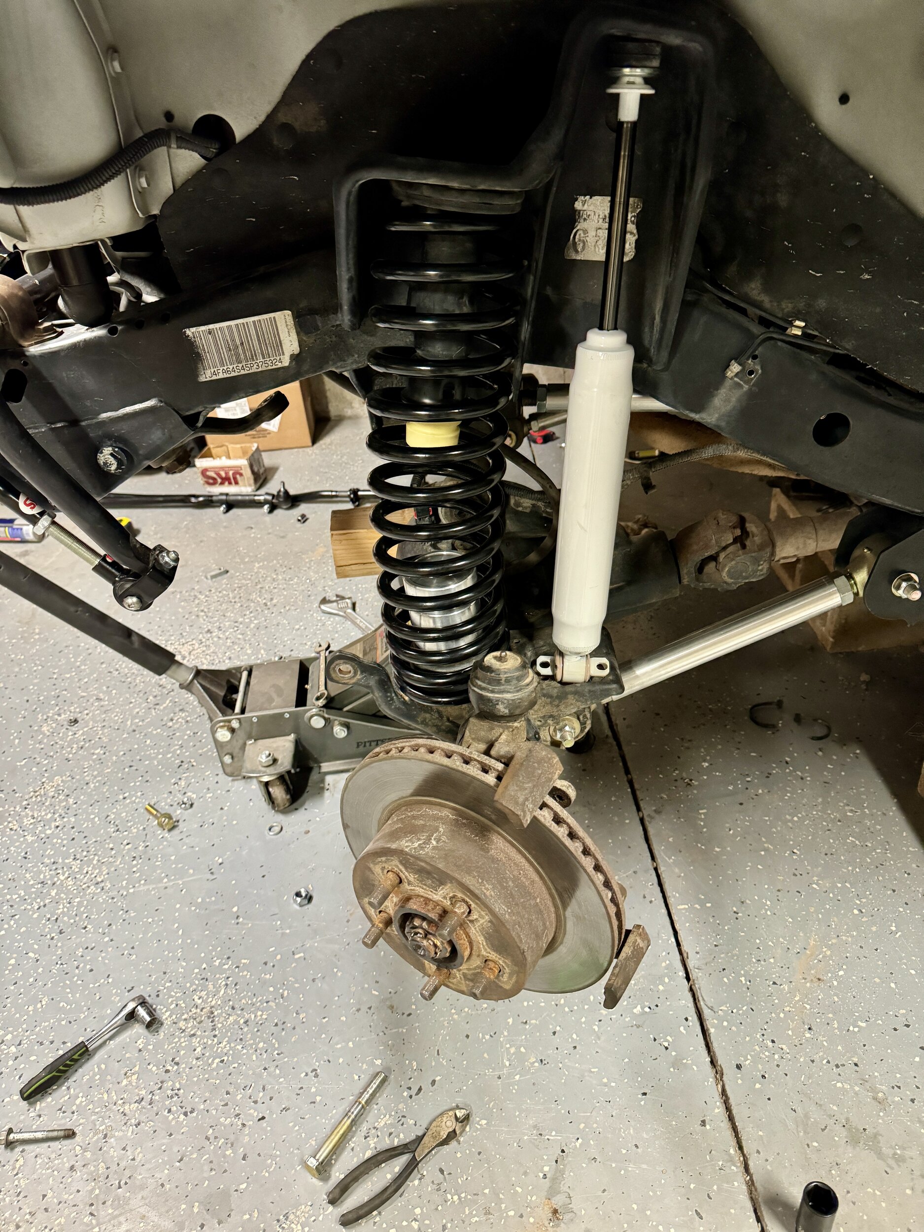

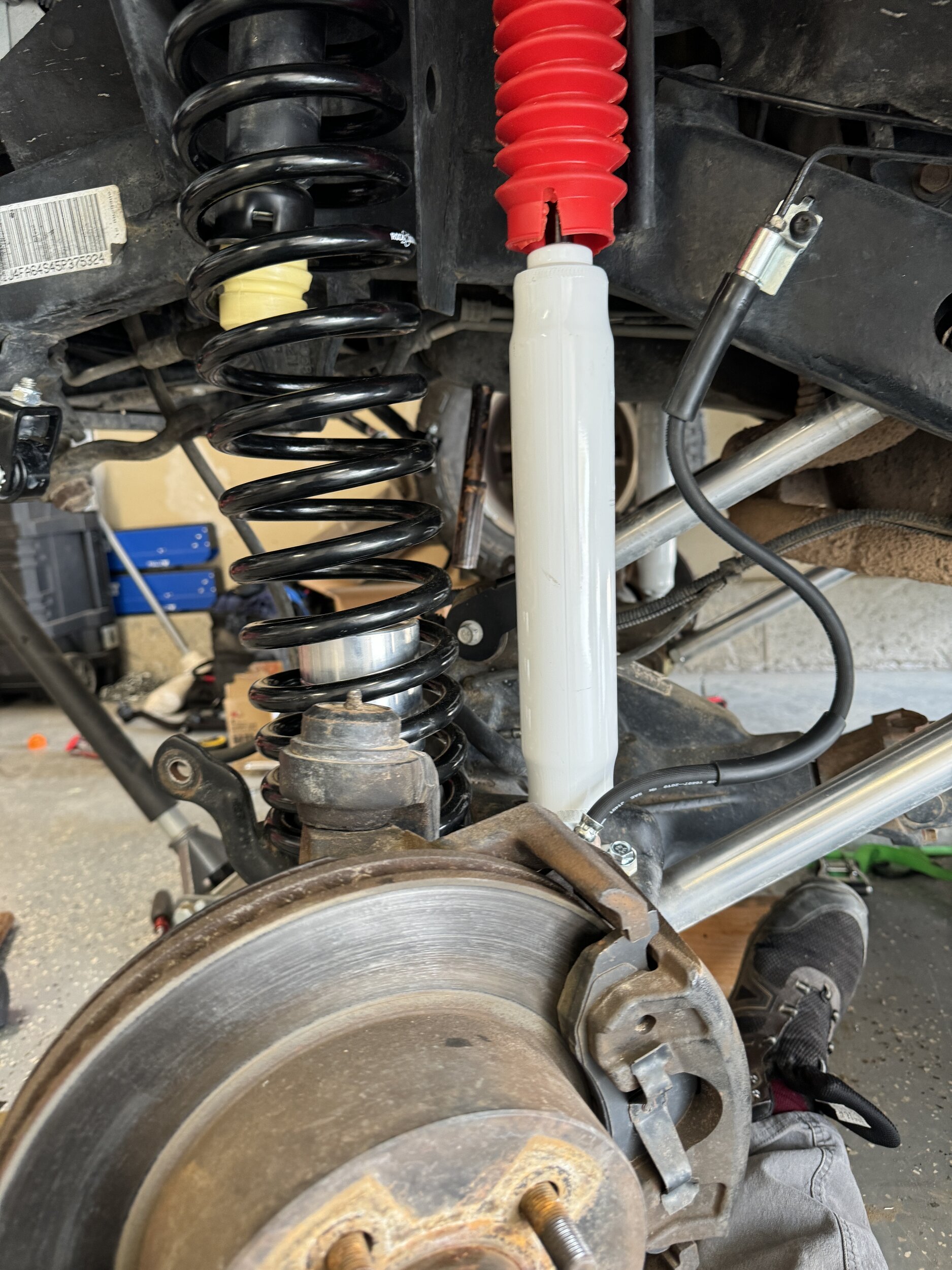

Got the lift installed, it took a little longer than I thought but it all went in eventually and didn't fall apart driving around today. Pretty interesting to see how it all goes together. Cycling the suspension was enlightening. I ended up figuring out that it came to me with a 4 inch Daystar lift. Replaced that with Currie 3" LJ springs, Rancho shocks, Savvy adjustable control arms, front track bar, and body lift, Moog ZJ tie rod, Crown drag link, JKS quick disconnect sway bar, extended brake lines. In the rear I just a have a bracket on the stock track bar for now, plan on upgrading it to the Savvy at some point. Also put in air bags for when we are loaded up for camping and have the bike rack on the back. Went from about 1 1/2" of up-travel in the front to a hair under 5", which was a substantial improvement in ride quality on roads with pot holes and prominent expansion joints. Tires are 33x10.5x15 Kenda Klever RT's in C load range.
Next up in the immediate future (like next weekend): valve cover gasket, OPDA, motor mount lift (went with aluminum blocks + factory style motor mounts), savvy transfer case cable, MORRyde tire carrier, new u-joints in driveshafts.

Congrats on the Jeep and lift install! Welcome to the support group! ;)
You may want to re-think/research the shock boots. General advice for TJs is they don't keep anything out and are more likely to keep you from seeing rust or damage to the shaft and/or a shock fluid leak. Food for thought.
Reactions: Rockymountainhigh5
Used to take them off of the dirt bikes for the same reason. I should have made the connection. Thanks!
