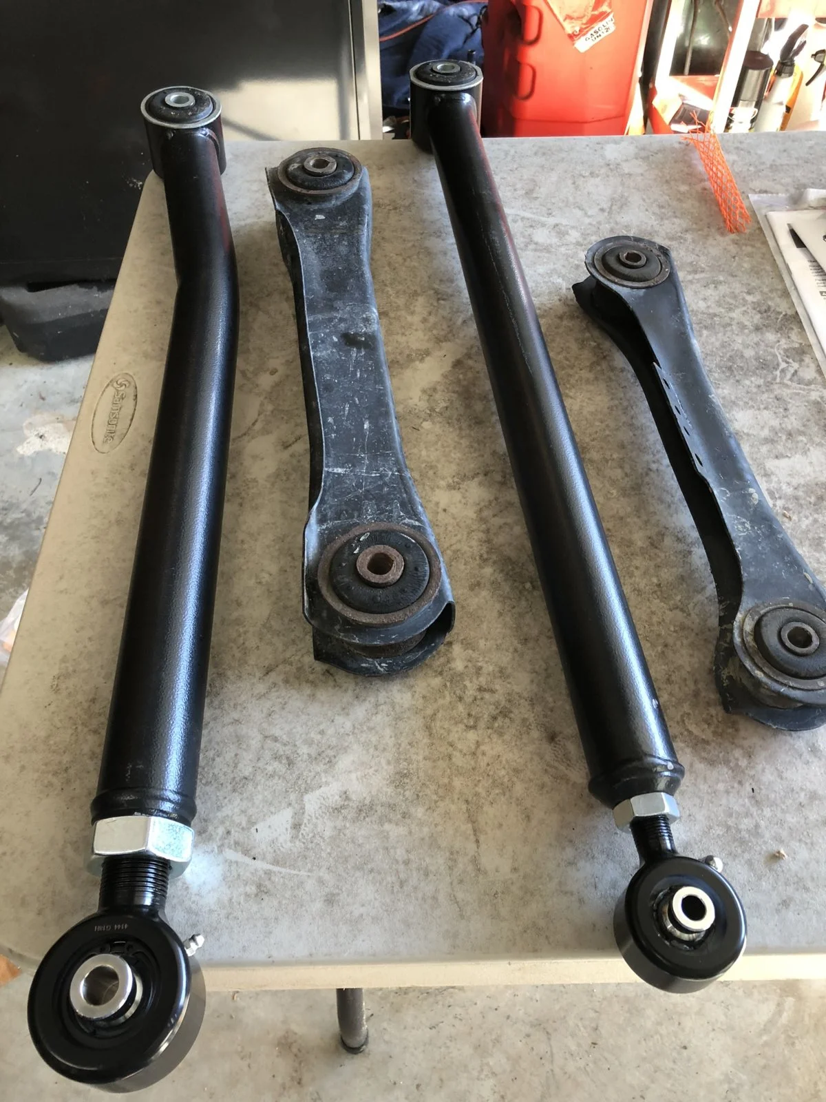

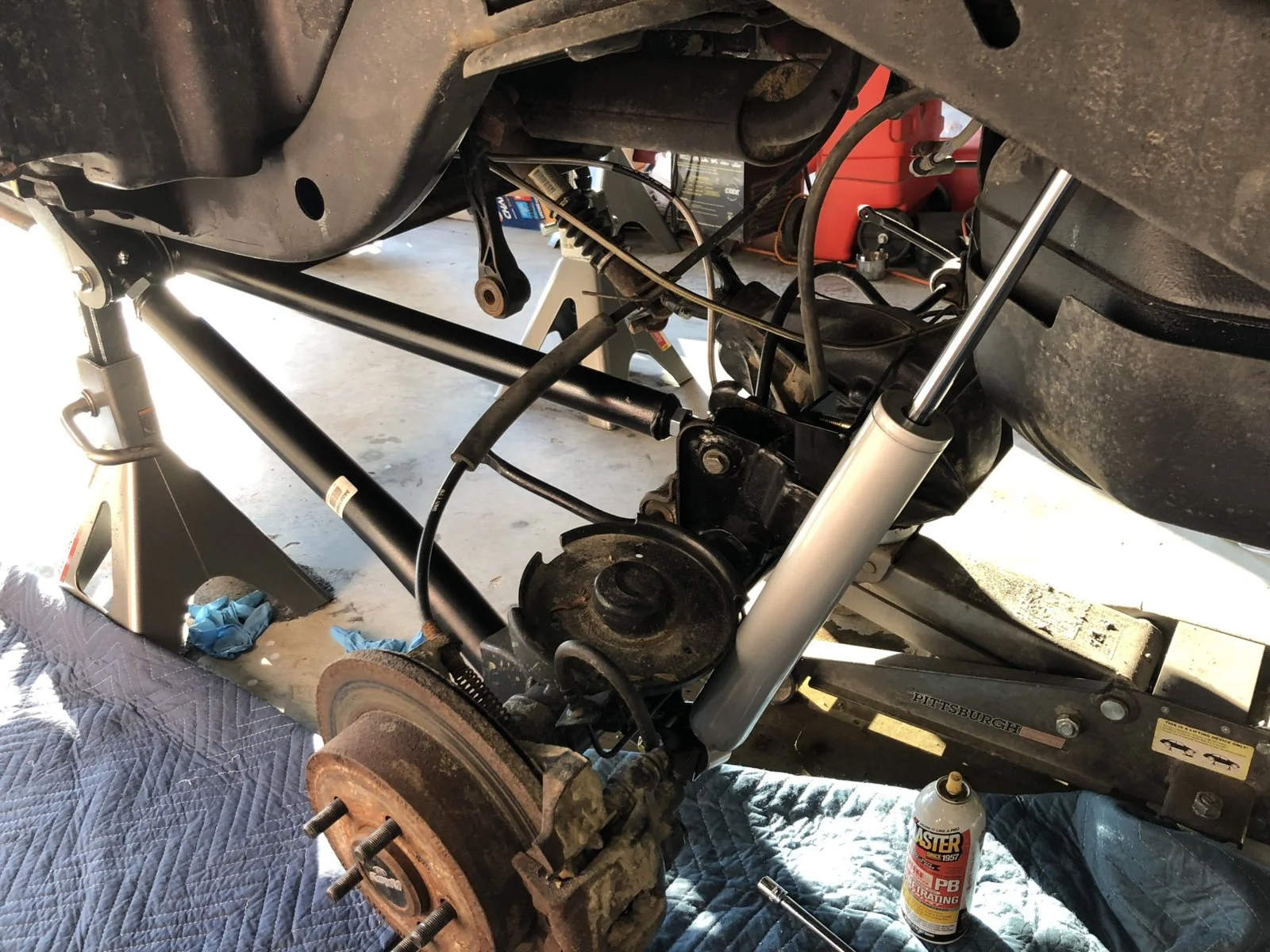

First, the instructions. They were very detailed but in my opinion, not very organized. I read them numerous times online before I even pulled the trigger on buying this kit. I approached this install by breaking it down into three parts. The front axle, the control arm section and the rear axle. I then chose to install the main control arms first. This served several functions. First, it allowed me to modify the skid plate, install the control arms and then have the jeep back together without the tranny having to be supported by a jack while I disassemble the front and/or rear suspension. The second thing it allowed was to be able to assemble the front control arms and attach them one side at a time to the front axle to help hold it in place. After I installed the control arms, I moved to the front of the jeep completed that axle and then moved to the rear axle. The entire install was straight forward and not overall not difficult. I did it all by myself using jack stands. Below are the few issues that were a little difficult.

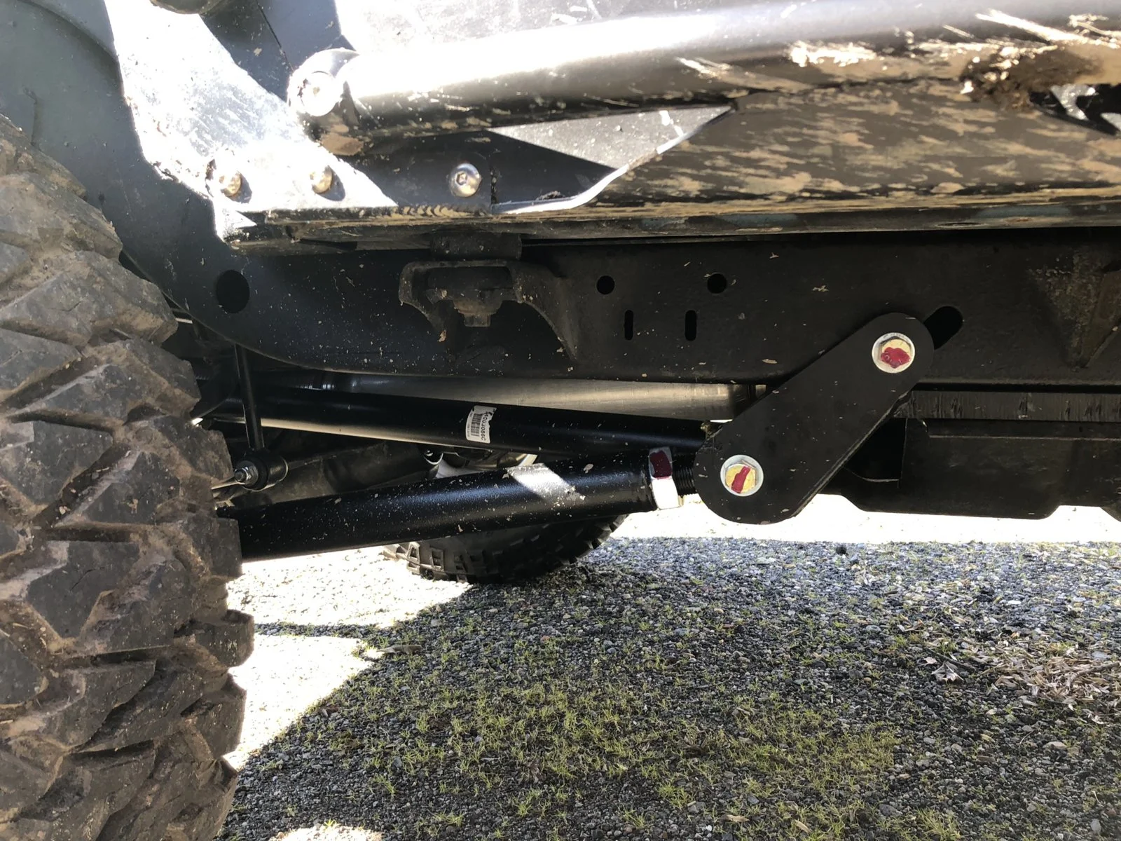

Drilling the holes through the frame. The control arm brackets utilize the factory skid plate bolt holes but holes must be drilled through the sides of the frame for four bolts. The hardest part about this is ensuring the inside frame hole is aligned horizontally with the outside. You do not have room under your jeep to drill these holes from the inside.

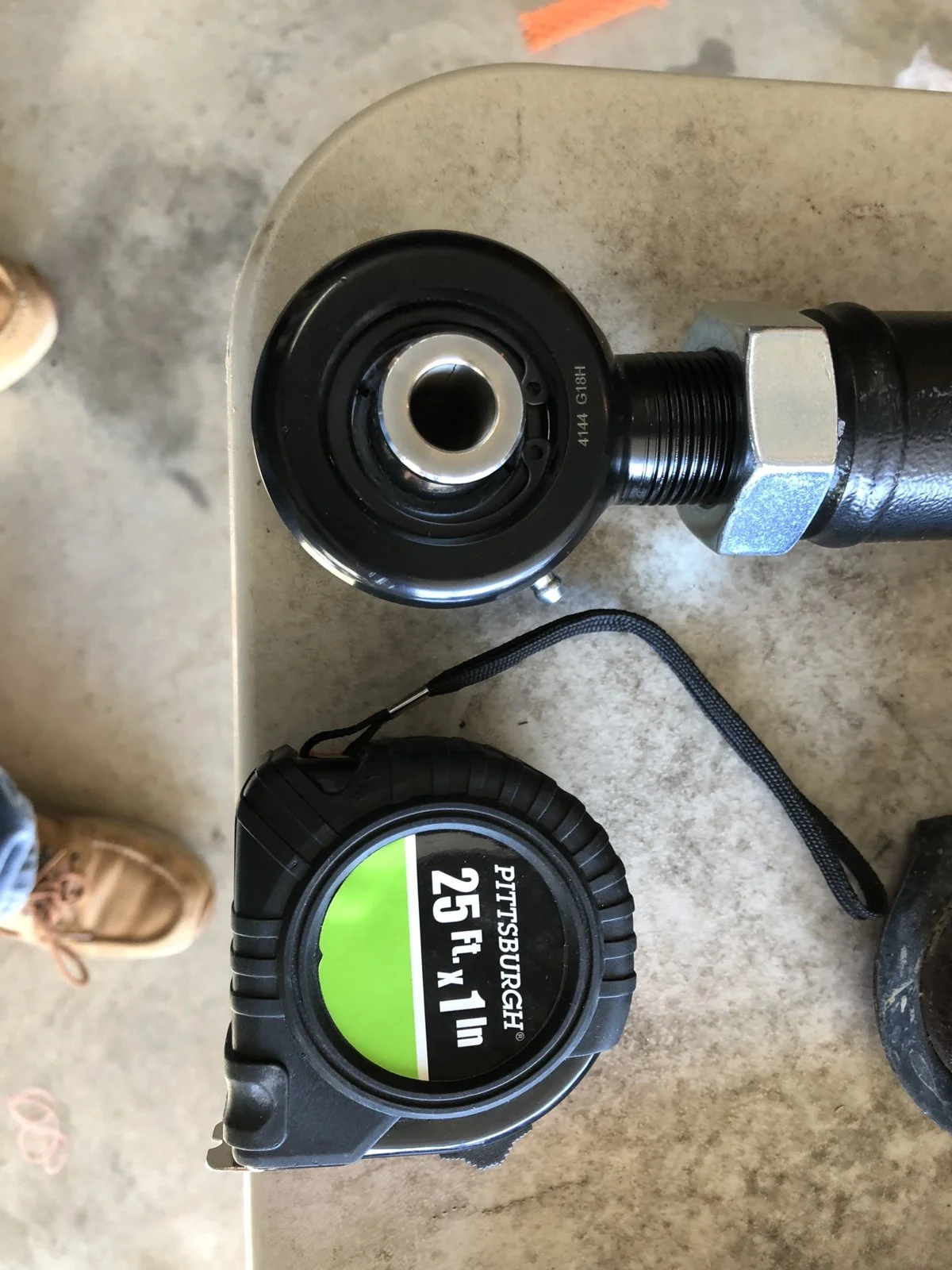

Product quality. As I stated above, everything was extremely heavy duty. The only parts, I really were not crazy about was the quick disconnects for the front sway bar. They were functional and did the job but were not easy to actually disconnect and seemed like they were in a bind when connected. I ended up replacing them with quick disconnects from another manufacturer.

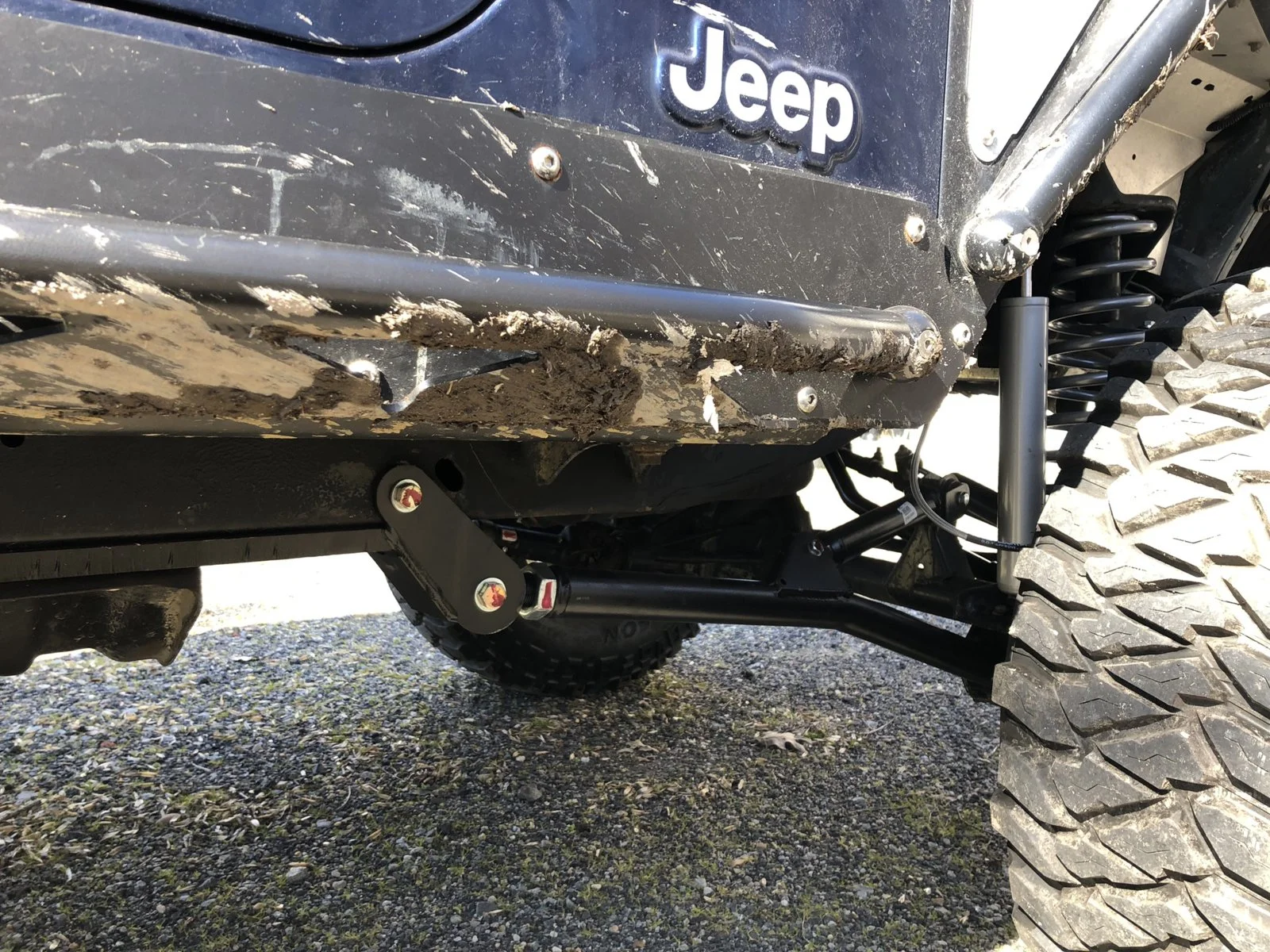

Ride quality. Second to none! I was worried to death I was going to have death wobble or my jeep drivability was going to be severely degraded. This was not the case. The jeep drives great and tracks well going down the road even at speeds greater than 60 MPH. Here are a few pics on the install.
