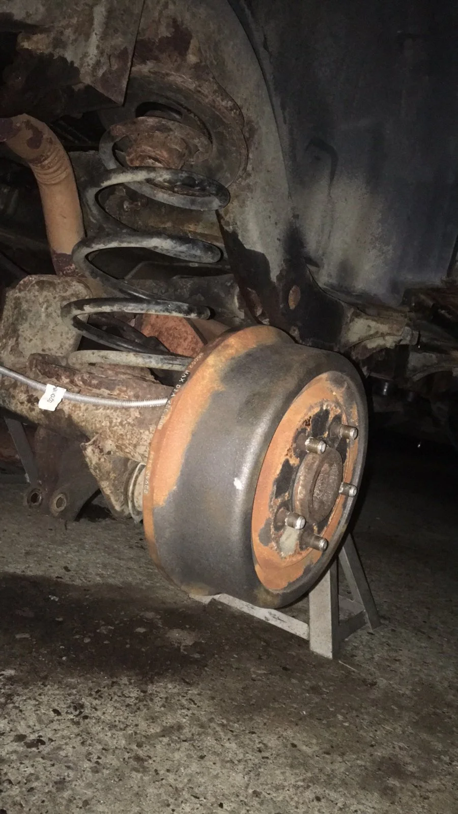

I have the jeep up on jack stands. The rear tires, shocks and sway bar links are completely off. The axel is hanging as far down as it possibly can. Any other suggestions?
