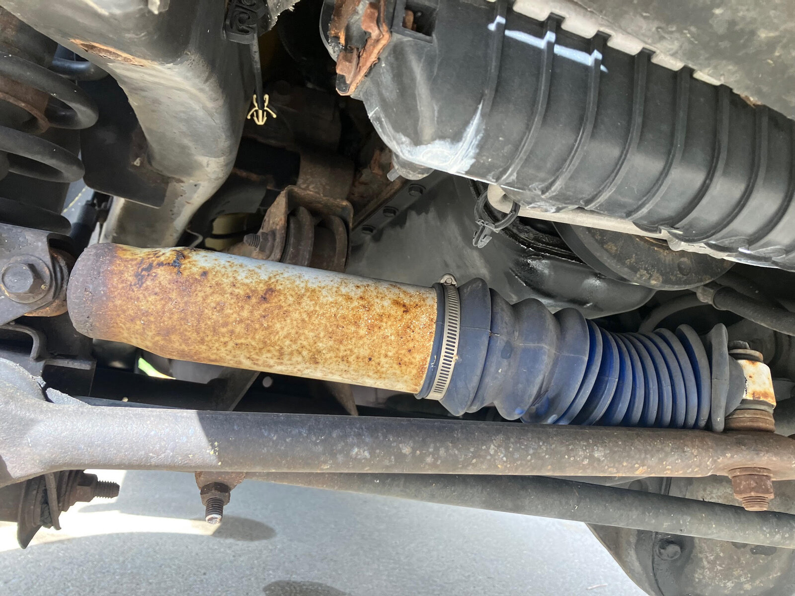

This is what is in there now. The rubber boot is shot and the case is rusted through.
Definitely time to replace that. I'd start soaking those nuts in some penatrating oil now just to make the job easier. There is no need for a boot. It will just collect dirt and water. I don't recall if the Monroe even comes with a boot. If it does just chuck it in the trash.

Definitely time to replace that. I'd start soaking those nuts in some penetrating oil now just to make the job easier. There is no need for a boot. It will just collect dirt and water. I don't recall if the Monroe even comes with a boot. If it does just chuck it in the trash.
