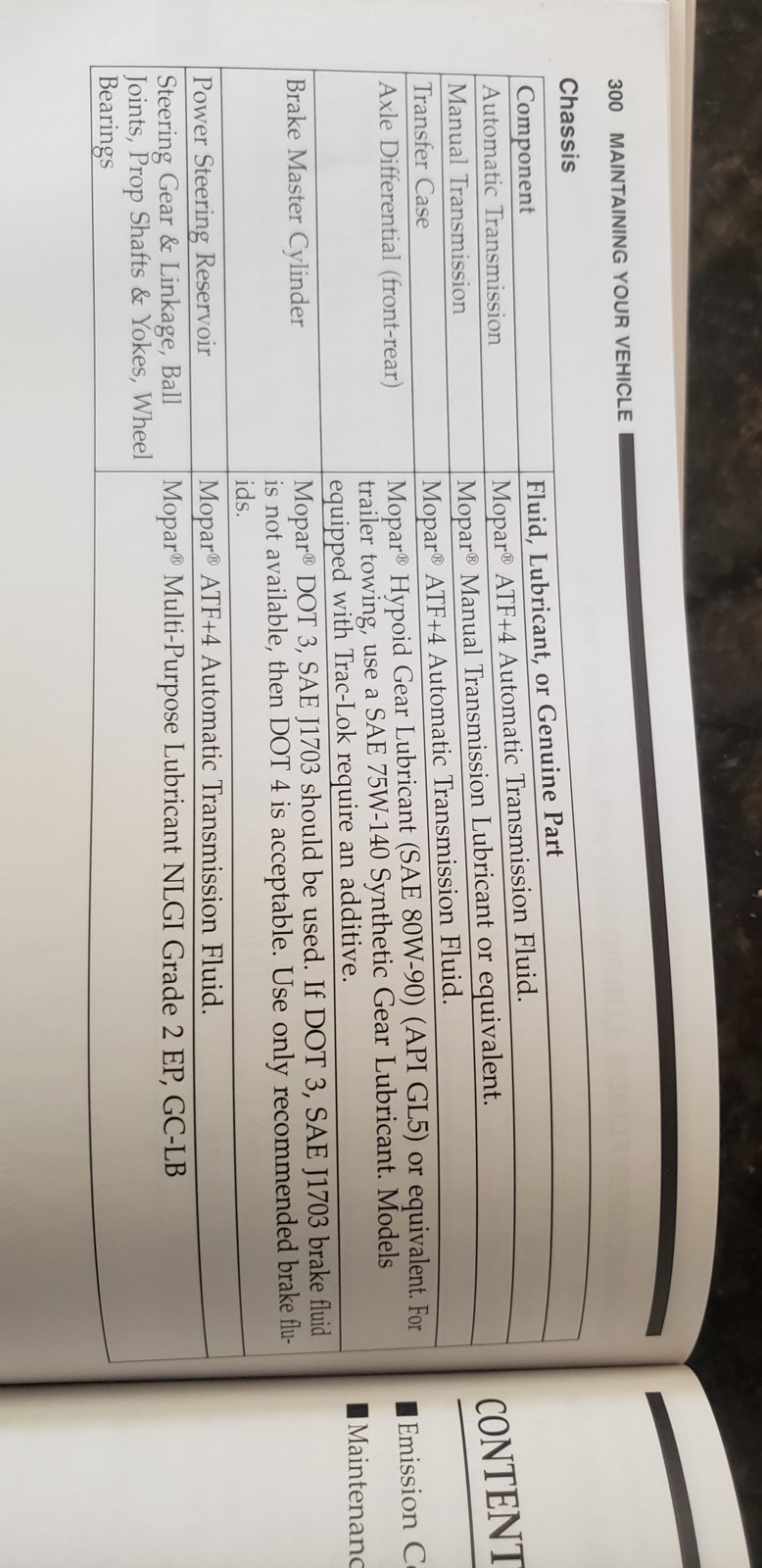

From my 2005 owners manual
78143
Would that be similar to the earlier post where it was mentioned that factory tolerances are so good that synthetic is not a problem... For example a factory engine could use synthetic but something rebuilt in a guys garage might need to have conventional oil start with?
I can't say, factory tolerances vary enough that I'd wouldn't even venture a guess. Engine rebuilders have their own views on lubricants to use during break in.... as do axle builders and ring & pinion gear providers. :)
Cool, just trying to think conceptually .

So what brand conventional diff oil is the best to go with? What is Trulock axle? Does a Rubicon require additive?
A Rubicon does not require any additive .... most modern oils have enough additive for the ones that do.
correction Trac-Lok
Any major brand is fine. I use Valvoline myself but I'd just as happily use NAPA, Torco, Mobil, Castrol, Shell, Pennzoil, etc. or even Walmart's brand. Today's major brand gear lubes are all very good quality.
Your Tracloc limited slip differential does require an additive which is a friction modifier. But 99.9% of all the gear lubes on the store shelves already contain that additive so you don't need to buy and add it separately. You can verify if the GL-5 gear lube you're looking at has the additive by what it says on the back label. If the back label says something like "Compatible with limited slip differentials", that confirms it already contains the required additive.... don't add more. Most gear lubes contain it since that additive is fully compatible with all automotive axles.
Most of the gear oils on the shelves here in Honolulu are NOT compatible with limited slip differentials. Only a select few have the additive, despite most being rated GL-5. Probably because everything here is already expensive so most people want the cheapest option. Just a hunch...
However, the Rubcon has True-Loc (not Trac-loc). Trac-loc is a limited lip differential, True-loc is a true mechanical lock. The manual mentions both because the manual is not specific to the Rubicon.
