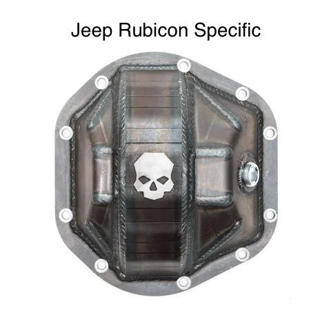

Also completely unnecessary for a Rubicon, as the factory drain plug is in the housing, not the cover...
I’m sure they still make their TJ Rubicon specific Dana 44 cover. It shares the same low profile design for steering and track bar clearances and it lacked the drain plug, since the TJ/LJ Rubi axle has one drilled and tapped in the housing.
