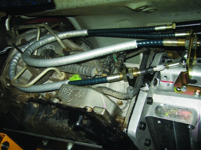

Here is a good pic of how the two shifter cables need to be routed. Look at it carefully.
If you need any other advice, you can PM me directly. I've installed two of these.

This is helpful information. The most difficult task for me was installing the cables. The instructions weren't very useful here!

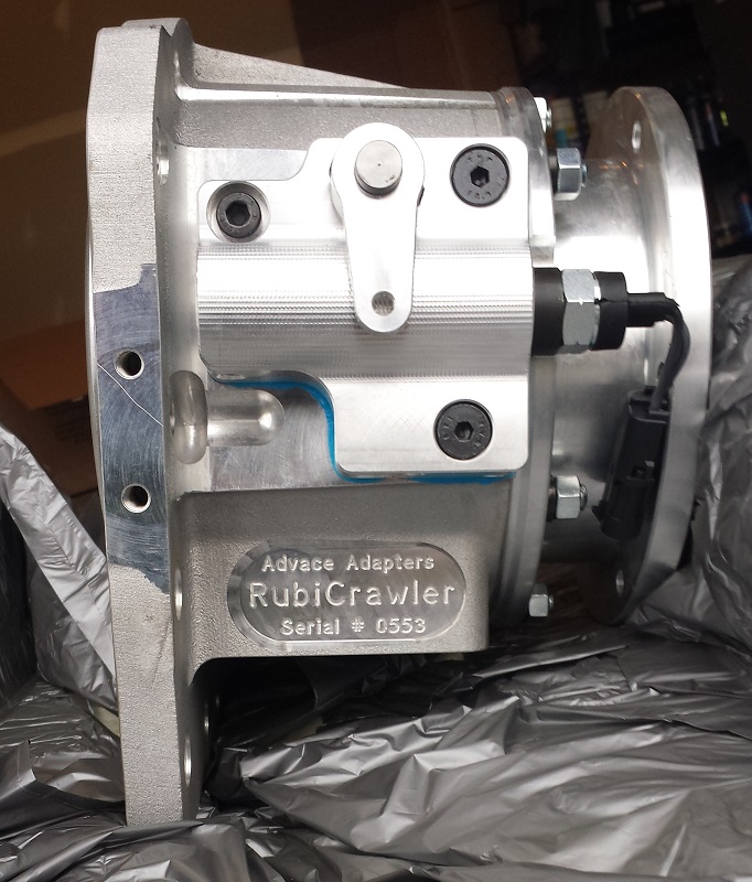

Not to hijack the thread, but I'm wondering if anyone else with a RubiCrawler had this small screw up from Advance Adapters. They're great engineers, but apparently correct spelling is not a requirement. That's the hint, so what's wrong with this picture?
LoL, that’s hilarious. Mine is getting ready to go in soon. I’ll take a look.
