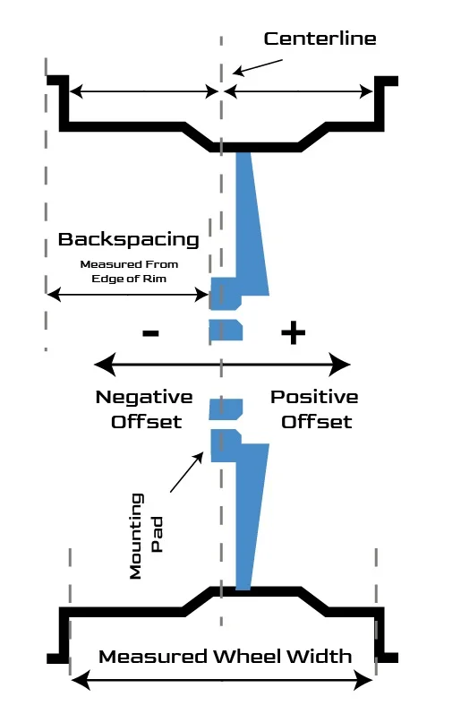

Keep in mind that any adapter will change three things:
- back spacing, the distance between the wheel mounting surface and inside of the wheel lip, based on the thickness of the spacer
- offset, the distance from the wheel mounting surface and wheel centerline, will also be impacted in the same manner and
- scrub radius, the distance between king pin (steering) axis and the tire centerline
The ultimate impact, without the correct wheel, will be a wheel/tire that sticks out to far and puts excessive load on existing components
The calculator below can help you plug numbers in, so you know where you stand
