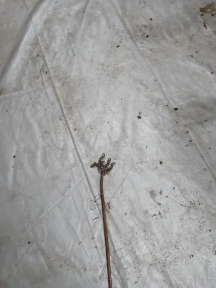

Made up a chain flail out of a 4' section of plumbers snake and some small steel chain twisted in. Really slams the frame internals at 500 rpm's.
