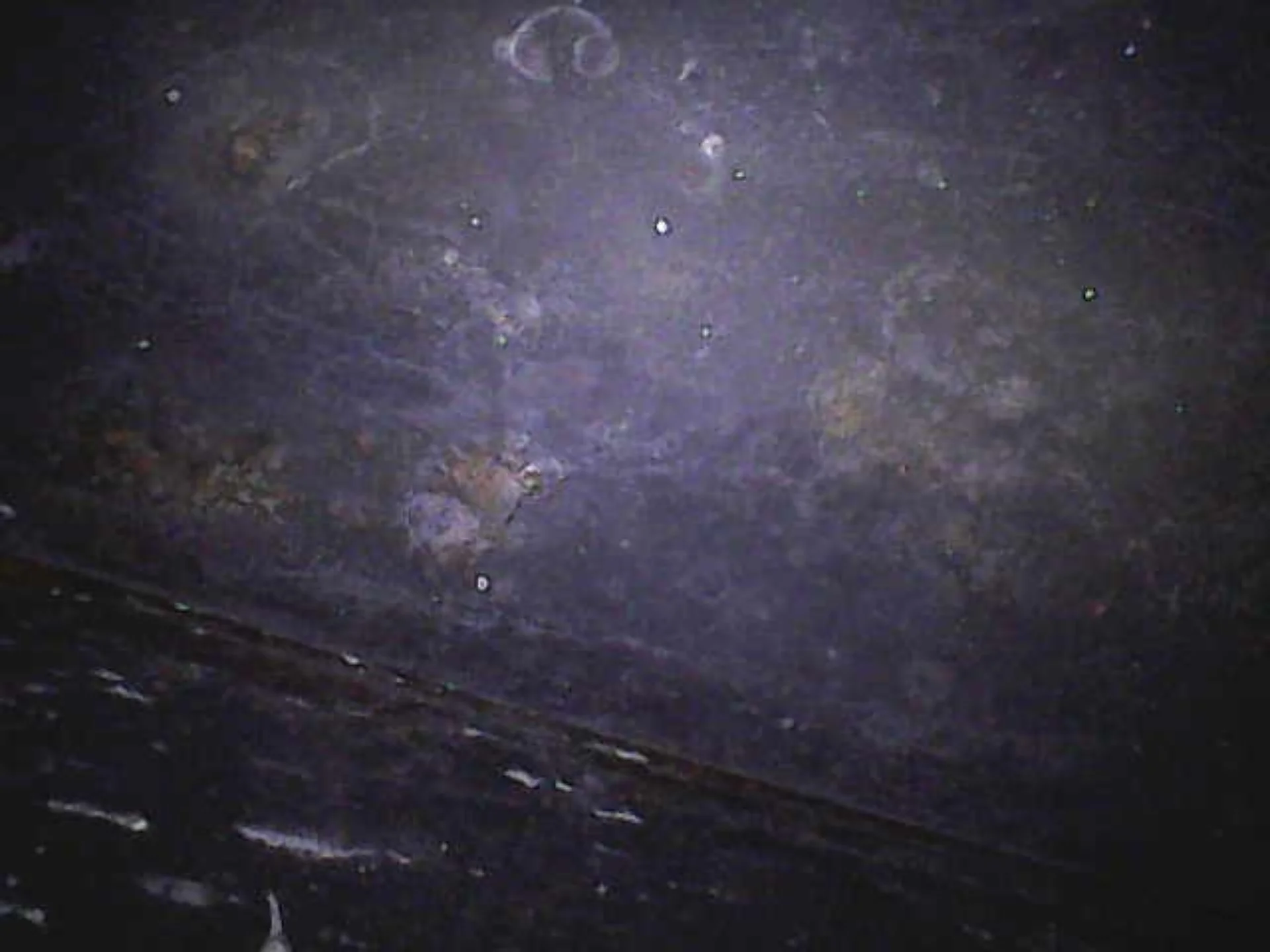

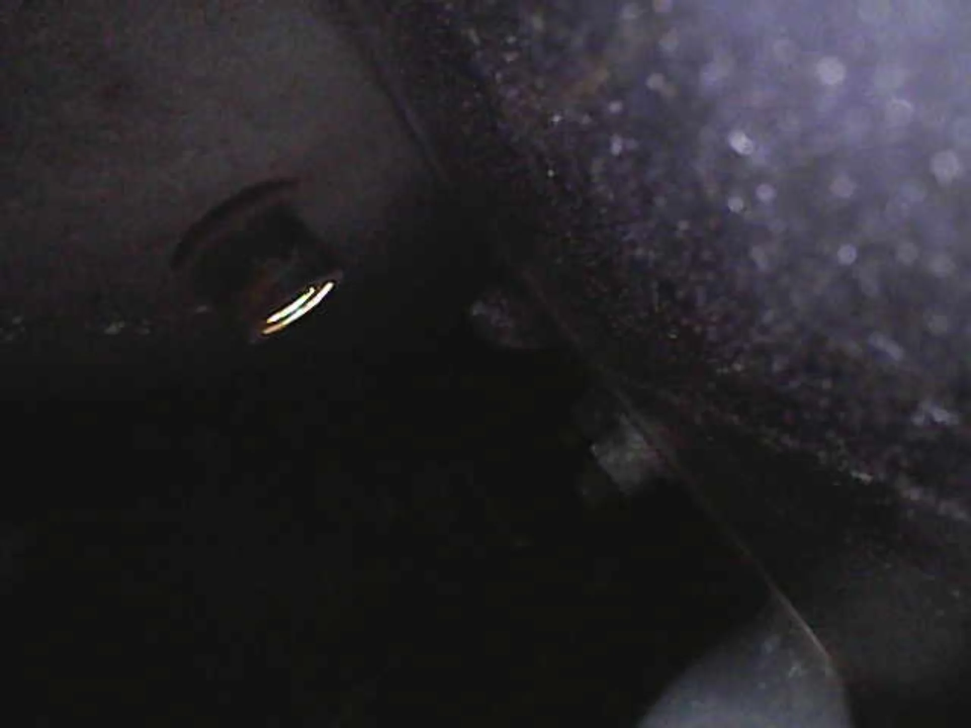

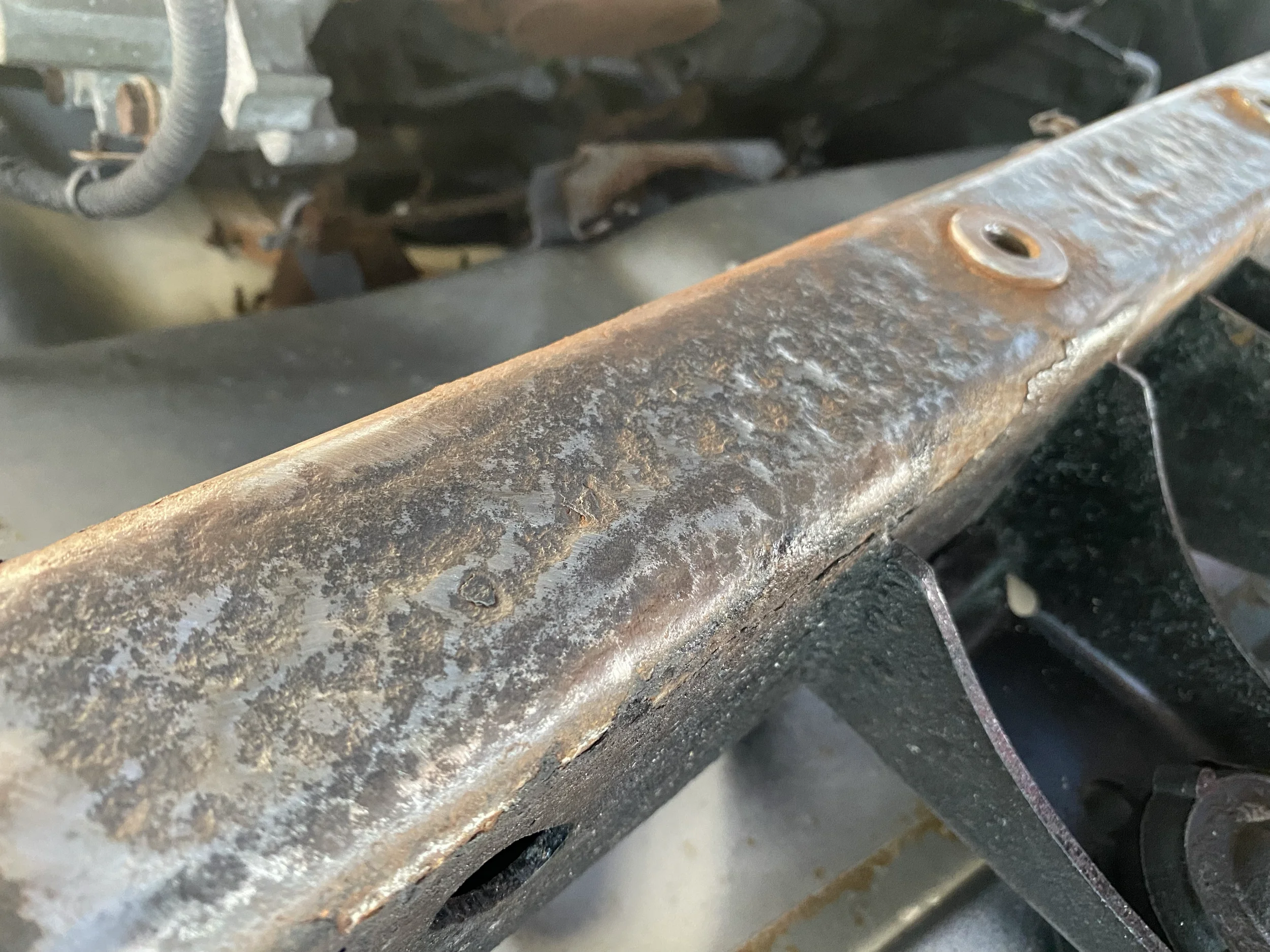

Looking for some advice on this frame that I own. I pulled the skid plate off and noticed a decent amount of rust/pitting. I am in the process of fully cleaning the rust off (first pic). The inside looks clean and smooth throughout (used an endoscope camera) with just some very light surface spots (second pic). The rest of the frame is pretty clean and smooth.
What would be the best course of action to remediate / fix as best as possible?

The inside shot looks like it is the inside sidewall of the frame. What does the inside bottom of the frame look/feel like? That's where the rot will start. Have you looked inside just below the control arm brackets?
Reactions: TheBoogieman
There's a couple of spots in that lower frame picture that look like a not real hard hit with an average sized hammer may let you see inside the frame.
Safety caps or something similar is what you'll probably need.
I'd use a BFH and pound the bottom everywhere from the rear crossmember to the front spring mounts and hope that what we're looking at right now is the only area needing attention.

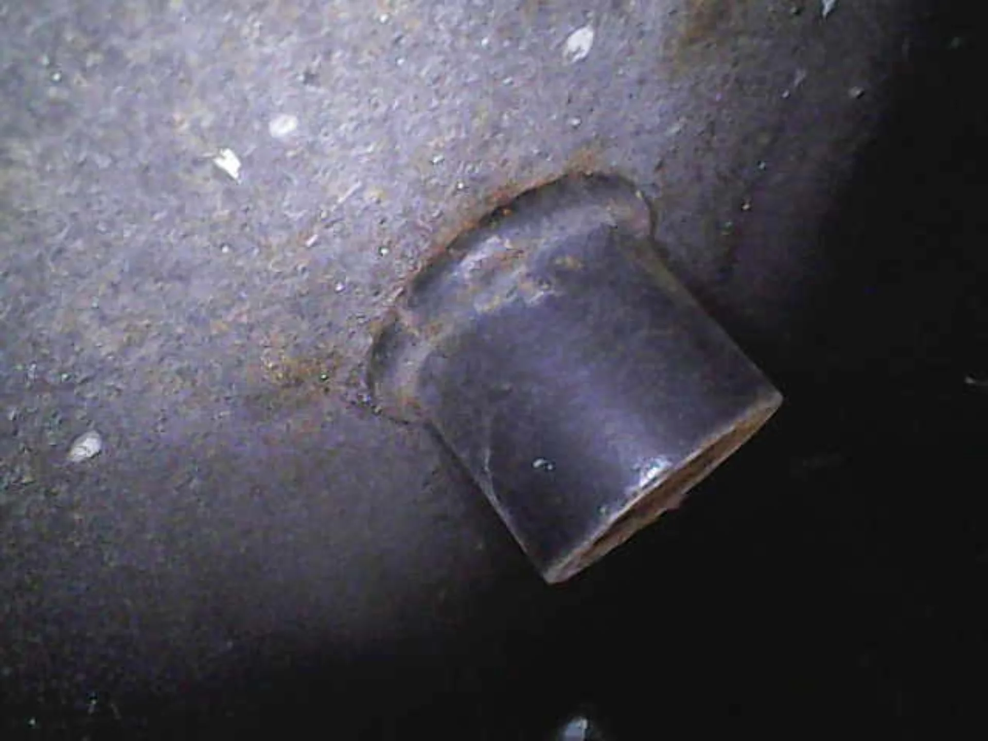

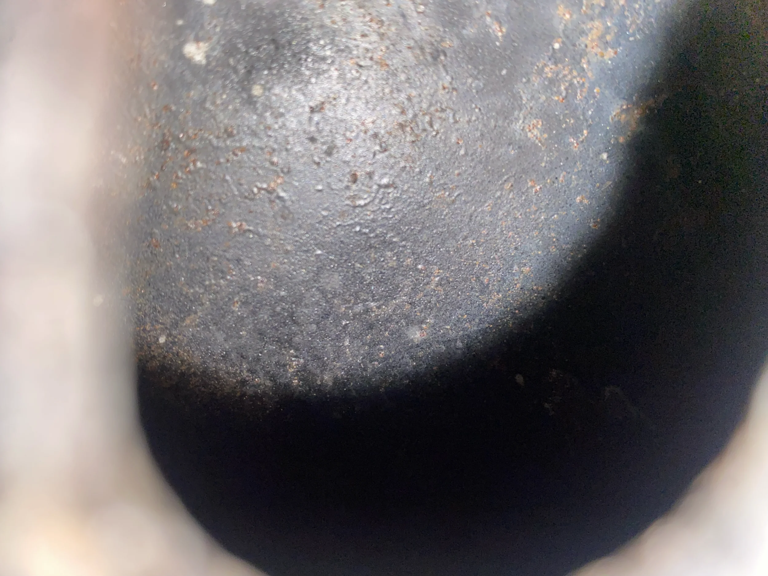

@Rcroane Here are the best shots I can get with the camera I have of the inside bottom.
@JEEPCJTJ I took a 3 lb mini sledge to it with a decent pop, nothing crazy as I don't wanna bend the metal but it sounded pretty solid and "metal like" sound
with no holes or weak spots opening up. Not sure if I should hit harder

That does look pretty darn clean. What are your plans for keeping it that way? Eastwood's? Fluid Film? Both?
Edit: Just watched the video.....the sound is "softer" on the section you are hitting at the beginning of the video vs. a more distinctive metal sound at the other end.
