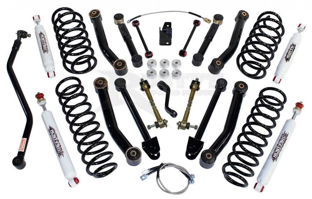

Looking at this lift for my 06 tj rubicon and would like to know if I need to add anything? Are the drive shafts long enough? I like the kit and will upgrade the shocks to fox or blistein…….maybe something else...https://www.rustysoffroad.com/jeep-suspension/jeep-suspension-lift-kits/tj-lj-wrangler-rubicon-unlimited-97-06-jeep-suspension-lift-kits/rustys-tj-lj-wrangler-4-5-advanced-kit.html
Or should I do a 3 inch kit. I want to run 35. Thanks for your time.
Rusty's is bottom of the barrel. Keep shopping. Zone, old man Emu, currie/savvy
Rusty’s is not a brand good enough, in my personal opinion, to even make it to the bottom of the barrel.

Lets see, the shocks are surely junk, the fixed control arms aren't buying anything over the factory arms, and are probably worse. The dropped pitman arm is dumb and unnecessary, I probably wouldn't trust the track bar, and miscellaneous hardware is of unknown quality. Maybe the springs or ok, maybe. This kit isn't cheap either, pass for sure.

If you don't need adjustable arms, just get factory style replacements. I ordered a couple of Moog factory style lower front control arms yesterday, because my originals are beat up around the bushing area.

For 35's you need 5" of additional clearance which is, in many opinions including mine, best done with a 4" suspension lift plus a 1-1.25" body lift.

I didn't even notice you said you wanted to run 35's until Jerry's post above. So even if the Rusty's kit didn't suck, 4.5" seems not to be quite enough lift. I don't like body lifts, but a 4" suspension lift plus body lift is probably the best way to go.
