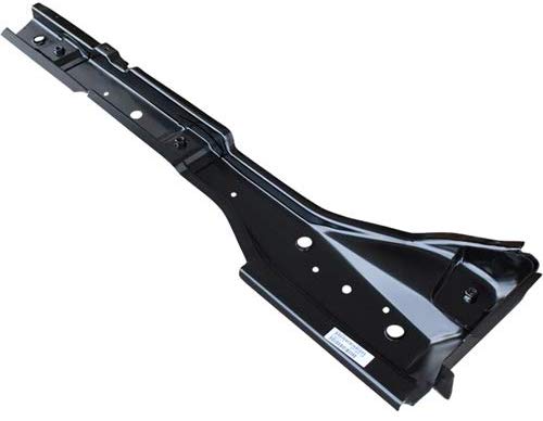

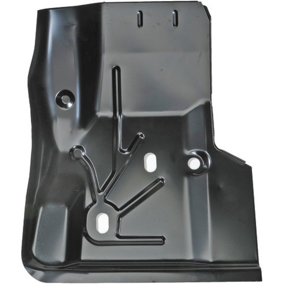

View attachment 119200View attachment 119201
The parts are readily available through multiple suppliers, but everything the others have said is true. It's just not a job for the faint of heart. ;)
Can I ask what the bottom picture part is called.
I already have a new floor pan (to be installed by a welder friend at some point soon). I'm wondering if I should order that bottom part too, and take care of all the issues while he's down there cutting and welding.
**Noticed the pics I quoted are not showing for me. I'm referring to the pics Squatch posted. The top one is the floor pan. I do not know what the name of the bottom pic is.
That's one of the torque boxes. That one is a full torque box. They also sell a partial torque box, if I recall, as it's more common to only have the skinnier section rust out.
