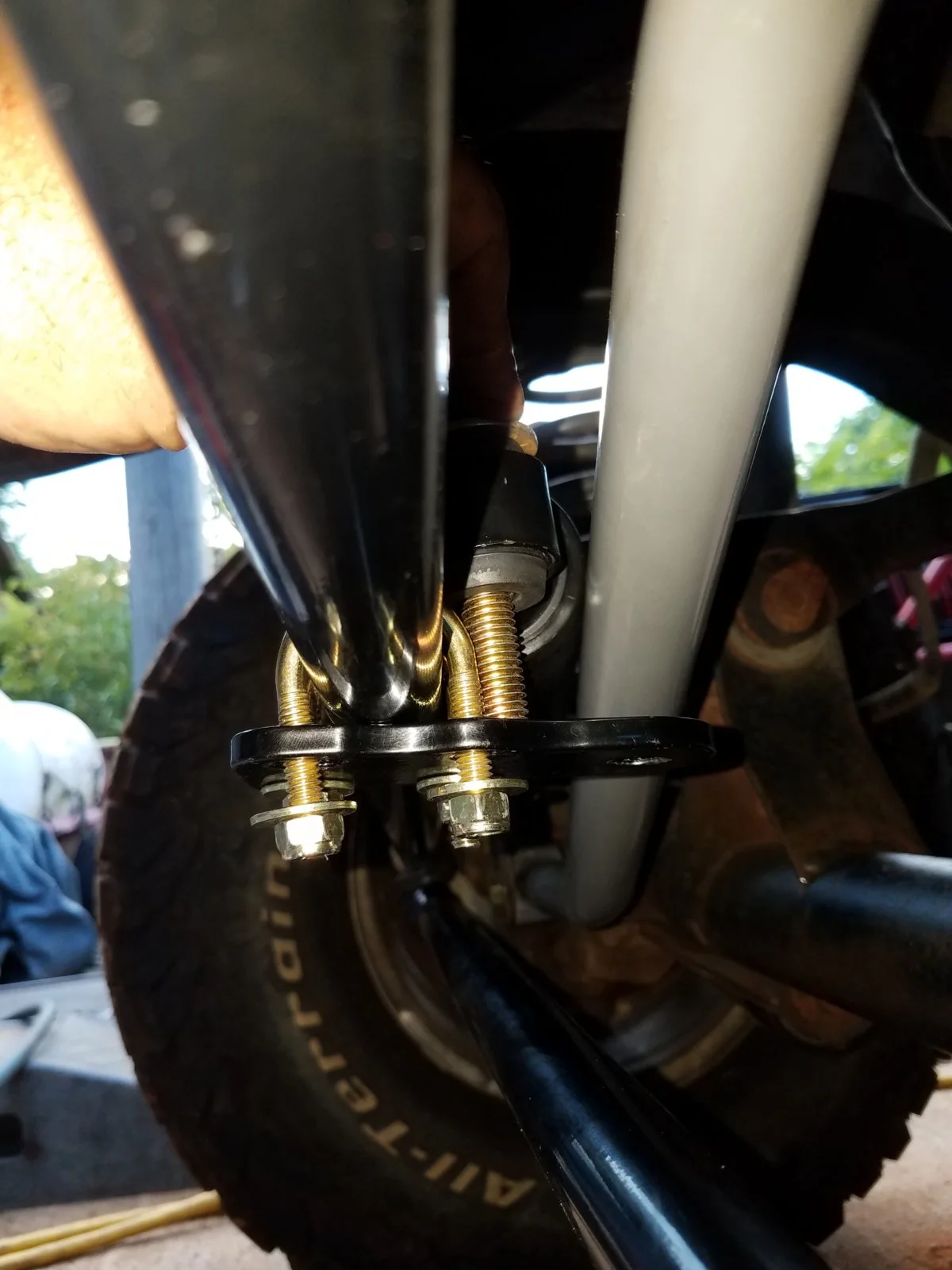

Installed the Rusty's kit and everything seemed to be going fine until I come to the stabilizer. I can not make it work with the existing hardware. I checked Rusty's site, they show the stabilizer installed on the rear of the drag link (as per the included instructions). As you an clearly see in the mockup below, there is no room for the stabilizer to fit between the track bar and the drag link and the mounting hole is below the track bar. This is exactly how they show it fastened. That bolt hanging down is supposed to go in the hole in the bracket thats under the track bar.The one on Rusty's site shows a stabilizer without any protective sleeve, but the Teraflex sleeve is not removable and even if it was the mounting hardware is placing it under the RE track bar.

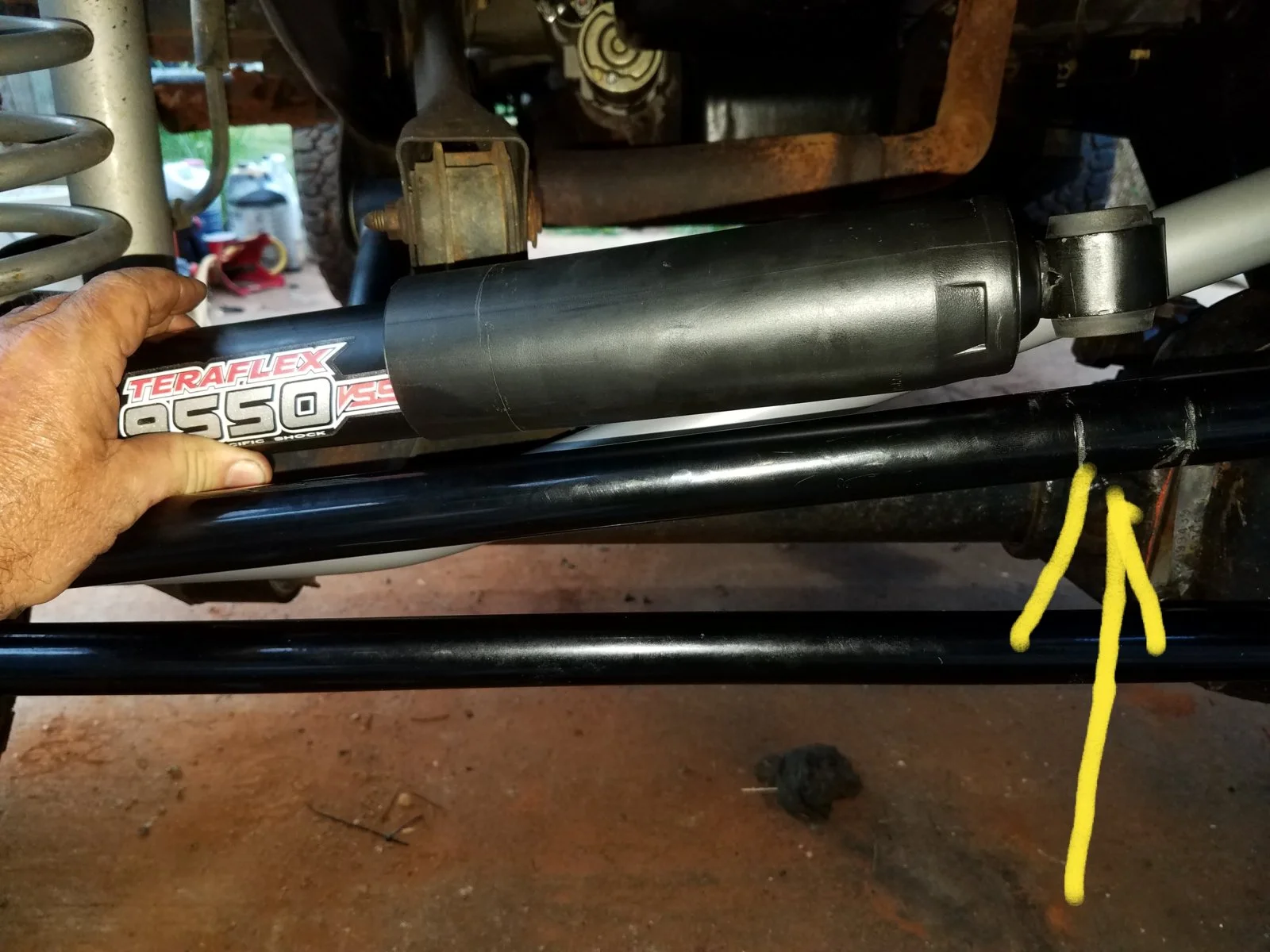

The only way I can possibly see it working is to fabricate a bracket to mount the stabilizer on TOP of the drag link. As seen in the next photo, that seems to place it parallel to the drag link and the stabilizer doesnt seem to be in a bind, although I have not tried to mount it to see if it will travel as it should:

All you should have to do to fix this is play around with different mounting angles for the stabilizer. I had to do this with my steering stabilizer when I put on my Currie Currectlync steering. I fussed around with it for 20 minutes before I finally found the way to mount it where it wouldn't interfere. I'm positive you can get it mounted correctly, but I think I need to see a photo taken a little further away to see what we're dealing with in terms of where everything is at.
I have no doubt it should fit just fine though if you play with it enough. Mine was the same way!

Thank you Chris. I sat and looked at it and messed with it some more, I believe it will work attached to the top of the drag link, that's where the stabilizer naturally wants to land. I think I can modify the bracket that came with the kit. I will post a pic of it when I finish if it works.
Make the bracket verticle then twist the shock rod till shock bolt is horizontal and it should work.
Good to hear! I had a hell of a time with mine until I sat around playing with it for an hour. There's so many different ways you can mount it, you just have to find a position in which nothing contacts. Once I got that figured out, it was like, "Oh, that was actually pretty easy!".
Just one of those things you have to play with, almost like a puzzle.
