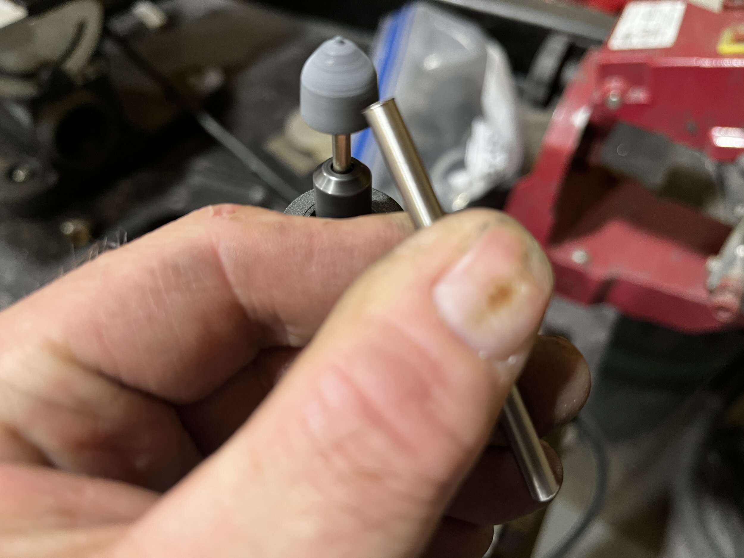

Next, I profiled a rotary stone to deburr the ID (this will have to be done frequently when making all my brake lines, as the stone takes a beating from the stainless line):
I deburred the OD first, and then the ID, using the stonel:

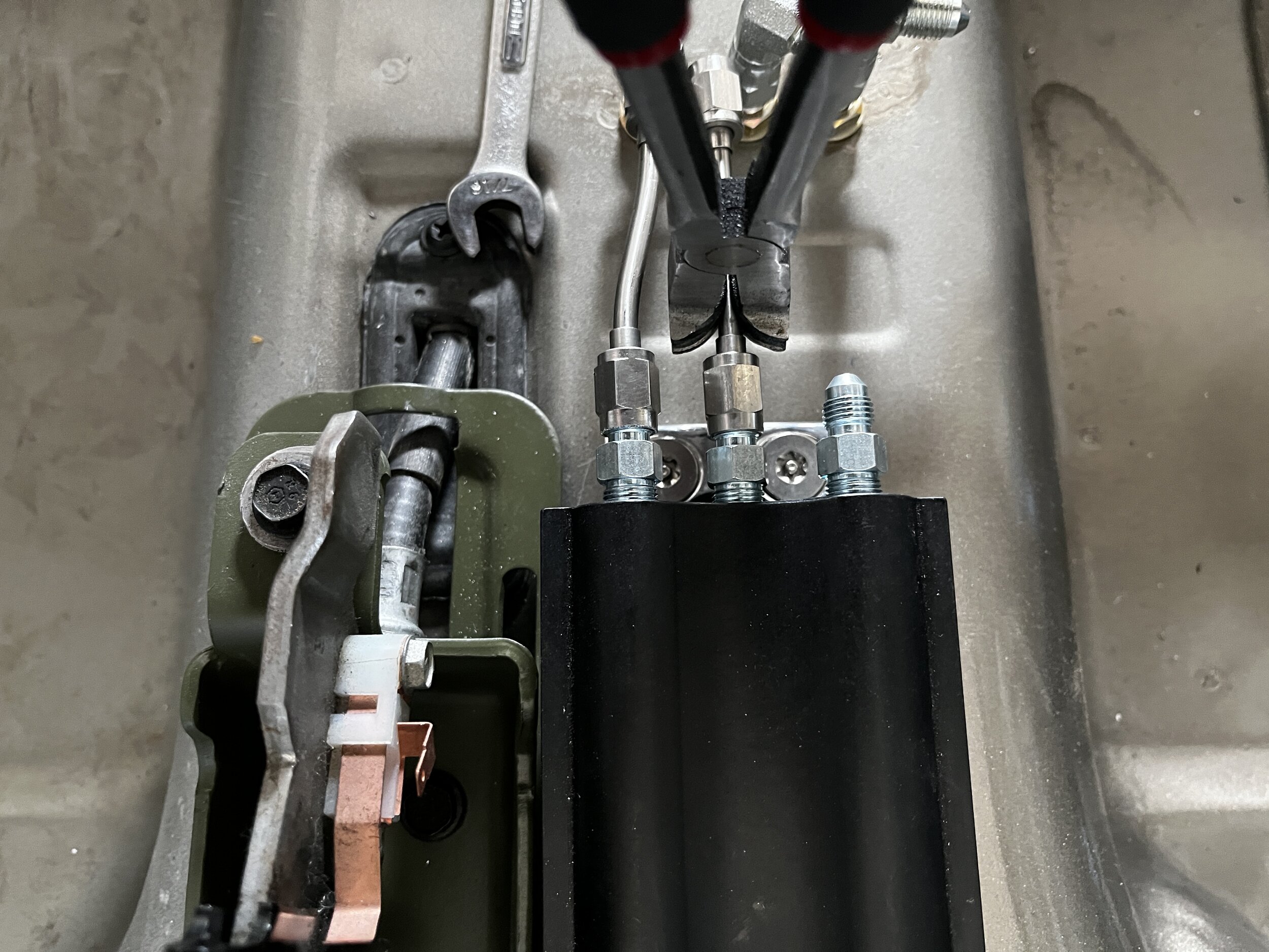

Lastly, I used the Fragola pressure test kit to test the first one, and no leaks! Woo hoo - success! With that success, I made the other two lines, tested them successfully, and installed all three of them. The lines had to have small bends in them to line up, so I used Lisle 44150 tube-bending pliers to great effect:
And done:
