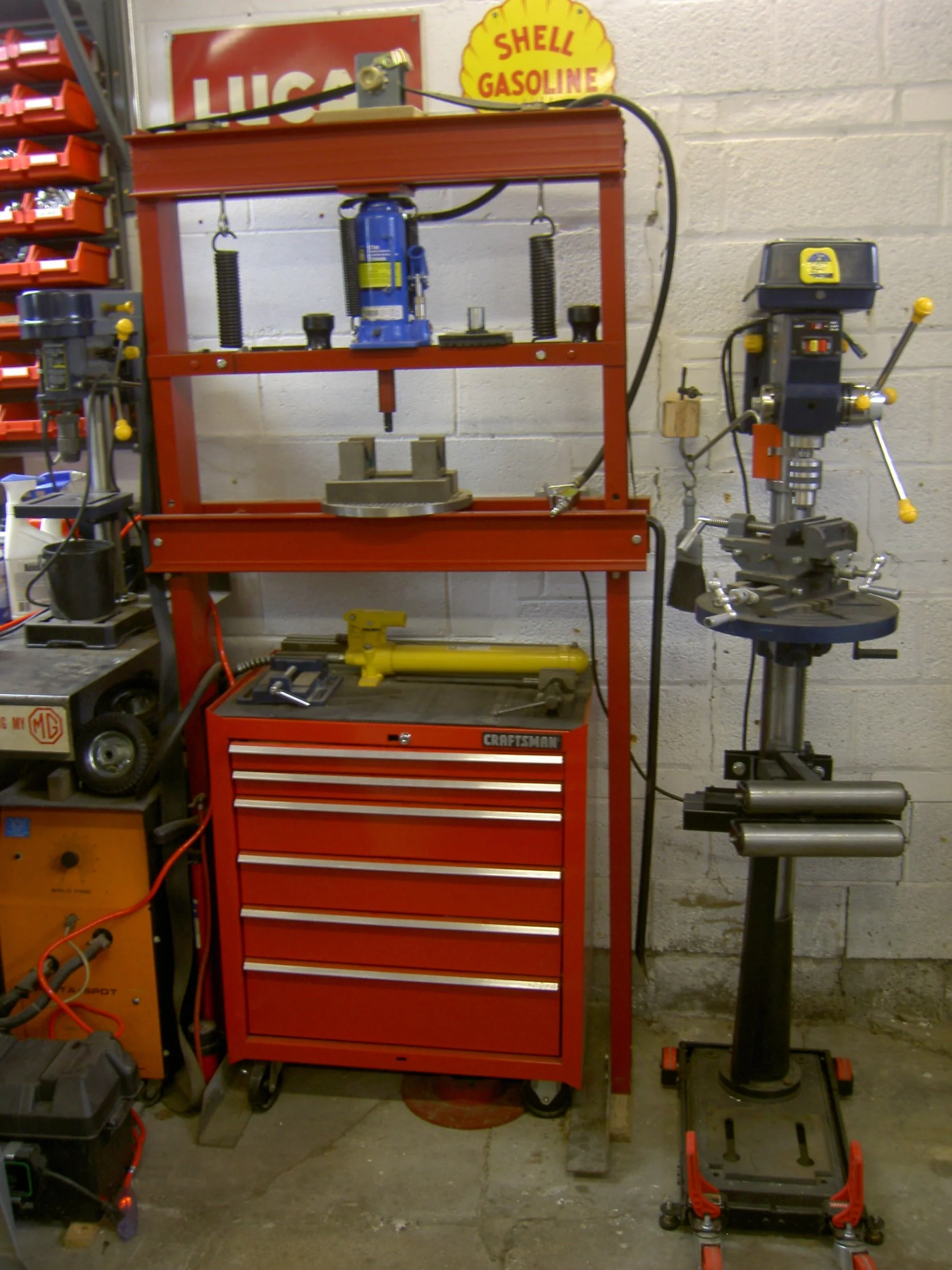

I built my own back in the mid 70s and it's still going strong. It's a bit wider than some as I wanted to put a tool box under it for storing press and drilling tools.

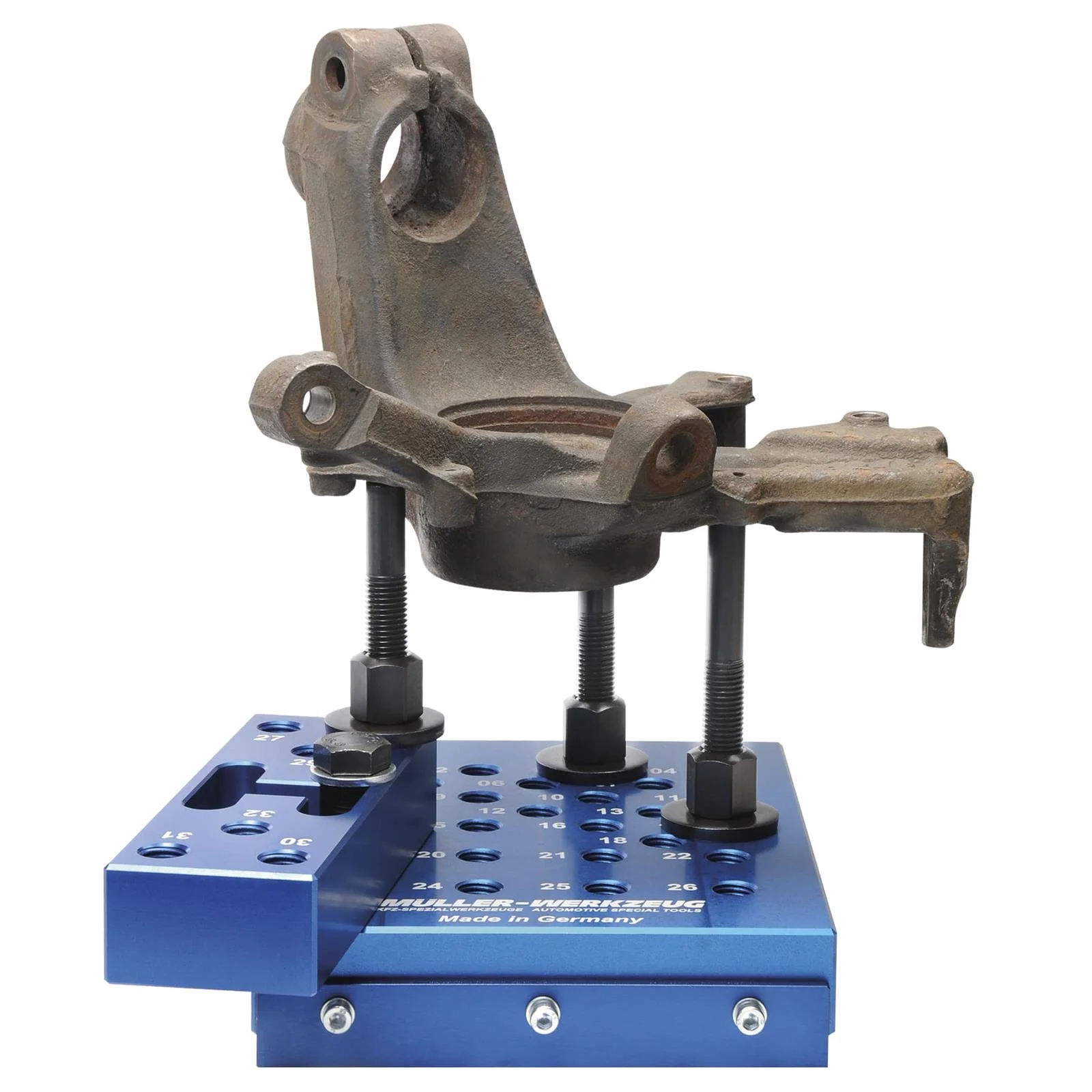

One other suggestion. If you are going to use the press to change wheel bearings on newer front-wheel-drive front spindles, get one of these "Universal Press Supports" for your press:
This is the only way I have been able to do these wheel bearings due to the odd shape of the spindle. Until I bought one of these, I had to take the spindles to a shop and pay shop rates to get them to change them. The one shown is (I think) the original German-made support, and it's very expensive (about $500). There are cheaper (about $100) copies available these days, which is what I bought. It paid for itself the first time I changed wheel bearings (I've used it about three times now). Just search for "Universal Press Support."
