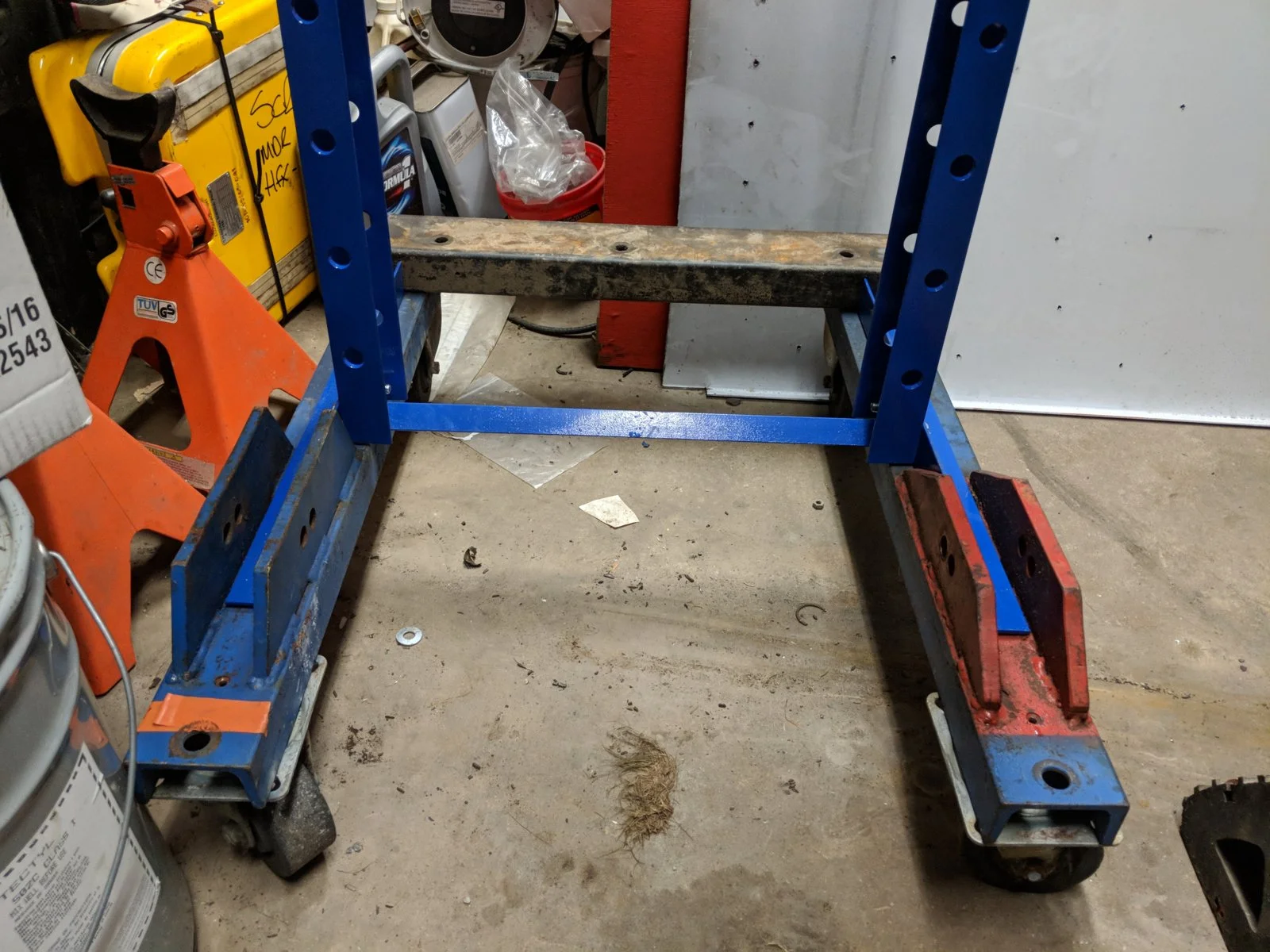

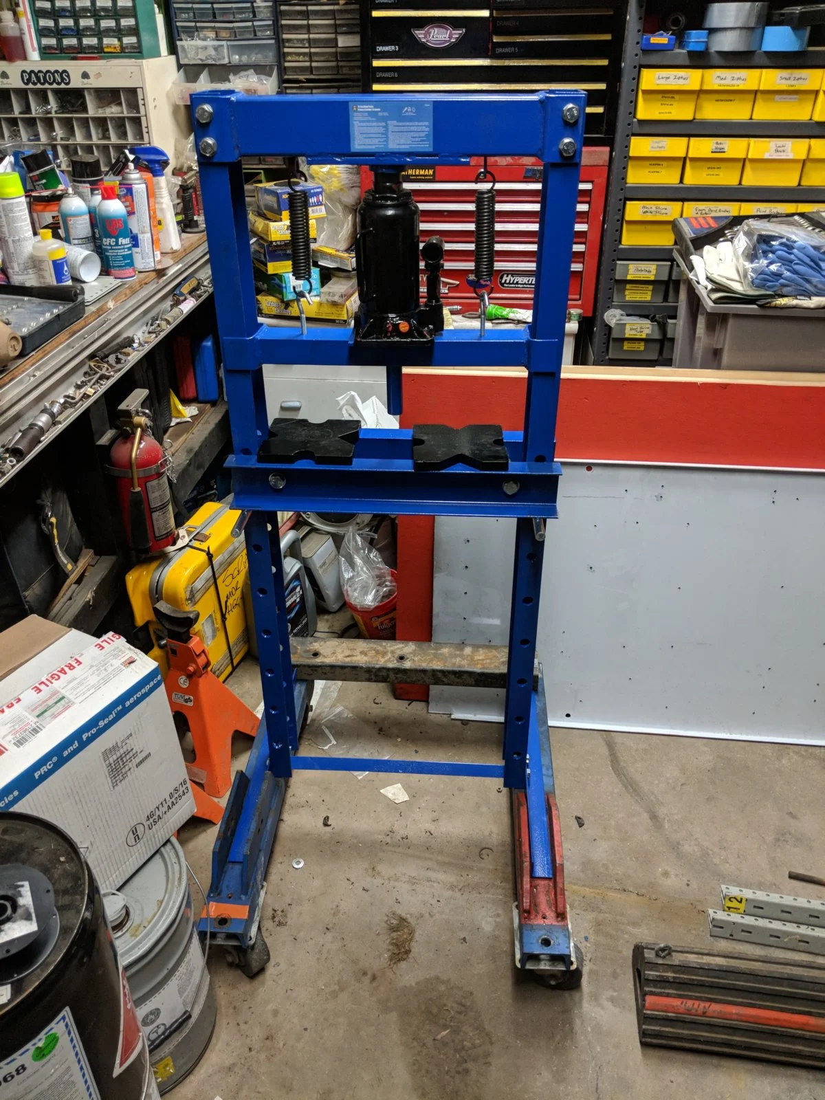

I picked up the press today, and it is pretty damn short! I threw together a base with wheels from some scrap I had which raised it up 7", but with me being 6'4", it could definitely be higher, lol.
Derekmac. If those black press plates are harbor freight cast pieces, please protect yourself when using them.
The first time we used them with a buddies 20ton model we broke one due to porosity in the casting. Scared the crap out of us but at least we had no shrapnel flying about.
He found some 1” steel plate at a scrap dealer and paid to have the necessary cut outs done with a water jet.
YRMV.

I did ask the question before buying it, and was told they were steel. Is it easy to tell looking at them what they are?

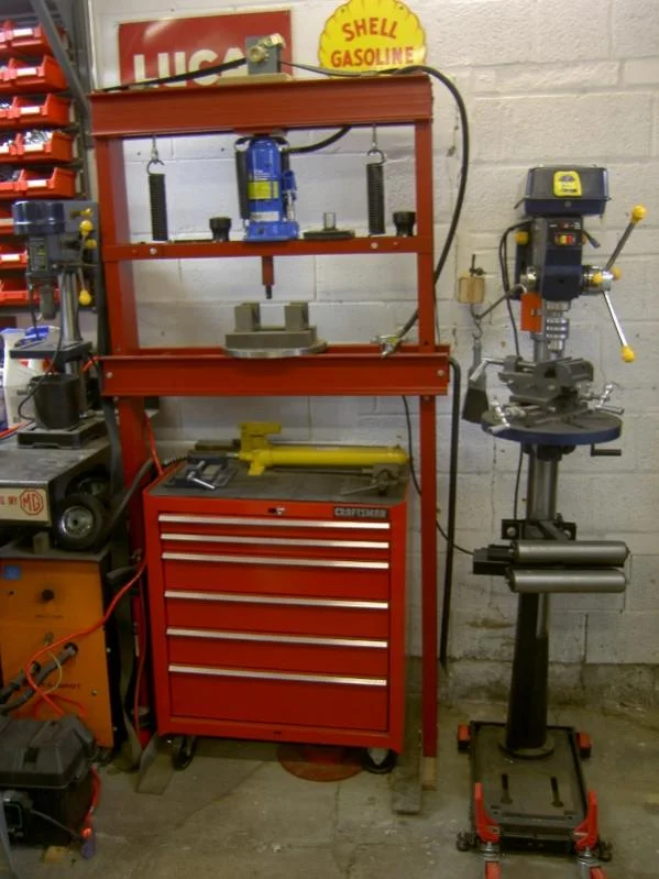

I made my own 20 ton shop press years ago and it's still going strong. To save space I made it wide enough to accept a standard 27" wide roller cabinet underneath. The drawers are full of press and drill tools for the adjacent drill press.
