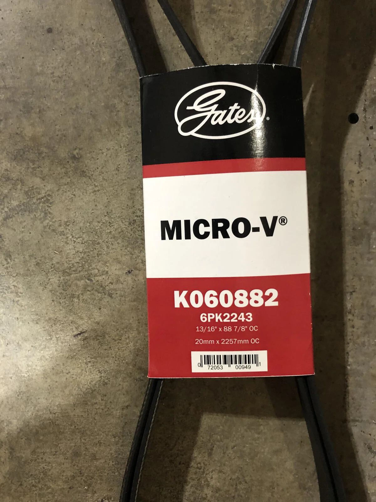

Replaced the serpentine belt on my 02 Wrangler, 4.0 with A/C last night. Took about 10 minutes and started the Jeep up and everything works fine. No noise from the belt. Installed a Gates Micro-V K060882 (6PK2243) 88 7/8 OC. This belt is referenced for the 02 Jeep.
My question: the tension on the belt does not seem all that tight. I know that Jerry and others have talked about the thumb test for deflection at the longest span of the belt. I'd say I can push the belt at least an inch. Since there is no real adjustment with the 02 tensioner, any ideas?
Has anyone else encountered this issue? Does anyone run a certain belt they like that has the right amount of tension?

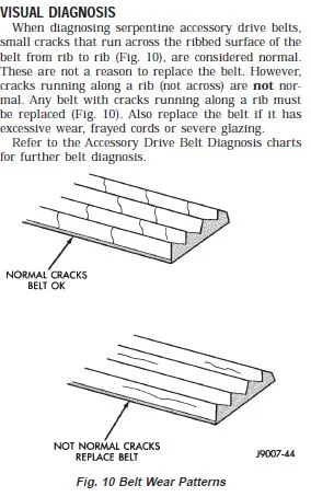

One thing to know about cracks in the belt indicating a problem. Cracks that go across the belt, from side to side, are normal and can happen shortly after installation. It's cracks that run length-wise that indicate it's close to failing.
Reactions: pagrey and DrDmoney
Jerry,
That's very helpful. I thought any cracking was a sign that a belt needed to be replaced. Appreciate the clarification.
