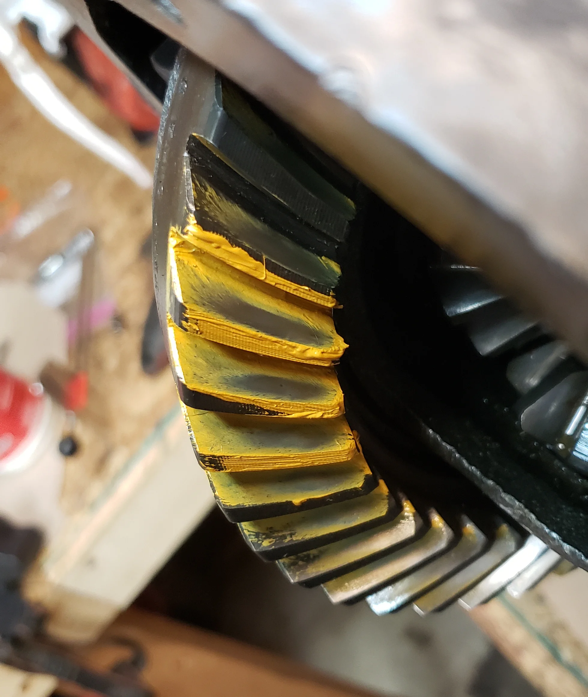

For what it might be worth, here are the patterns I have ran already... I did coast, then drive, and during drive a faint second pattern was made on the coast side. But looking at the original coast pattern alone (and even drive side), it looks like pinion depth is OK, now need to get proper shims to jam the carrier in place and set backlash right (measuring .006" but those loose shims are unacceptable to me)

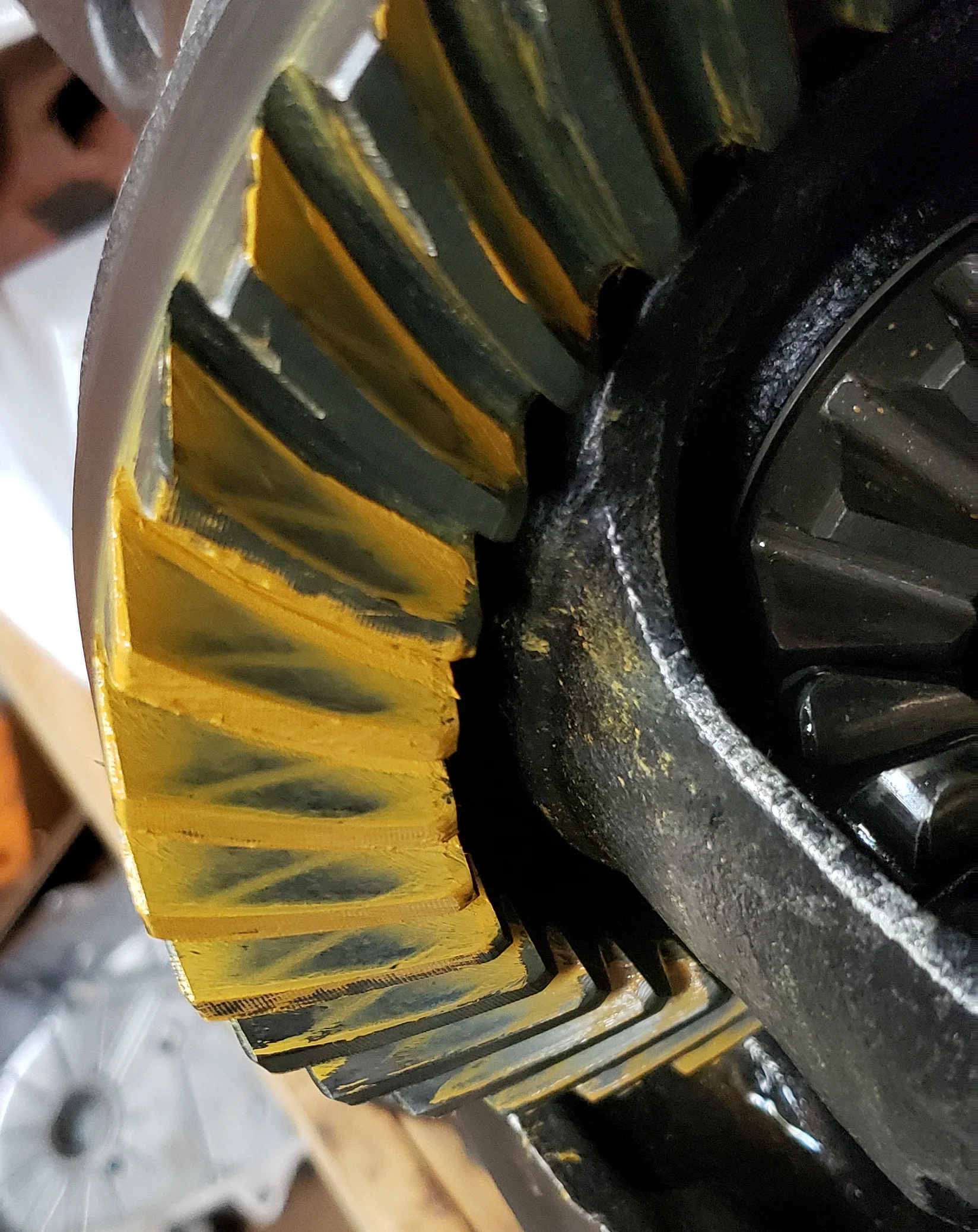

Figure it's worth showing pics of my front Dana 30 pattern too. I set 20-25 in-lbs preload on the front Dana 30 pinion, seeing backlash .0093"... Coast side looks like pinion is alittle too far away, I'm thinking a little re-shimming of the carrier to reduce the backlash, which will also bring the carrier closer to the pinion, is all I need.

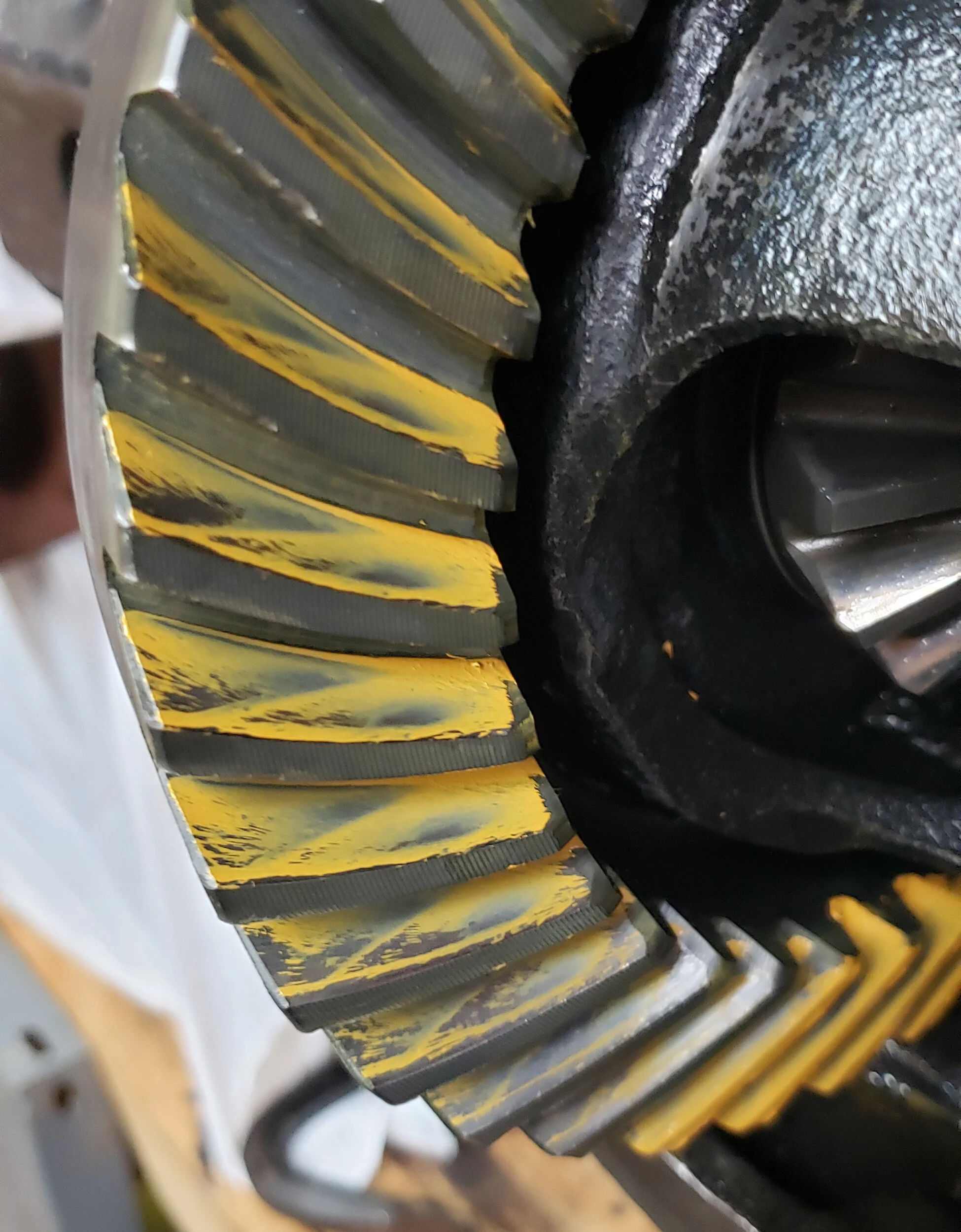

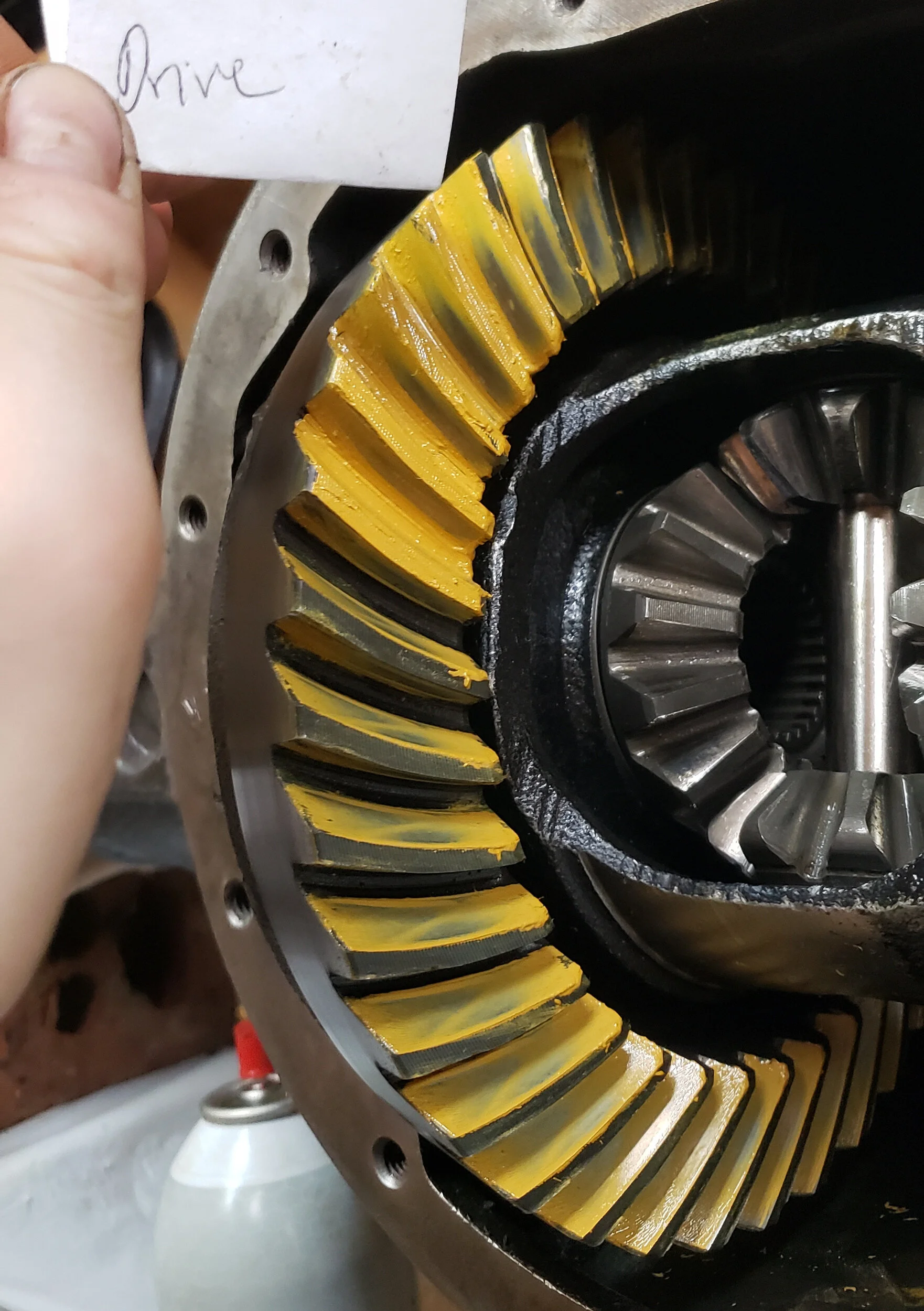

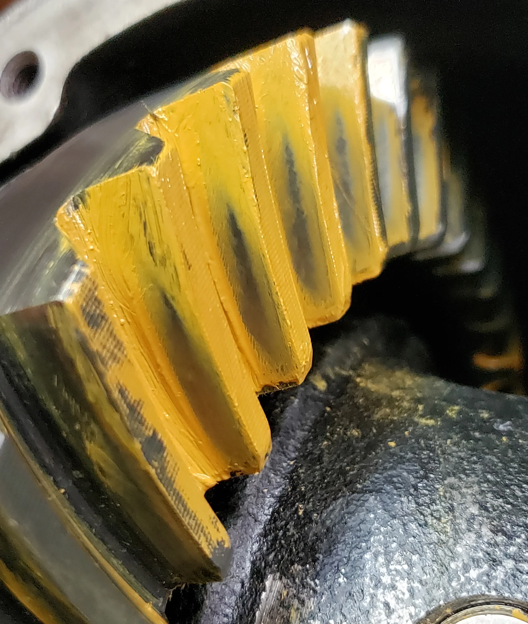

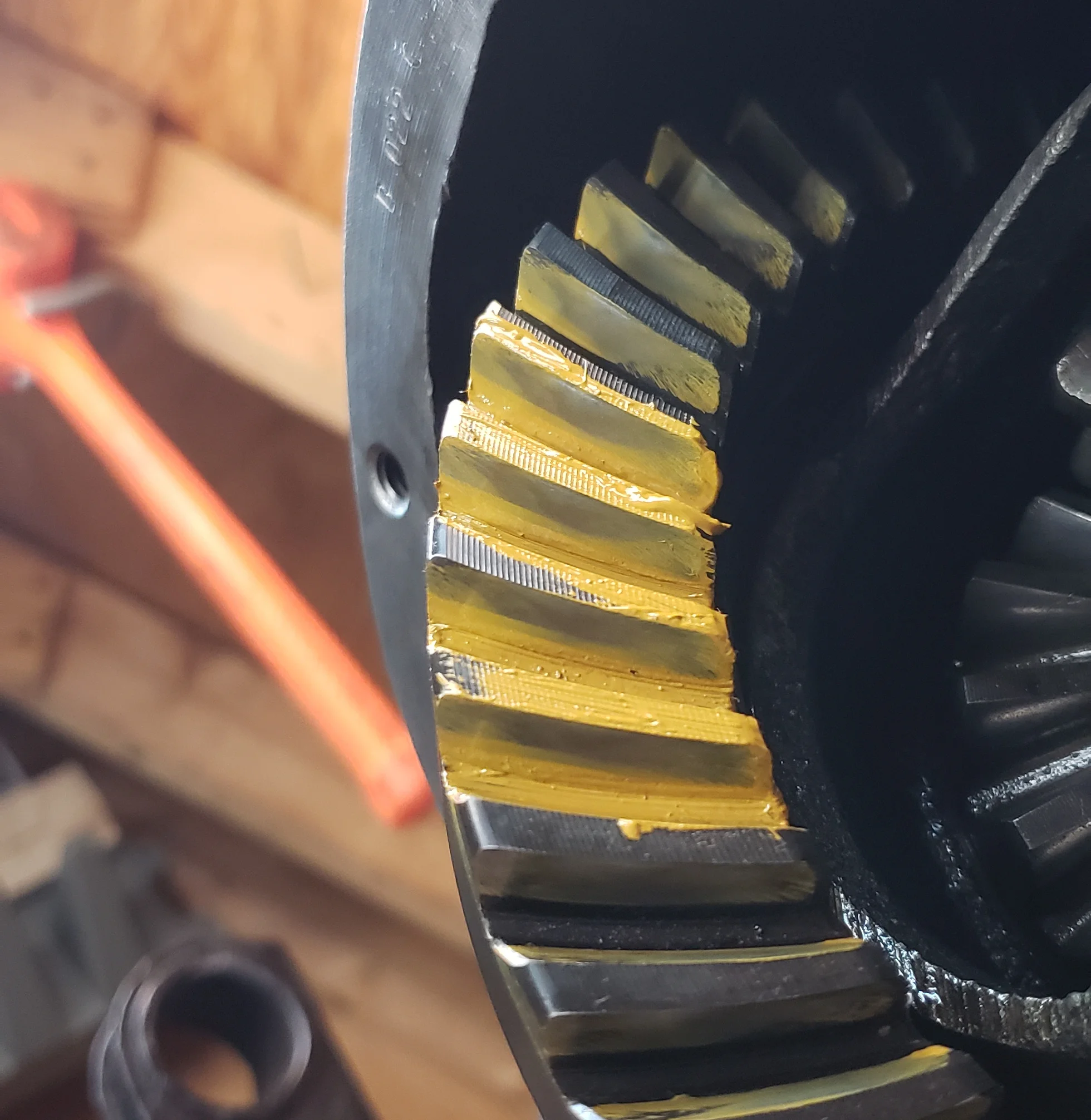

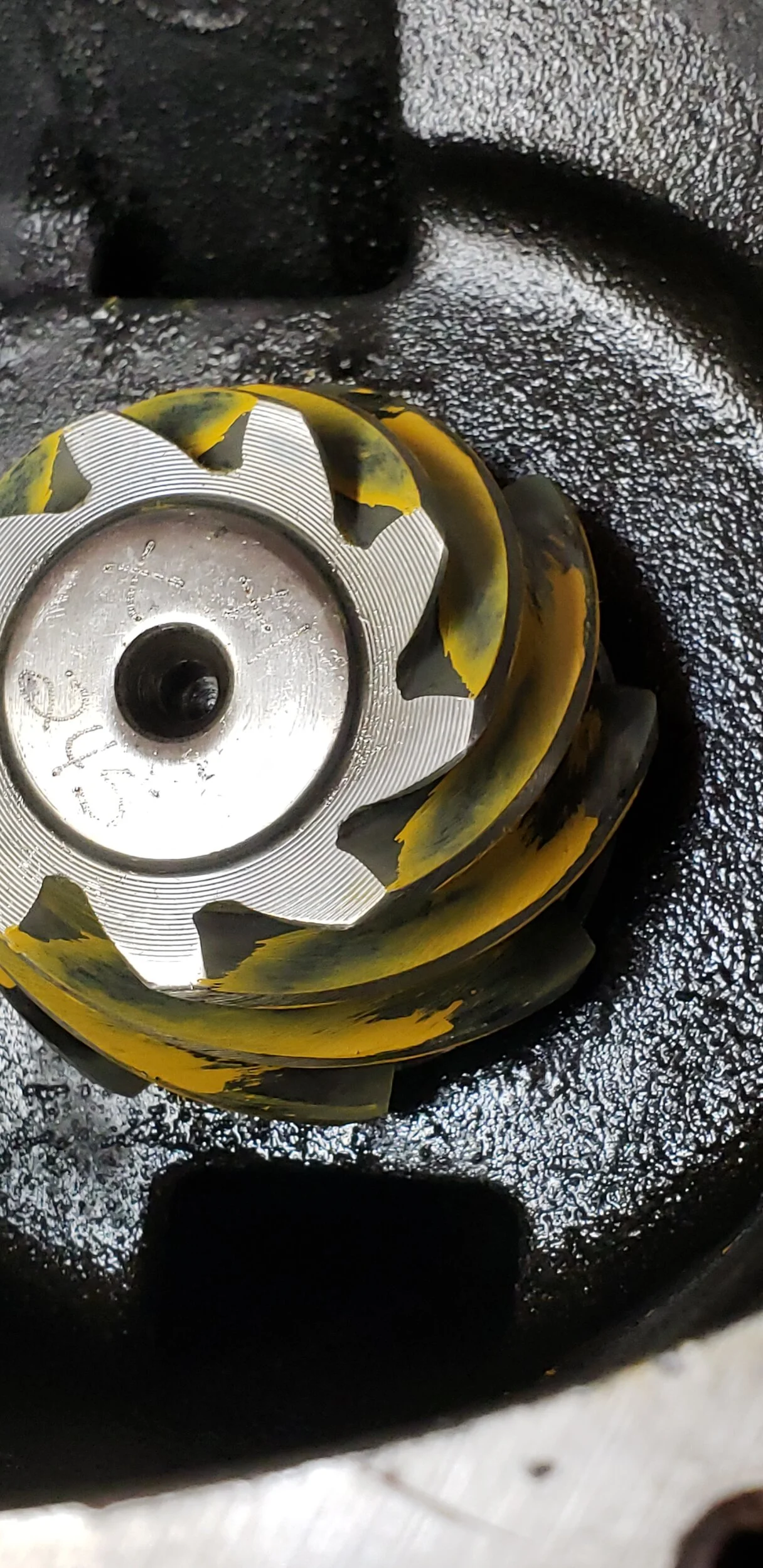

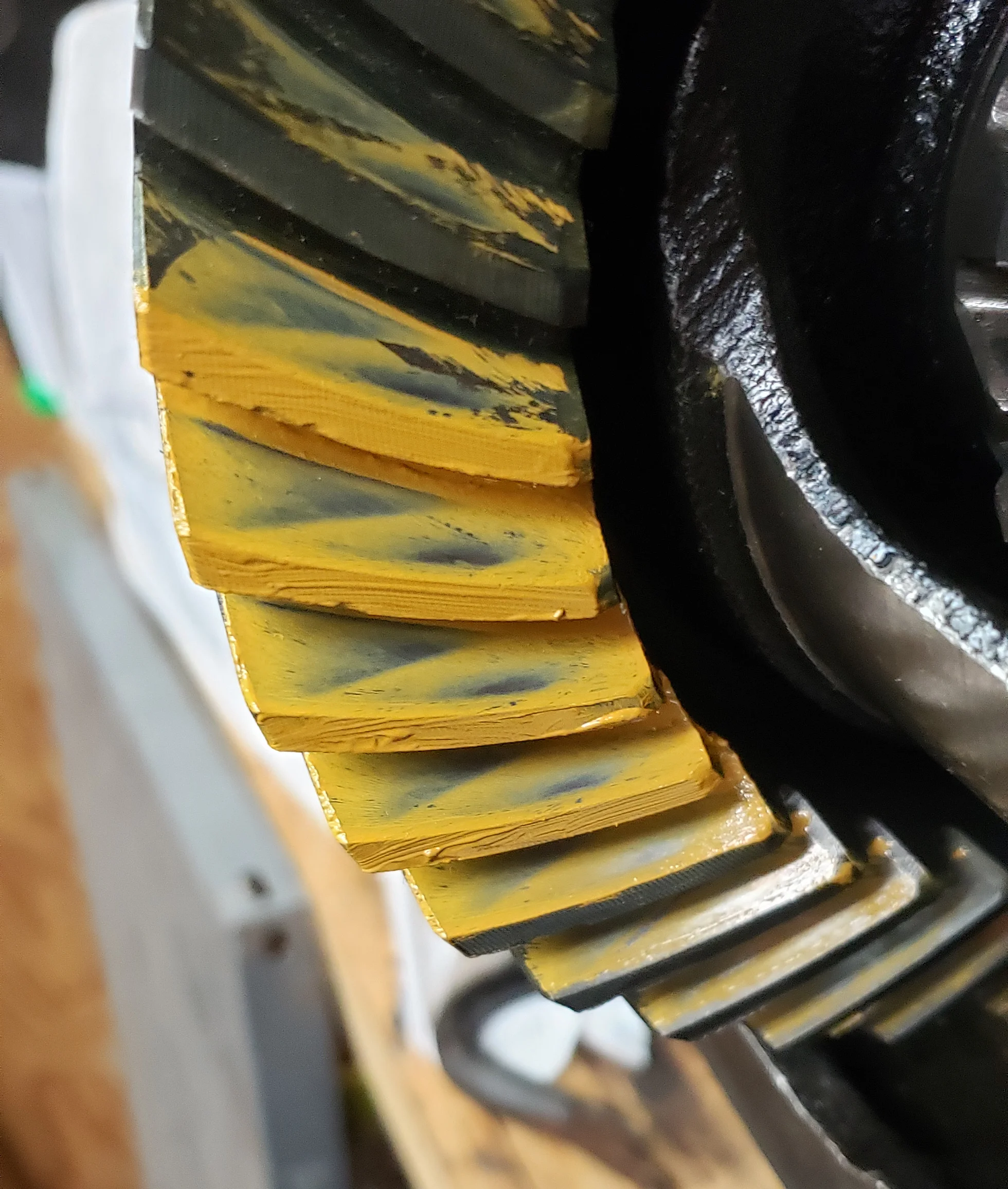

Anyway got the thing re-shimmed. 0 side end play, carrier backlash .004". Not sure what to make of this patter. I ran coast side first, 3-4 teeth 3 times around the ring, and get this two part imprint (showing pattern imprint and ghost on clean teeth)

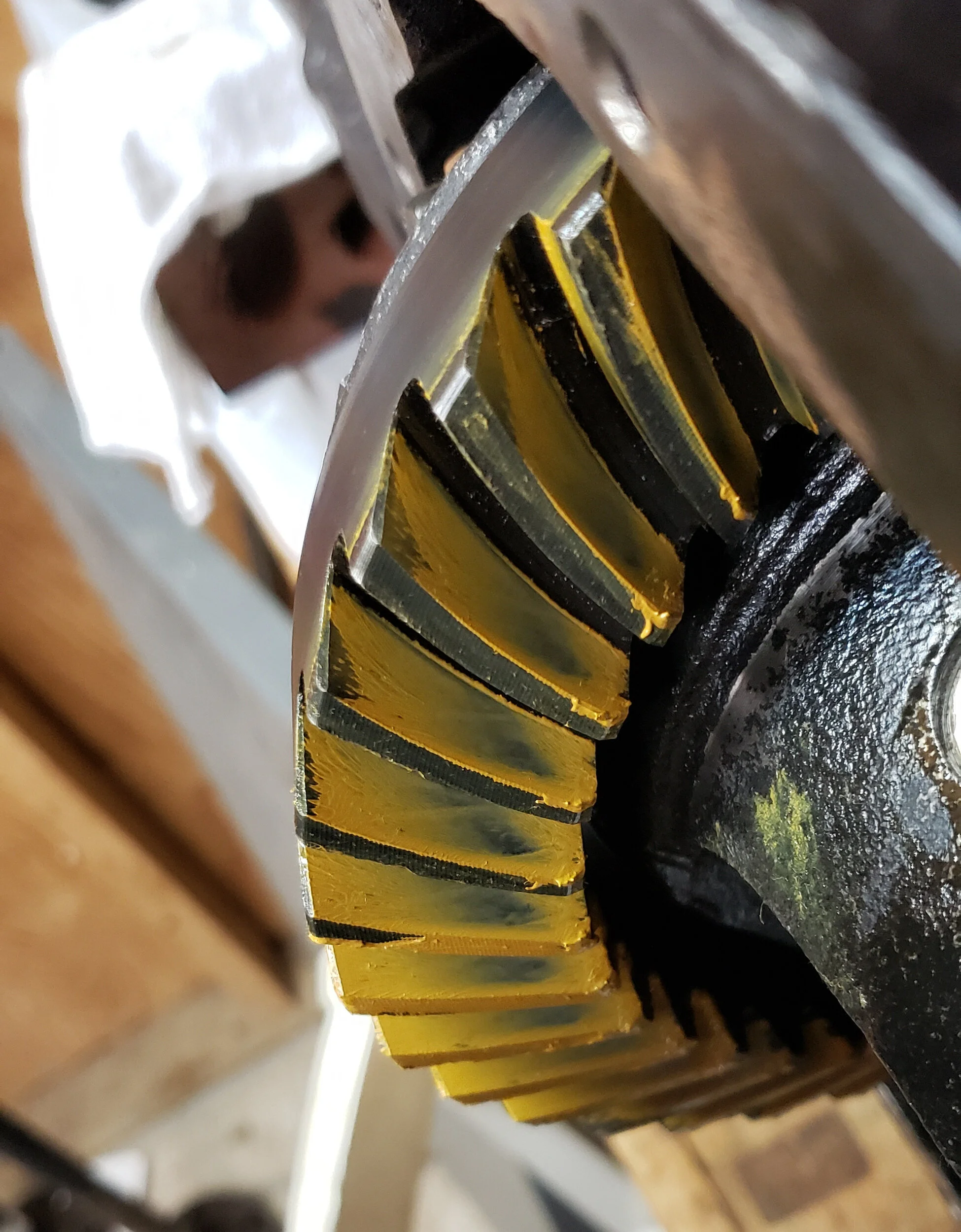

Now for drive side, this one was clearer, I think pinion depth looks OK based on this (cautiously, because this is a gear with 100k miles on it)

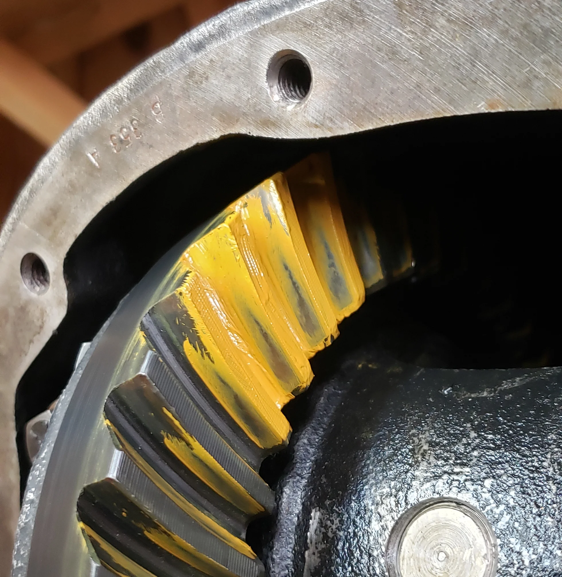

Not sure what to make of coast side.
Ok with used gears patterns are rarely pretty. Do not chang your pinion depth from where it was. Ideally you do not want to change the backlash either.
Lack of preload on Dana 35s is not uncommon. You will want to increase preload by increasing shim thickness on the shim opposite of the ring gear and if the backlash doesn’t go out of sight run it.

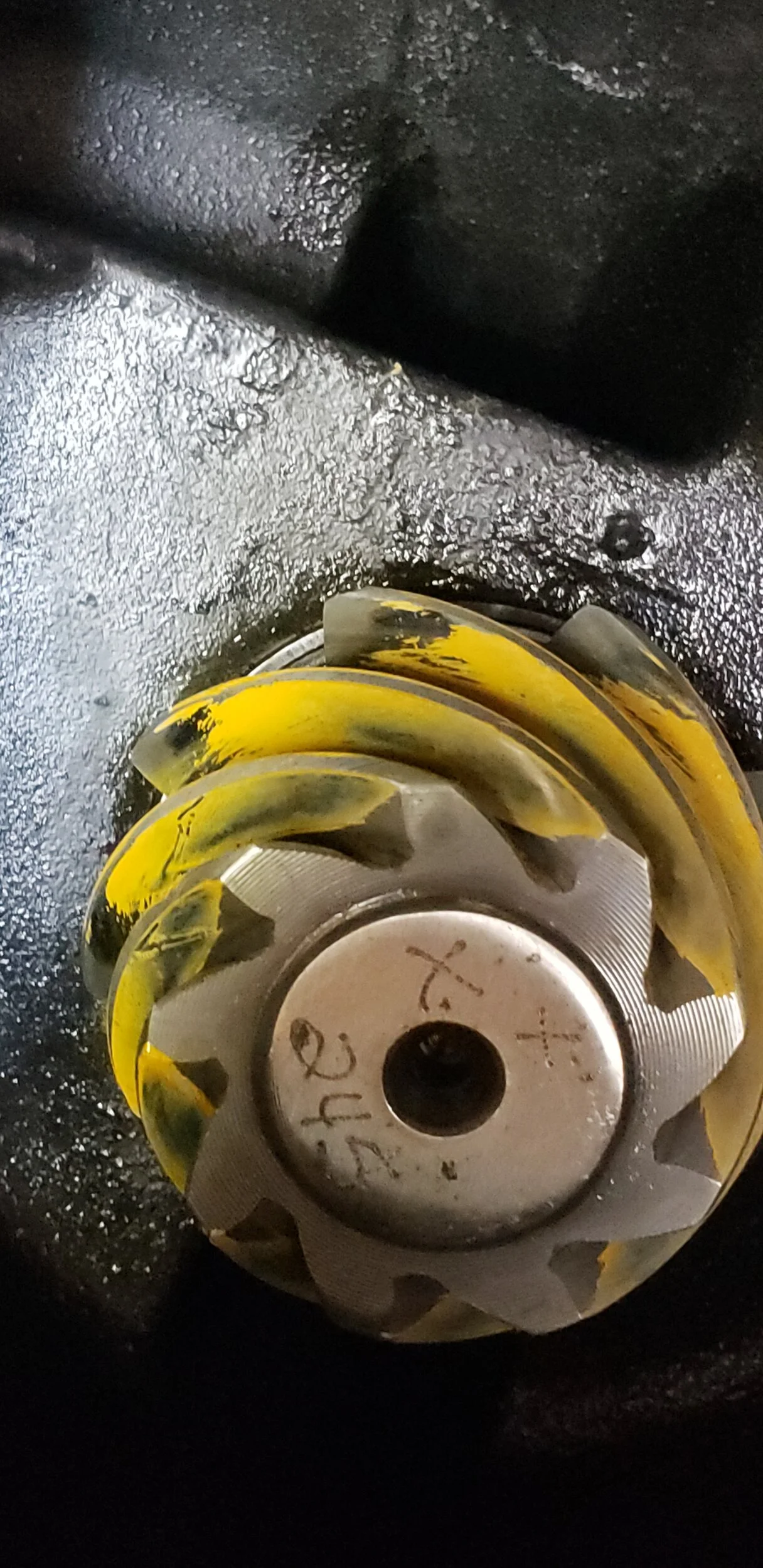

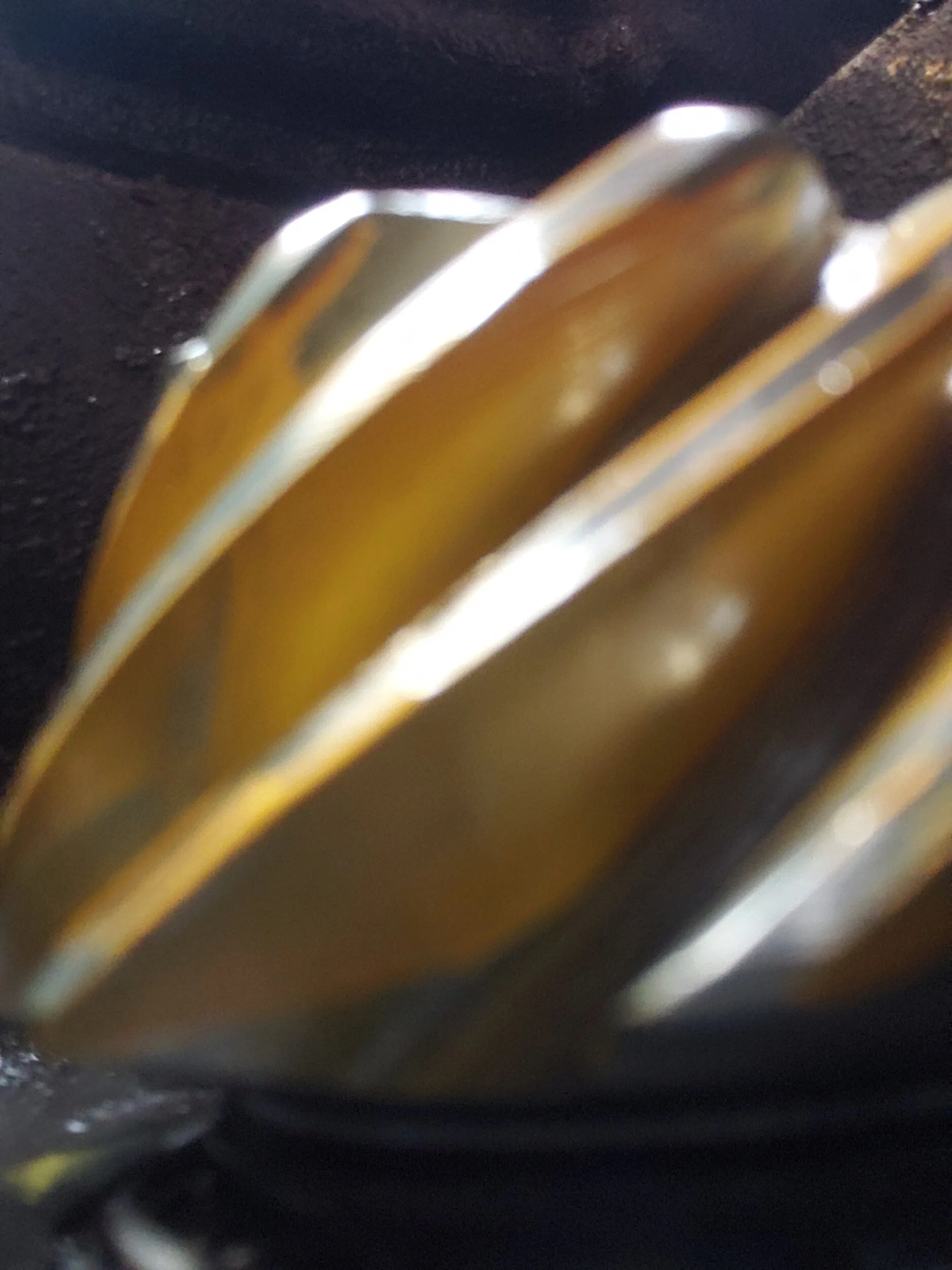

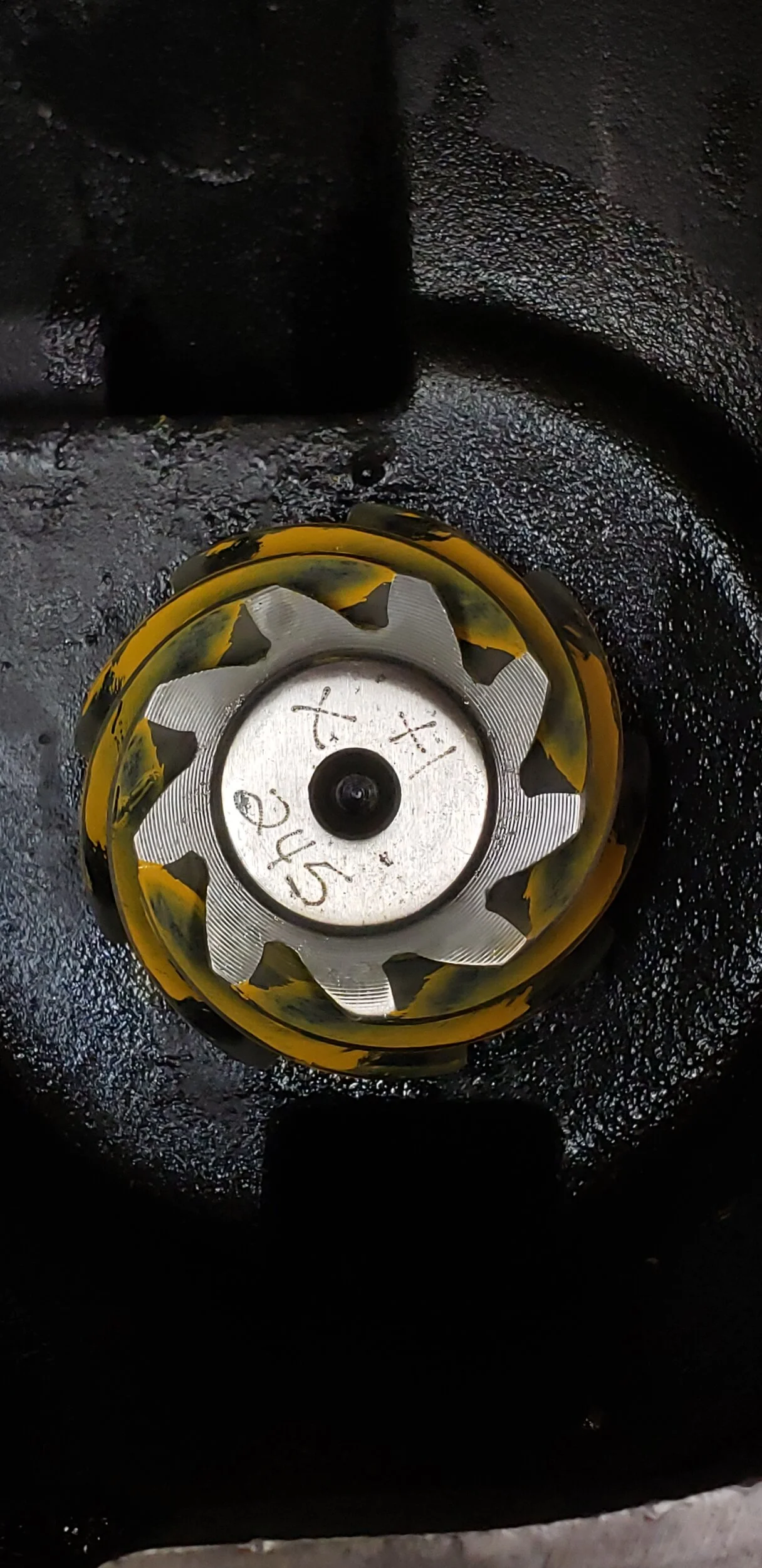

Here are pictures of the pinion for reference as asked. Could not get coast side in focus but tried. I will increase the backlash a little and add preload, see if pattern happens to change, and in either case, with backlash in spec .005-.008" I will run it.
@Blackjack I did not change pinion depth however didn't know anything about axles when I tore this down a couple years back so didn't measure original backlash. I appreciate your input. Lesson learned next time I do this run pattern and measure backlash before teardown...
Reactions: Rickyd
Since the gears are used I would not try to get below .008 for backlash. .010--.012 would be better most likely as that is probably where it was.
Here we go, I got .011" backlash now, pattern remains unchanged, everything feels smooth. Feels a little loose compared to .008", I can hear the slight clink of contact break/make when reversing directions, but I trust the judgement of those who have done this before better than me who has 3 axles waiting to be built and 0 historically done. :)
A little unclear from camera angle. First image (two part pattern print) is drive side, second (burger) is coast side. Both within boundaries of the tooth, so even if ugly, contact patch is within alignment.

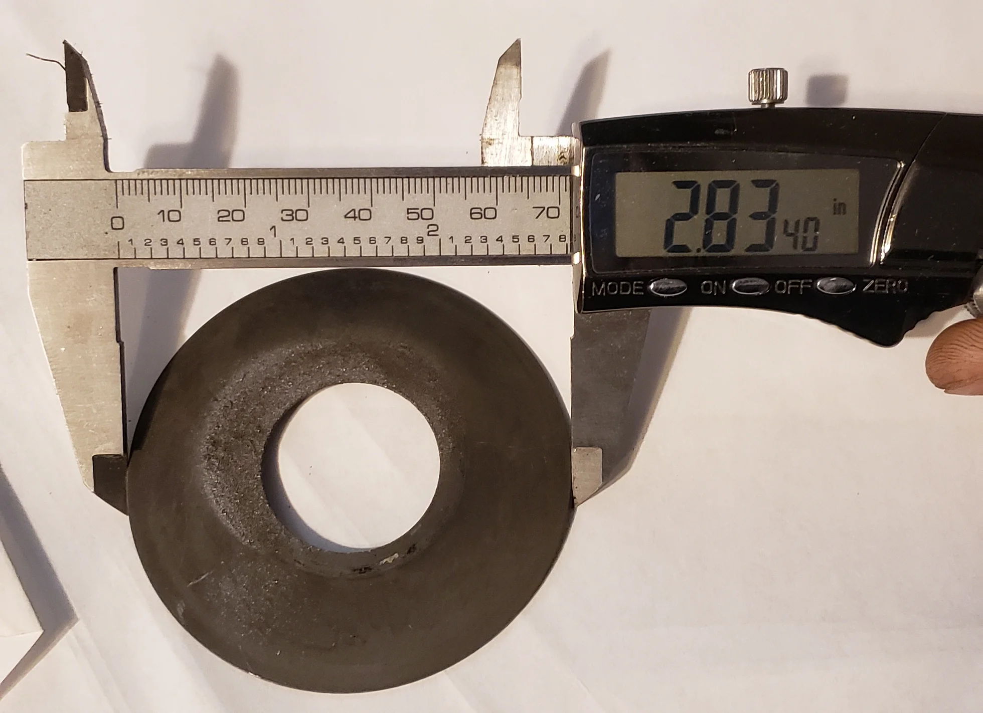

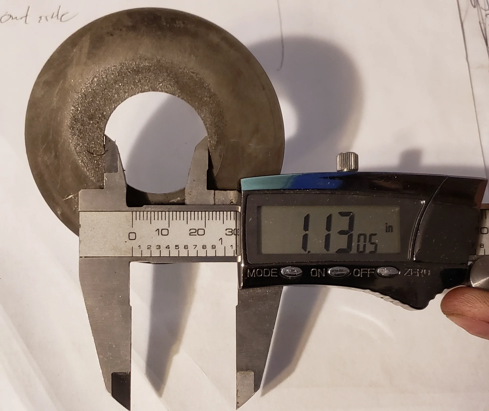

By the way, worst time to have to ask this question... anyone recognize this part and where it might have come from on a Dana 35 or Dana 30? It looks like an oil slinger but I don't remember seeing it behind the pinion on either axle (I do have a much larger OD shim/slinger on the Dana 30 I haven't finished setting up carrier on yet). It's .030" thick. Reading up, seems it might be somewhere near the pinion nut on the Dana 30, not used to set pinion depth, and may not be something I need to worry about... but I'm not sure.
