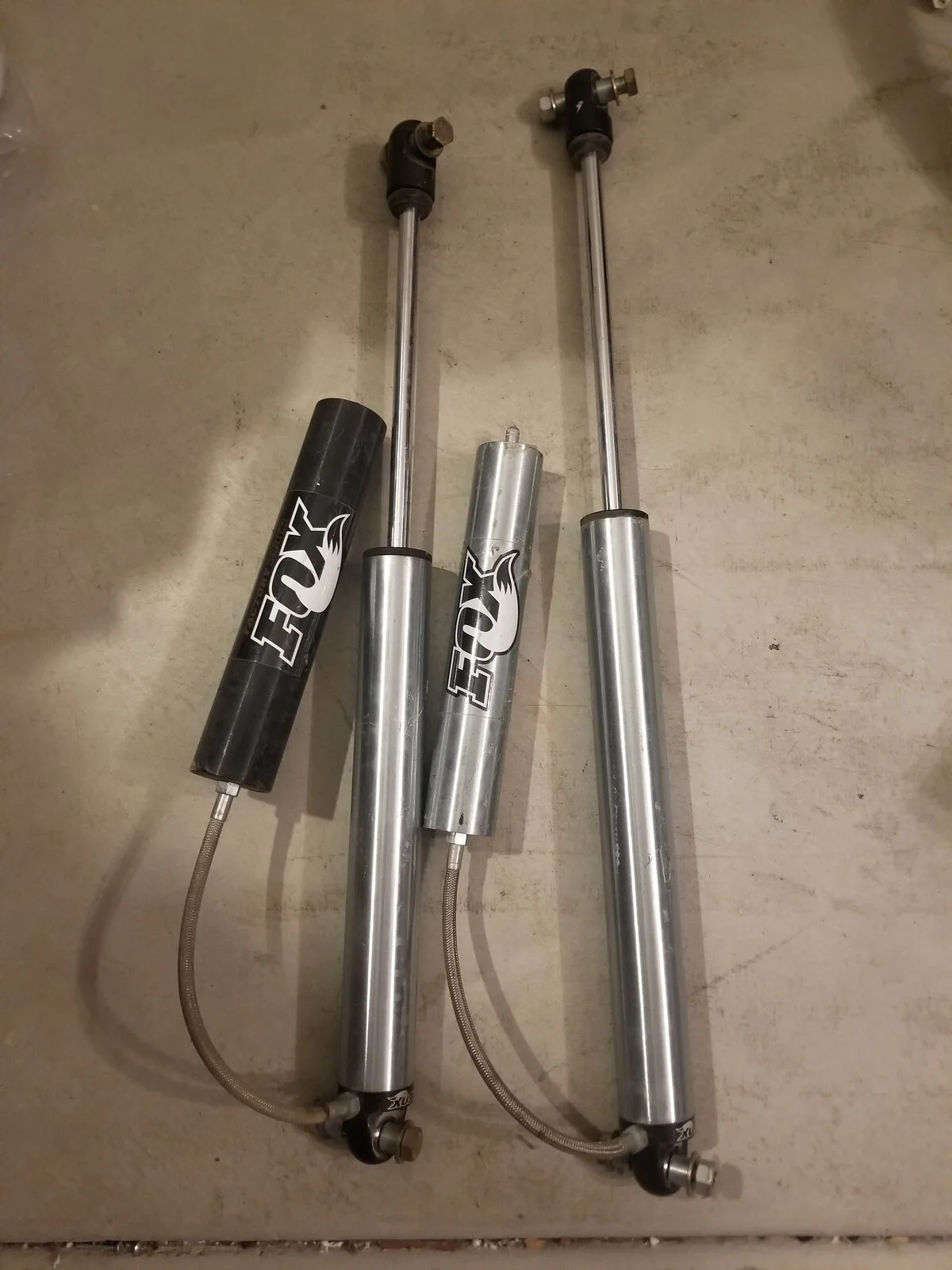

I picked up a set of lightly used shocks that are for outboarding the front and rear. Both sets have been custom tuned for an LJ. I do want to outboard the rear, but haven't decided if I should get the front done too.
Labor for the front is around $1200, but I already have the shocks. Or I could buy shocks that will work with the OEM shock mounts and maybe save a little. I would get tunable shocks.
Picture of what I have attached (I have two of each)

Considering your rig, I'd just do both. It just seems to be a natural upgrade to go along with everything else that is on it. A lot of unsprung weight to slow down in the front so more uptravel = more better. The difference in price is what, $700 or $800?
What length? 11s up front are relatively easy. 12s are more difficult and fussy.
If the valving is good, then getting them fitted up front is worthwhile
Your figures sound about right.
If it's worth the extra money, I'll do it. Otherwise, I'll save the money for something else.

What travel are your fronts? I’m assuming your using Currie’s bump stops if you have a mid arm. I just finished my front with 12s.
Some notes to pay attention to. Some of these may not apply to 11s.
1.) Caliper to lower shock mount/ shock clearance at articulation and full bump.
2.) Brake line length at droop and articulation while turning the steering wheel.
3.) Upper 3 link arm at articulation and full bump
4.) Trac bar to diff clearance at articulation and full bump.
The rear outboard is a walk in the park compared to the front. Neither is difficult just a lot to pay attention to.
Reactions: L0jik
Looking back at your photo answers my question on what travel the fronts are.
