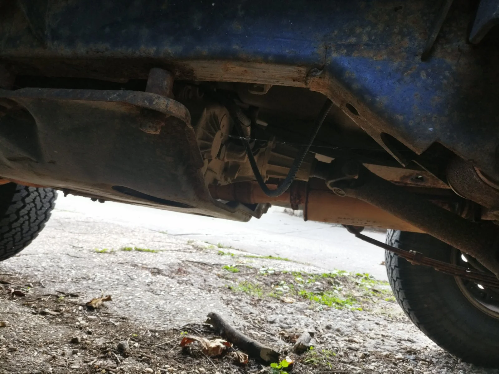

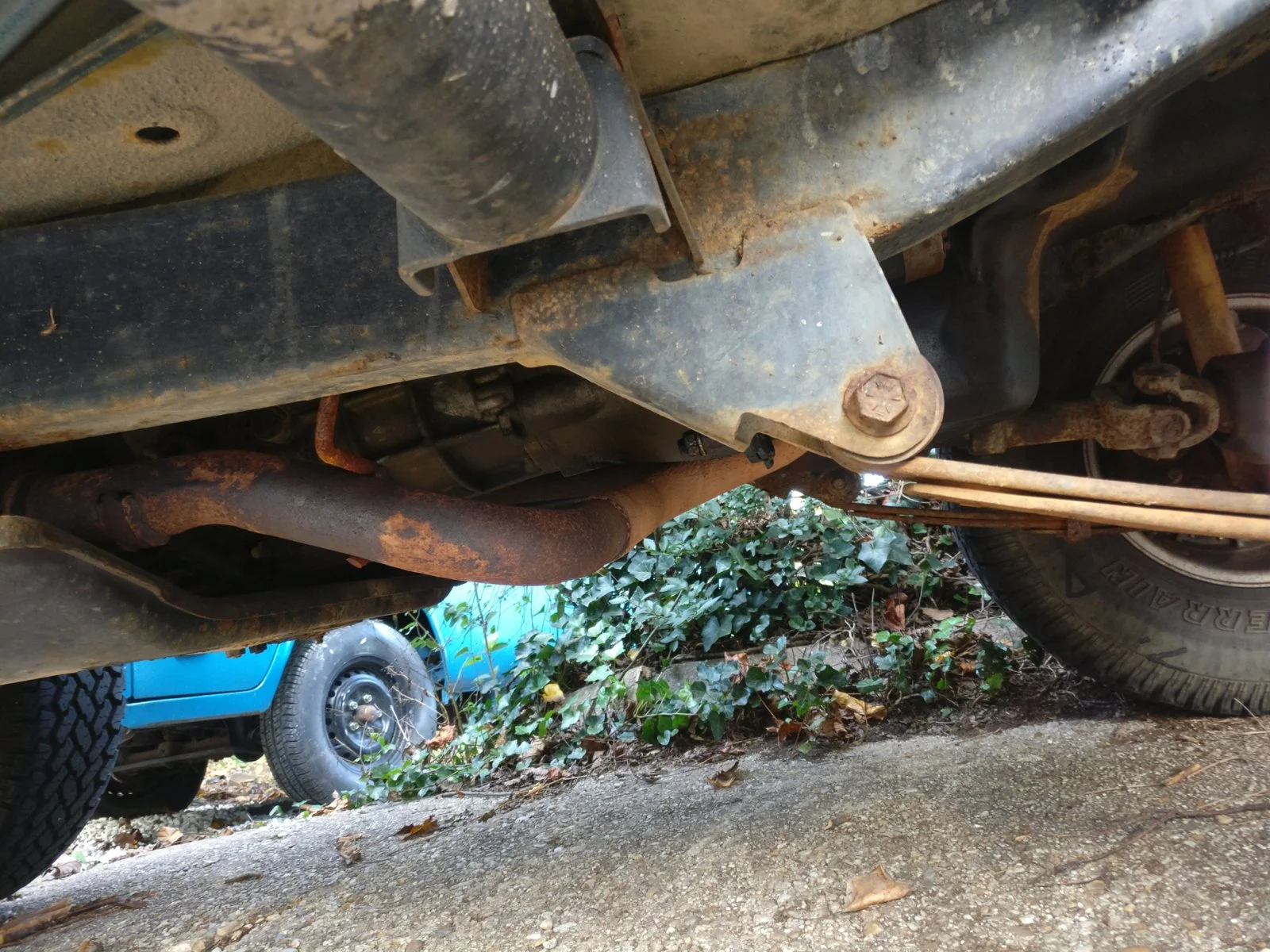

Im looking to buy my first jeep and I just need help deciding if this is a good deal. The car is only $2500, but I just need your expert op
inons on it. anything helps! thanks!

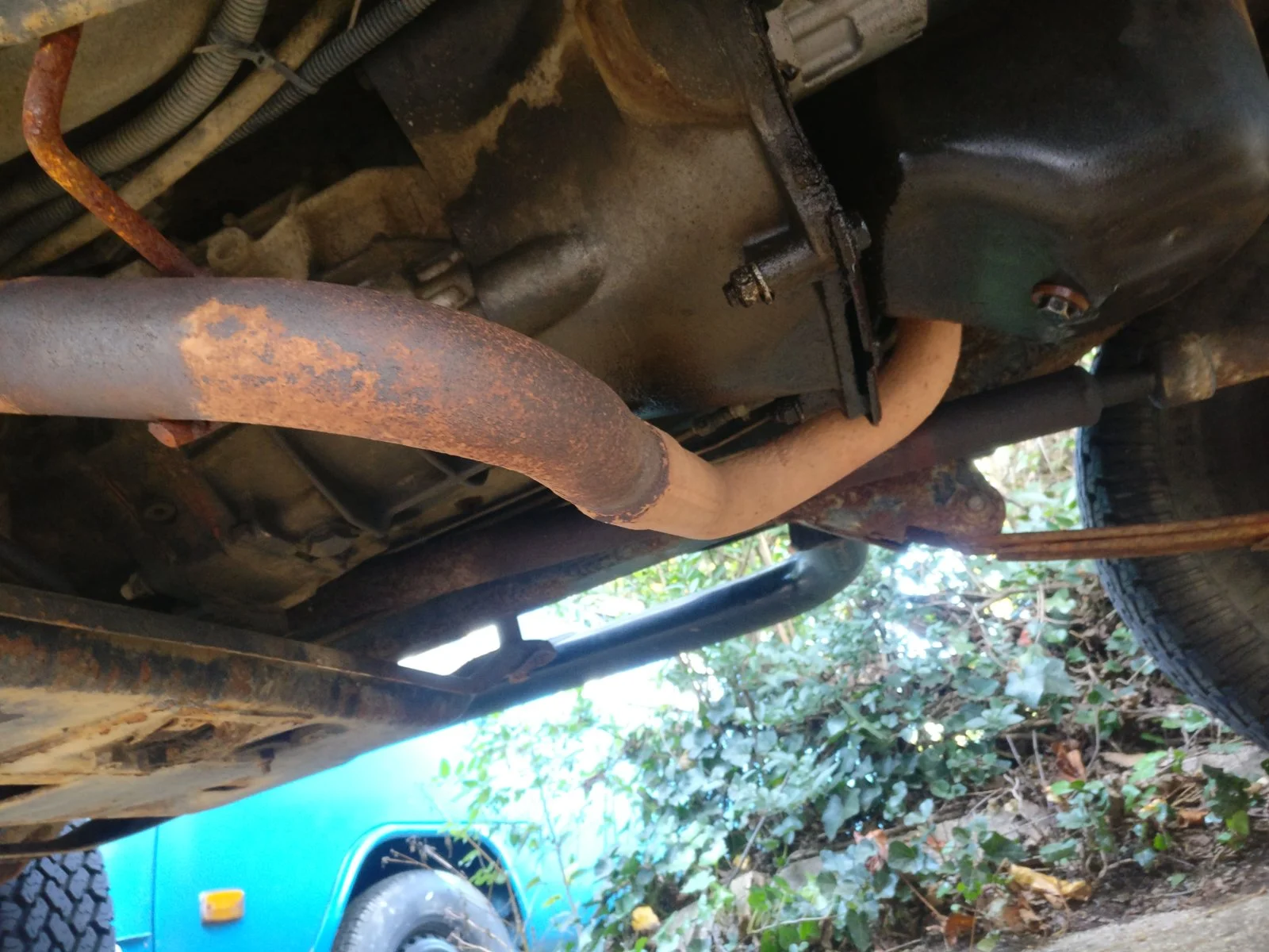

Stay away from that thing. I can see some serious rust under that transfer case, to the point where it's snapped one of the bolts.
Walk away, you'll be sorry if you don't (if you plan on keeping if for a long time at least).
There's a reason that thing is so cheap... it's literally waiting to fall apart on the next owner.
No. That will be the most expensive $2,500 you ever spent.

That right there is internal frame rot. I guarantee you if you take an endoscope to the inside of that frame, you will see something far worse than the outside.. it's rotting from the inside out.
That transfer case is barely being held onto the frame. In order to fix this you'd at bare minimum need to cut those sections of the frame out and replace it with new pieces. However, in doing that, you're likely going to find even more rust in other places.
What I'm getting at is that this is a BIG project, and if you plan on keeping the vehicle for a long time, you shouldn't even consider this one. There's a reason they are asking $2500, period.

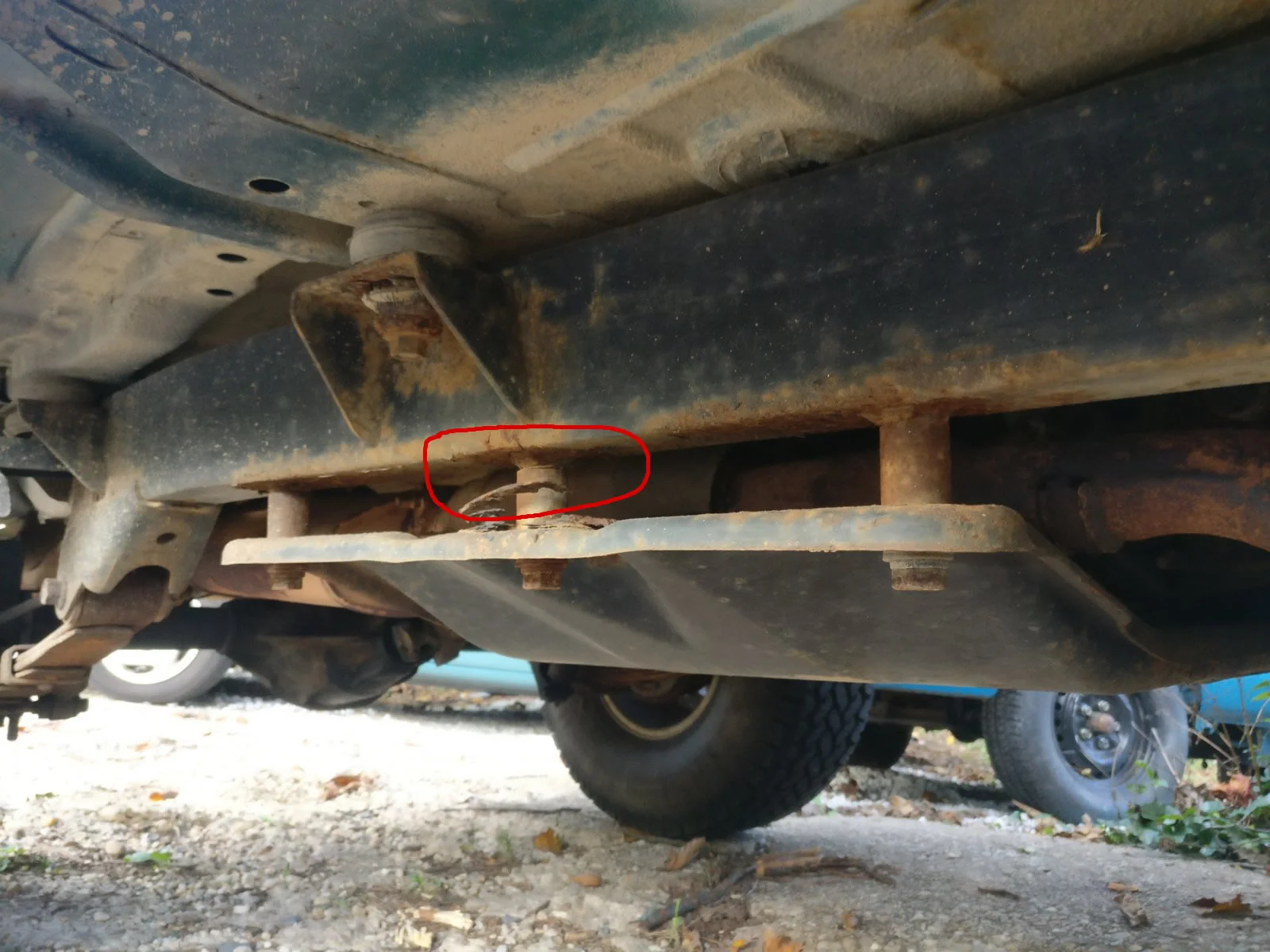

I spent an average of $1000 every year, including tires, shocks, brakes, new engine. It will be a project every year. Not sure I agree with the rust comments, it looks way better than the one I sold. No sign of body rust but the area to check professionally is the rear frame, at and behind the rear shackles.

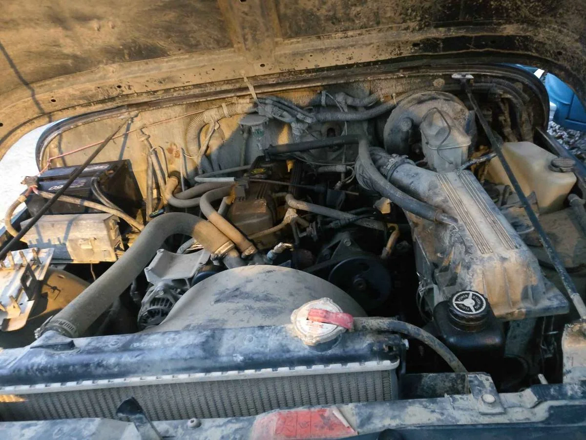

Frame rot, maybe a fairly serious rear main leak, and looks like a 4 cylinder, too. Hard pass.

I see that broken transfer case drop spacer, a hole in the fender, Rear main leak, and a 4 cylinder engine. The rust really doesn't look bad to me...Yes, there is some there and once its there, its really tough to get rid of.
@Chris We all know how you feel about rust, but you cannot say that the frame is junk because ONE aftermarket spacer is broken. Who knows what the P.O. used for that spacer. You can't even tell if the bolt is broken. You're making a big assumption, I guess is what I'm saying.
