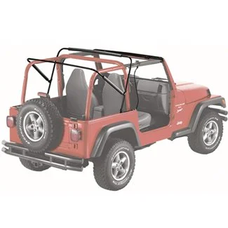

This was driving me crazy with the major differences between the soft top frames of the red Jeep and yellow Jeep above, so I did some research and the best I can tell:
The red Jeep's soft top hardware is a BesTop Supertop® (not Supertop NX, just Supertop) aftermarket frame. It differs from the OEM design (different connection points, foam on bars, no straps, to name a few ) and is designed to be used only with BesTop Supertop® soft tops. It can be purchased standalone or as a set with a BesTop Supertop® soft top.
The yellow Jeep shows the OEM style soft top frame that would have come factory on a Jeep TJ, this is what most aftermarket tops are designed to mount to unless specified (like certain BesTop tops that need different frame hardware made by BesTop, etc).
If you have the OEM style frame hardware of the yellow Jeep, you should not add foam to it. You should check to see that no hardware is missing and that everything is properly connected. You can order new replacement parts for all aspects of the OEM hardware at the Jeep parts site of your choice from what I have seen while researching.

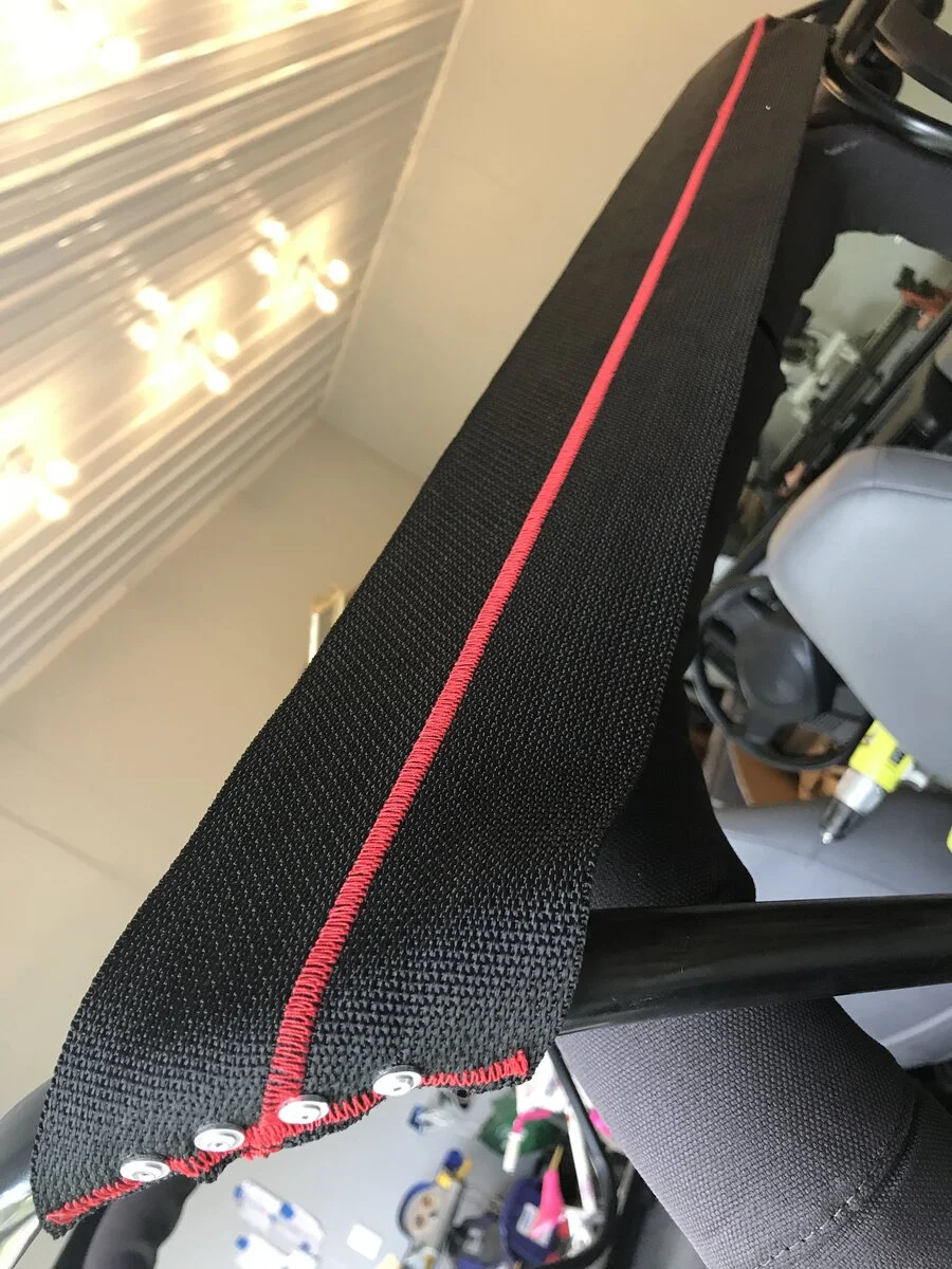

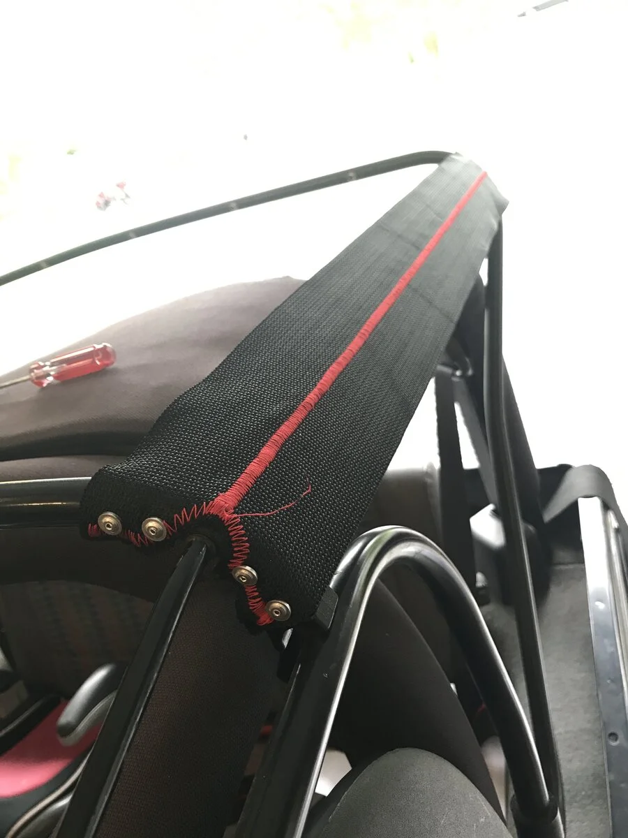

You definitely need the straps to hold the back crossbar in place. Mine deteriorated too, so I went to joanns and got some canvas like fabric that was as close to the original fabric as possible. It wasn’t as wide, so I had to sew two pieces together, then cut it to the same size, burnt the edges (to prevent fraying) and riveted into place. Has held up well, I think I replaced them around 3 years ago now.
Nice job!
Ya. He has to replace his straps. No amount of new top is going to fix that. :)
That looks awesome! The top got put on back order. It should ship out this coming Friday but I'm still trying to figure out where those straps connect to. I've got one connected on the far back top passenger side corner but the other end is just flapping around.
I had written something several years ago about the straps. I will paste it here. If you need measurements, I can probably come up with something. I’m on the road now but tomorrow I should be able too. I made an extra when I did this. I just used a chisel to chop off the heads of the rivets and replaced them. Crazy easy.
The strap listed below was the right width (just under an 1/8th" wider) and thickness of the original.
The company, I had seen in other posts, but had a tough time rummaging through their product until I came across another post from some time ago with a link.
It's strapworks.com and the product code is: HWP3, Description is: Heavyweight Polypropylene 3 inch. I picked black of course. It was $13.05 to the door for 20 feet. 5 days to the door with their basic shipping.
This bit above is for the next person trying to figure out where and what strap.
I have installed it now. No issues at all. I riveted the strap in place, I used some small washers on the rivets because the heads seemed small, give it a little more bite. I used the old strap as a template to cut the new strap. If it's too damaged you can take the other off and use it as a template. From side to side they just flip as I recall, the cut is the same for both sides. Besides, I bought enough material to make multiple. A new one is already cut for the other side.
I bought a cheap riveter at harbor freight and knocked the old heads off with a chisel. Having never riveted anything before, it was easy. Hope this helps.
BTW, I used a soldering iron to put the holes in the straps and a lighter to seal the threads where it was cut.
I’ve had these on there for about three years with no issues whatsoever.
