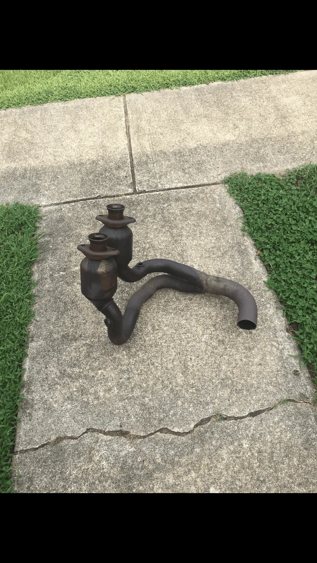

First I have read a lot on here about the pre Cats and other issues. Anyway I have the pre cats and down pipe out and yes 1 has failed , I have a walker brand on the way , but read that while it's out too go ahead and put rear seal in , & yes it's leaking ,133k miles to date , my next question is while the pans out do I go ahead and put the new oil pump in from below & how hard. Is it ,? Plug and play? Let me know your thoughts and any tips of dos and donts
