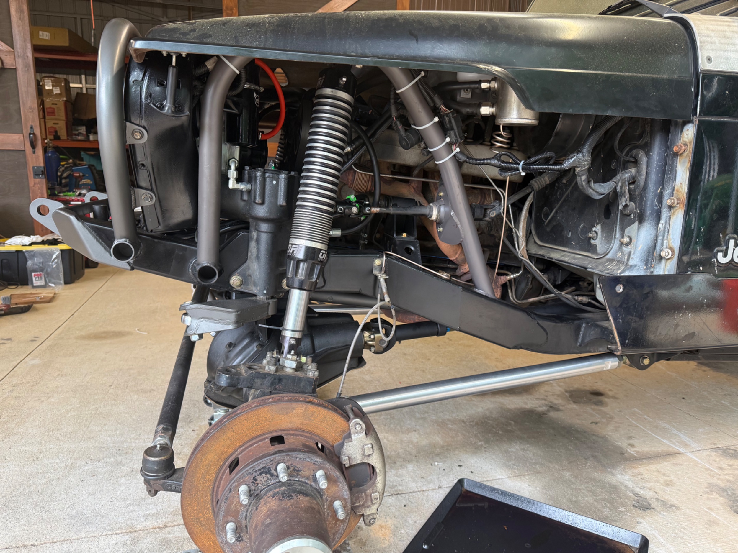

The list of what isn’t custom on mine is shorter than what is 😂🤣. Probably the most “uncommon” custom thing on it is having a Motobilt front half kit but with a steering box instead of full hydro. The box is from a 1979 F150 and everything that touches it is fabbed to make it work including the pitman arm that wraps around the track bar bracket.

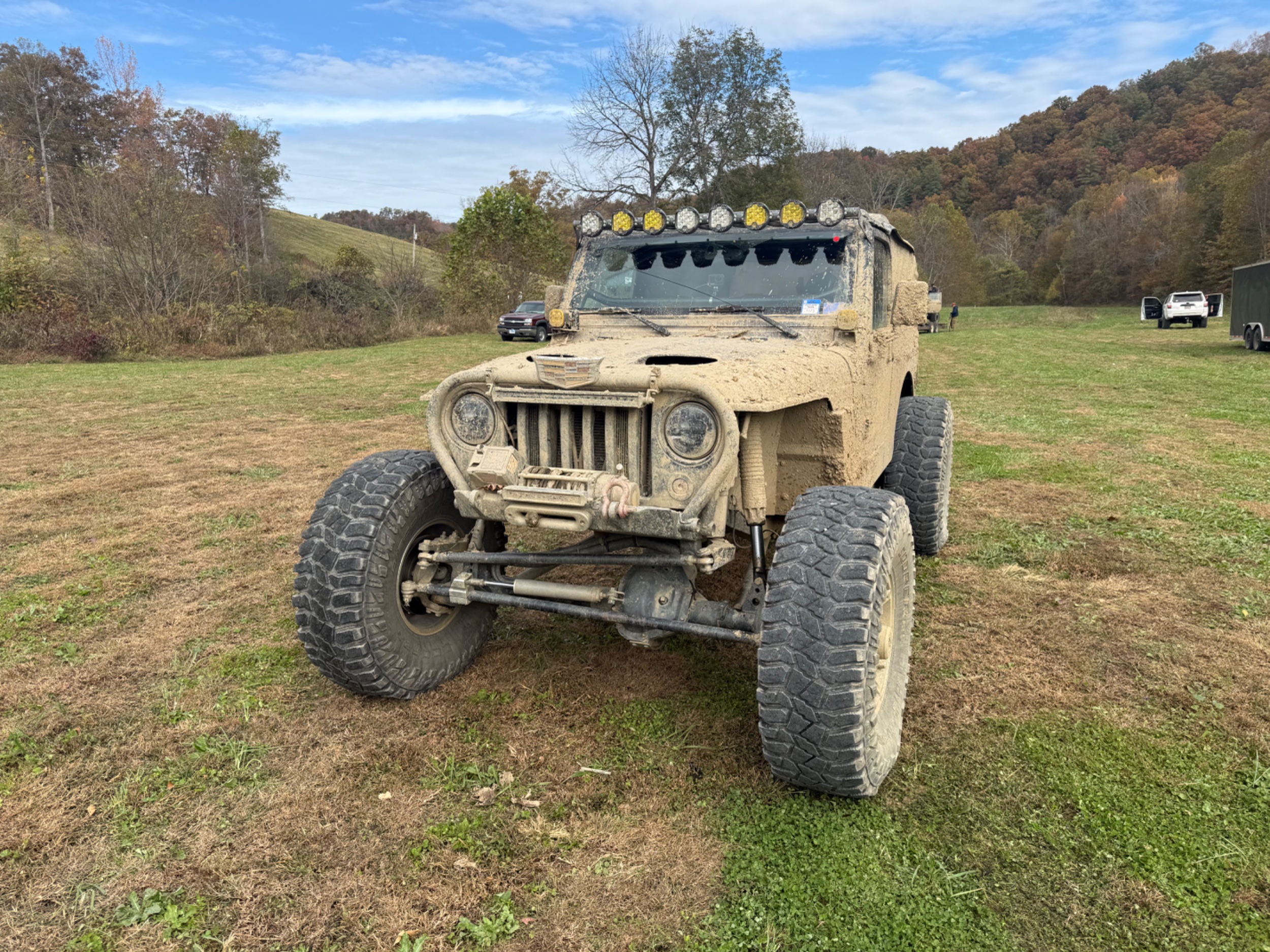

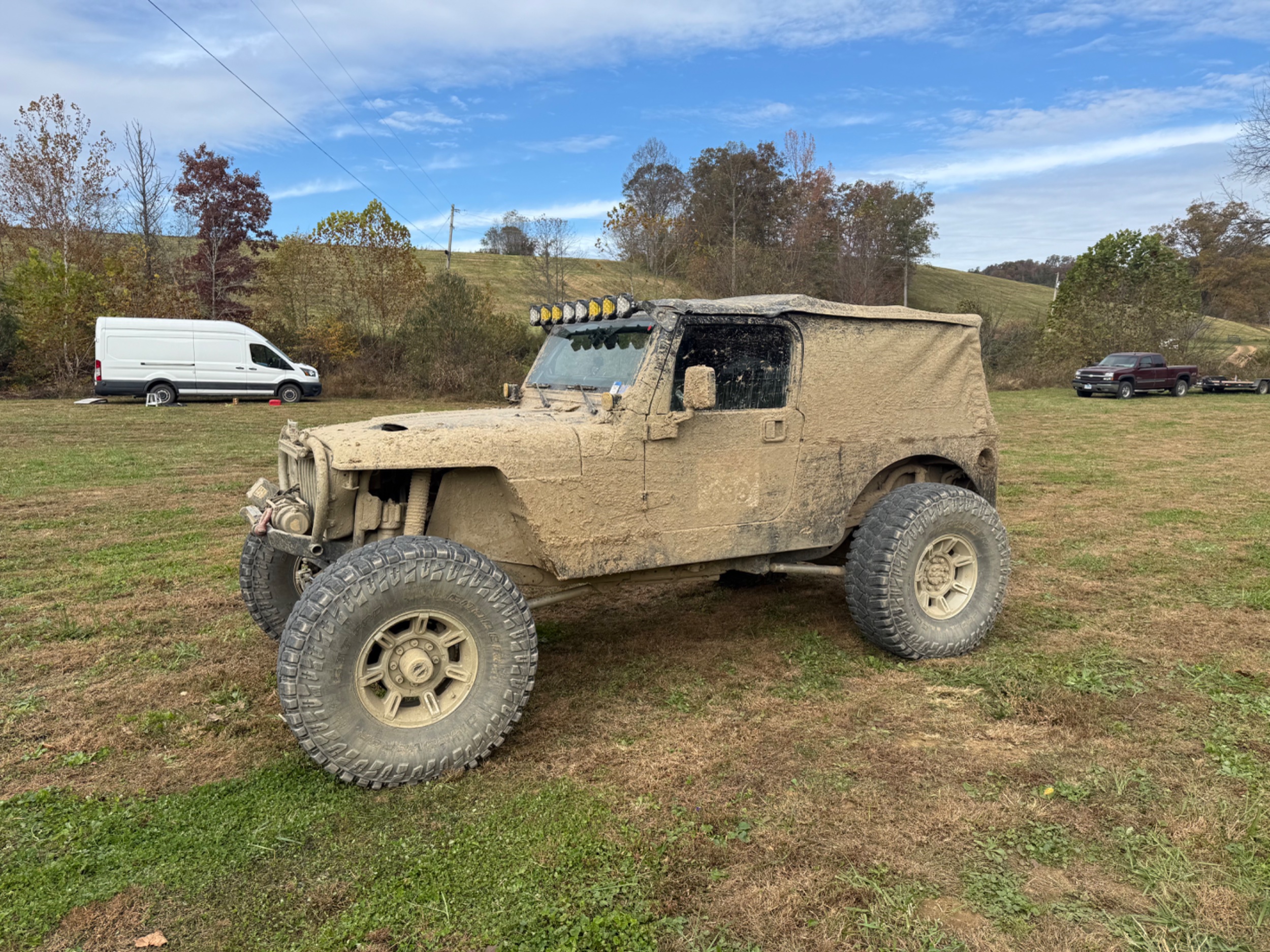

I somewhat blew the seals out of them during the 24 Hours of Appalachia endurance rally in Kentucky in October but ORI rebuilt them and updated them to the current spec for a fairly reasonable price and it only took about 1.5 weeks with most of that being shipping time. ORI said that they’re at least 10 years old based off of what parts were in them and they spent a lot of time sitting while I was building the jeep and before I got them which I’m sure isn’t great for the seals. They were still functional at the end of the rally but both were puking oil and there wasn’t any rebound/top out damping left on the driver side.
After the rally about to go on the trailer for the ride home.

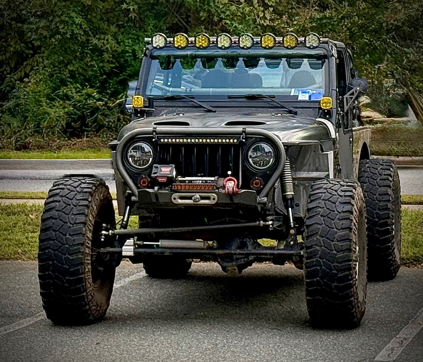

Antenna mounts , rear bumper, tail lights , front turn signals , cargo shelf , Ham Radio installation, inverter, wheels , on-board Internet with cellular antennas on the hood , upgraded agm battery , 4.88 Revolution gears with Eaton Truetracs .
Most of this is covered in the build link .
