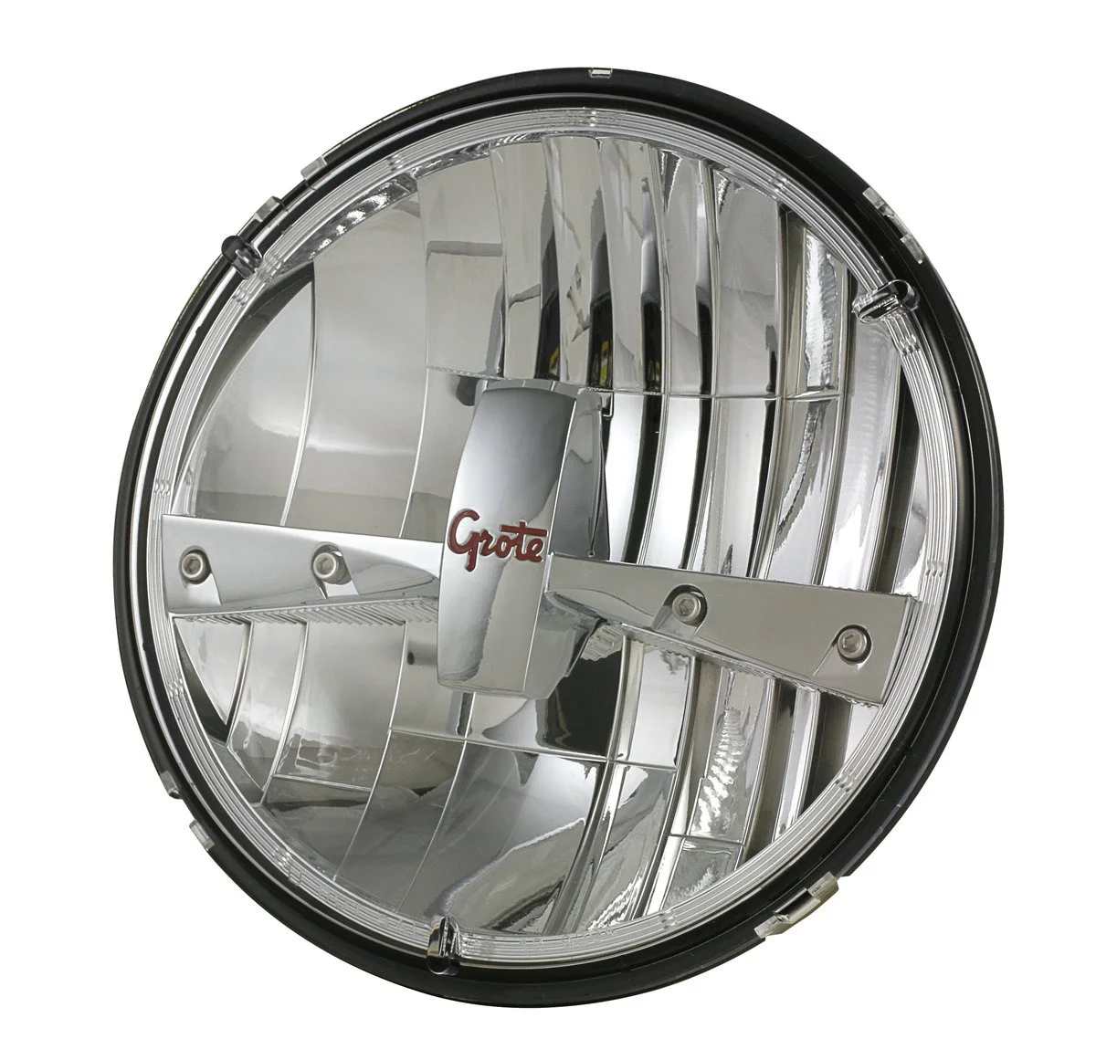

I bought a set of silver star bulbs many years ago and I couldn't see what their hype (at the time) was all about. I'm the same way with a stock looking headlight, so I'm still cruising the originals. I did recently discover the 7" round headlights by Grote. I've tried digging around to find some pictures or videos with their use, but only found one video on YouTube. However, I will say that the one video was extremely impressive. Not quite enough to help me understand the cost of them though. They're pricey, but I really like the look, compared to other LED options.
I'm going to check out the Hella lights you mentioned. How have those been for you?

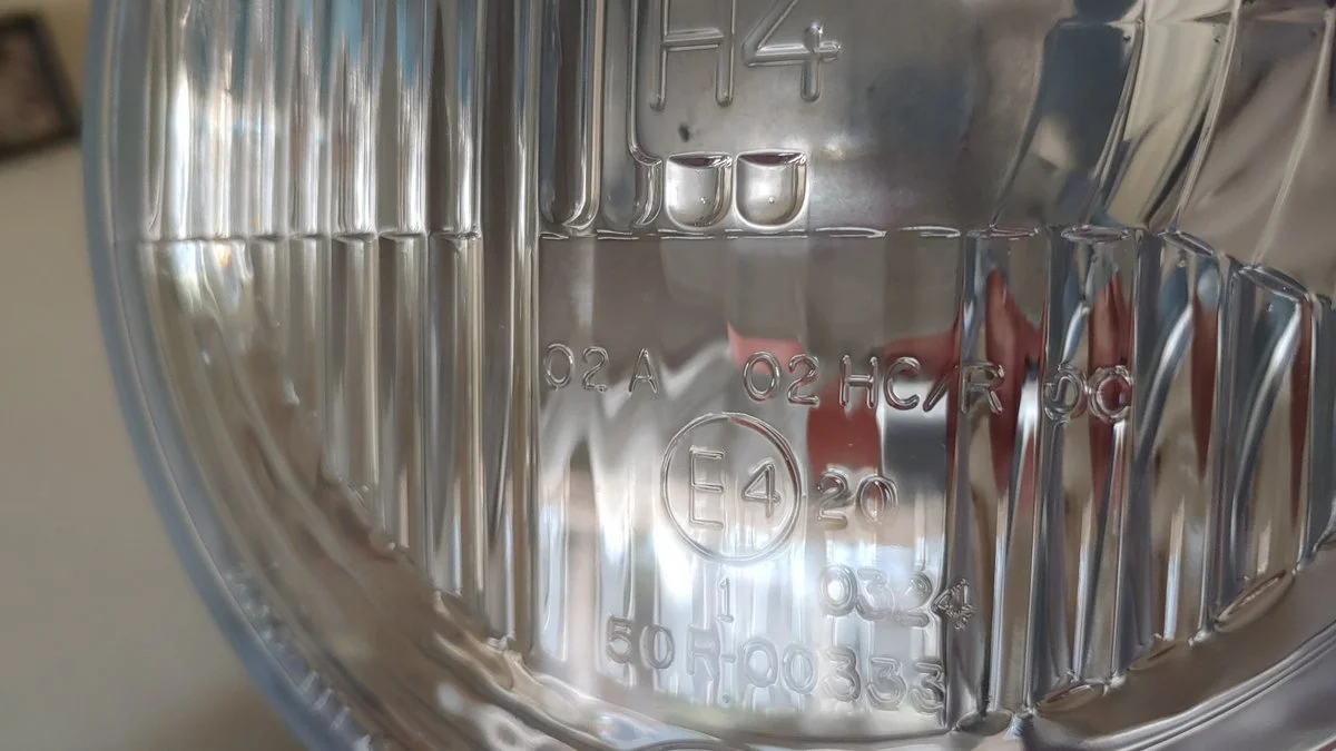

The H4 conversion should work a lot better than the sealed beams. Not sure about the model you ordered, but I (and most others who don't like LED) use the Hella e-code version which is far superior to stock.

I have Cibié e-code H4 housings and they definitely have a very sharp upper cutoff with a rise to the right to prevent blinding oncoming drivers (given proper alignment of course). The factory headlights are DOT and scatter light without a sharp upper cutoff. The factory headlights can get away with this because the sealed beams are so dim it doesn't matter.
I got the headlights installed, aimed pretty good and WOW, so much better than stock. It's one of those mods that you wonder why you never did sooner. Even with the stock bulbs, the difference is dramatic, and you don't even blind on coming traffic, or so I figure by driving in the neighborhood and seeing that the lights didn't light up cars interiors on the left side of the road. They aren't even much more than standard shitty headlights.

To be honest, I only remember the stock sealed beams were dim and utterly pathetic. I can't comment about the stock cutoff because I immediately changed to Hella E-code housings. The H4 halogen bulbs put out more than enough light and in the right places. I don't ever get flashed on low beam. I will use the KC Highliters for a little more lighting punch waaaay down the road when there is no other traffic. I have no desire or need to switch to LED.

Ok cool. The DOT aspect isn't a worry here either. When I read the part about them having a cutoff, the first thing I pictured was a fairly prominent cutoff something like you'd see with projector headlights, like what @L J mentioned. This is all good to know. I definitely like the look and price of both over the mysteriously expensive Grote headlights.
