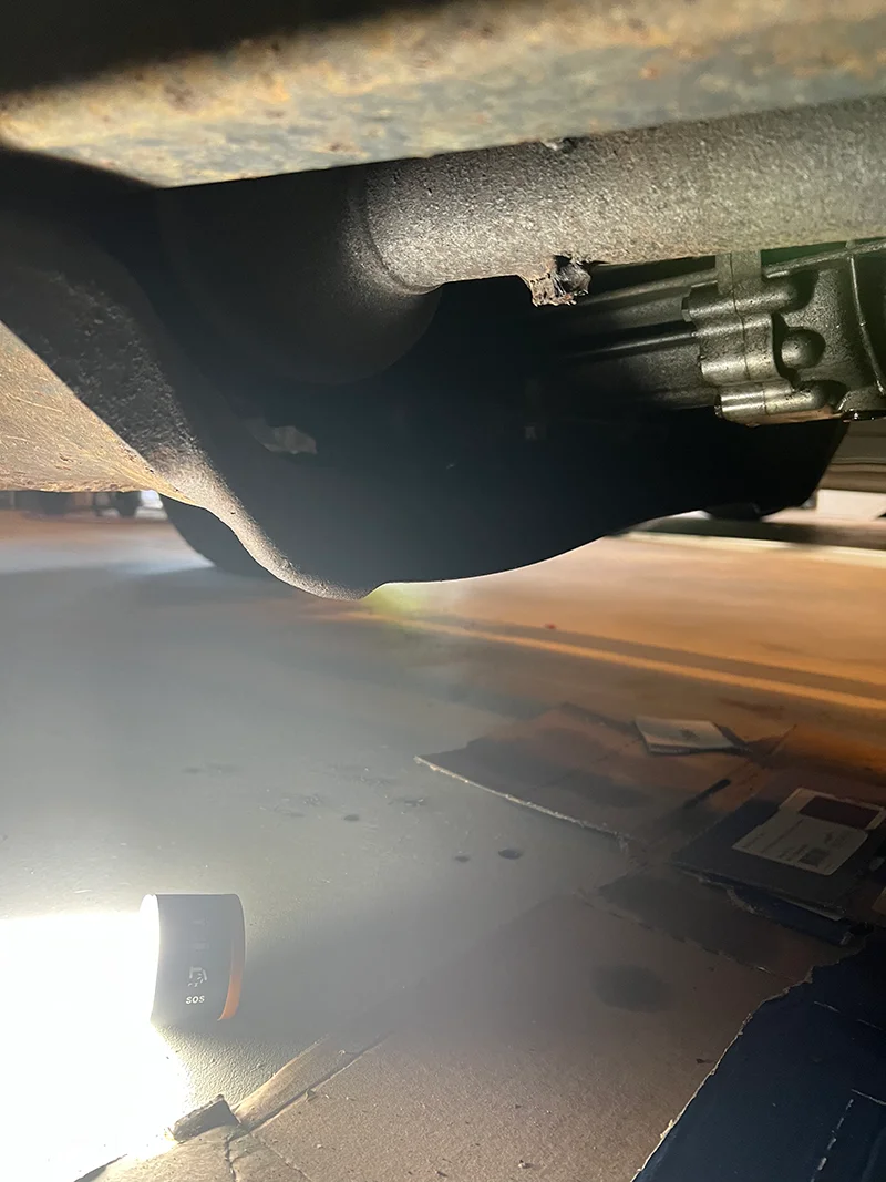

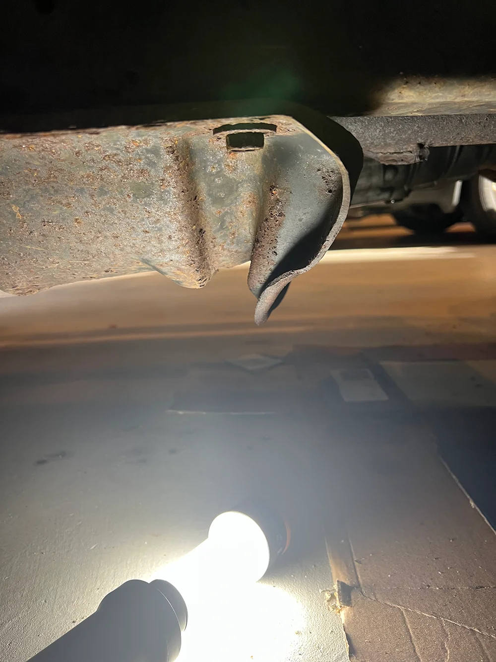

Also here is the skid plate, is this the normal shape? or did the prev owner hit it on something? It looks like the normal shape in some way to clear the catalytic converter?

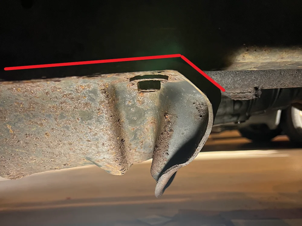

If that's the front passenger-side edge in the first picture, it definitely looks like it's been bent back by something.

These red lines should be a single, flat surface on an unbent skid.
It's bent, but does not cause any structural issues. Bend it back if you like, but that's some thick metal, so it's going to take some force to do so.
