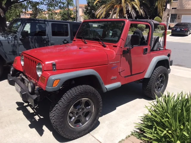

We test drove red Jeep this morning and I’m really happy with the lift and steering. Handles great on the dirt and much smoother than my JKU which has a Terraflex lift. No wobbles or shakes at hwy speed either. Dialed in the steering wheel.
I’m adding hand brake back into the list as well as AC and heating. Neither work, the fan just blows outside air. Noticed the driving lights don’t work either.

Cant get video working. Here are a few pics from our drive this morning.

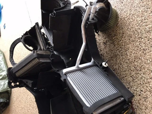

Well after a lot of business travel over the last few months and surviving the holiday season I was able to pull the heater box this week and replace the heater core.
No need to remove the steering wheel, just lifted the dash about 6 inches up and out and the box came right out.
Here’s the new core in place with weatherstripping.
the dash went back together quite easily and I test drove and now have hot air! This was really a pretty simple job but took about 6 hours all in.

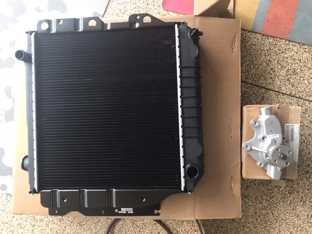

I noticed while the TJ was sitting parked in the same position for weeks that I was slowly losing coolant from the radiator.
So I pulled the radiator and ordered new Mopar radiator, water pump, thermostat, hoses, etc.
While I was in there I decided to replace the timing chain. I’m a bit concerned because the sprockets had some rust on them. New chain has probably 3/4 inch less play.
And look what arrived today!
