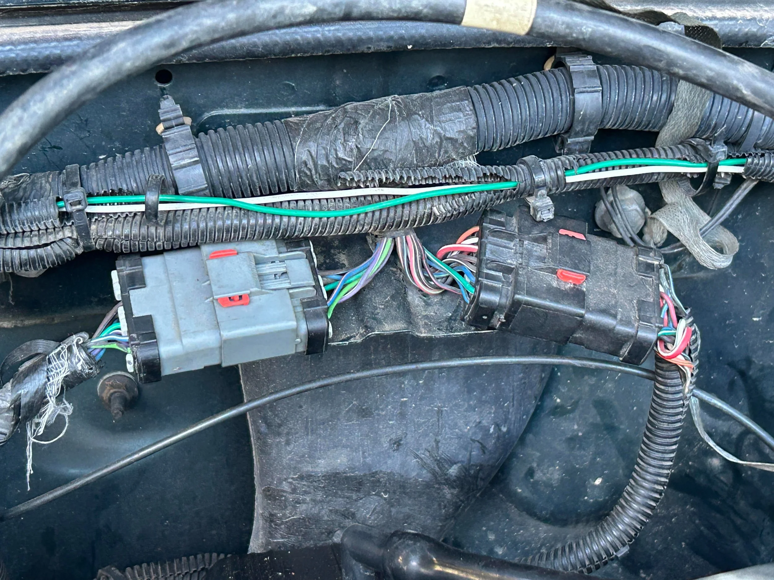

I thought it was the fuel pump because the battery and connectors are all new and the starter was cranking hard trying to start the jeep. Figured it was not getting fuel. I got a new pump and hooked it up dry and it did not turn on. I started checking relays and they all seemed fine. Then I found the harnesses at the firewall were not plugged all the way in to snap in the red clip, so I did that, plugged back in the old pump, and boom... it started.

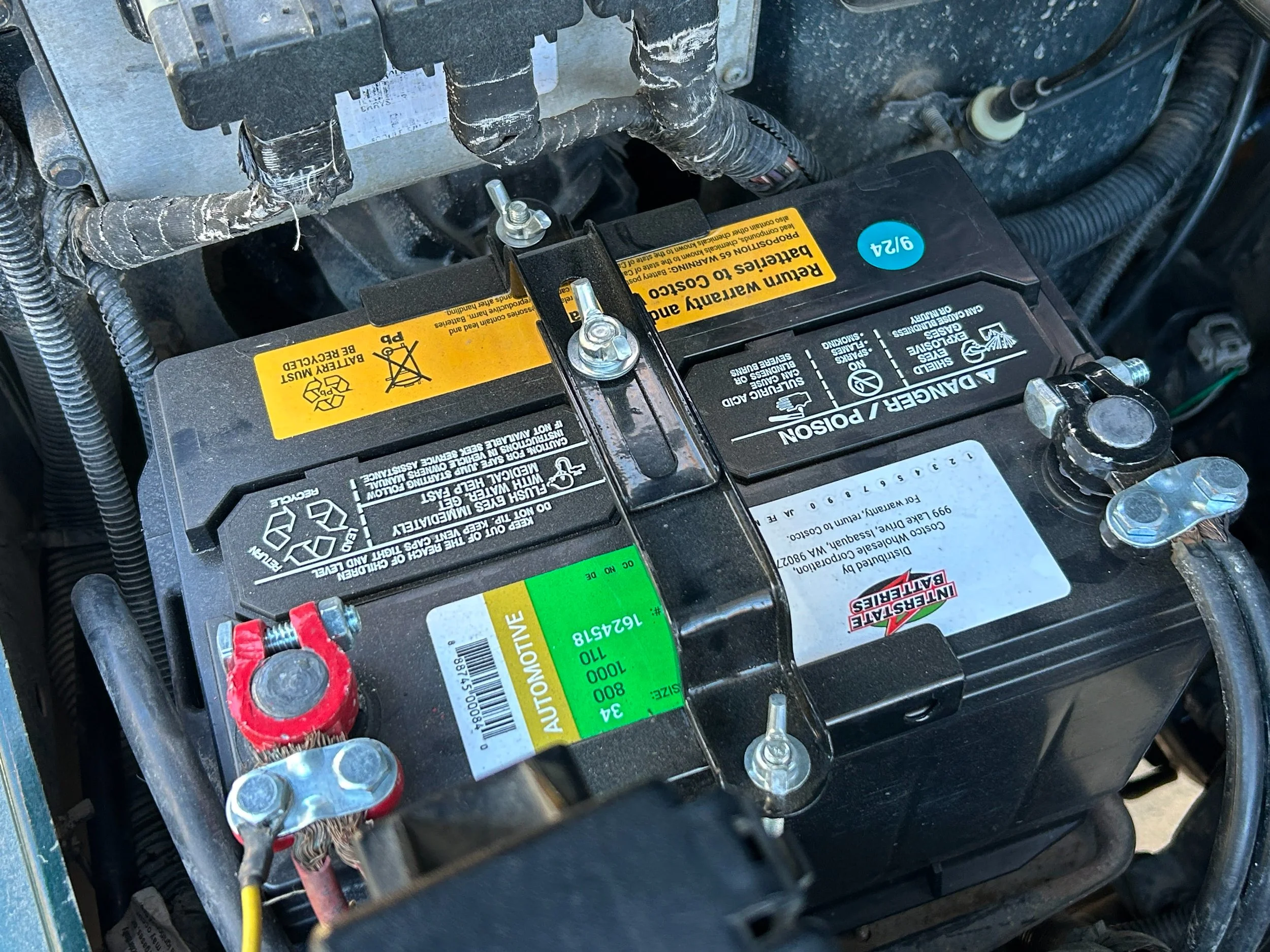

And just as I posted this, went out and it did it's slow start... drove around a bit then back to the house. Turned it off. Tried to start again and the cranking was even slower and not start. Could I have ruined my battery trying to start it so many times these past few days?
I agree you need new terminals at the least, but if you're in a jamb at the least turn those little plates over on the terminals so the dimples are facing down and clamping better on the cables. Just a little trick i was shown years ago.
While you are changing the terminals, change the cables as well. Buy the premade ones in the correct length. O'Reilly's has the best selection.
UPDATE: I took the advice here and switched out my terminals. That along with some cleaning of my cables and tightening of some bolts fixed the problem. Thanks all who took some time to suggest a solution.
So it ended up being a failing fuel pump... or maybe just the wire connector near the pump. Got the new pump and lowered the gas tank. Went to disconnect the wire connectors so I could fully lower it and realized the clip was busted. There is a chance, a dumb good chance, that that connection had become lose or was coming loose causing me to have the intermittent problems described above. However, I already had the part and the gas tank on the ground so I just went ahead and swapped it out. I wrapped the wire connector with electrical tape for now. Starts and drives fine for the past few months.
Oddly enough, in Moab a month ago a buddy's jeep died... could not get it started after a day of driving around. I mentioned the connector and that fixed his problem. Increased the chance that was also my problem but I am still going with fuel pump. Helps me sleep at night. Thanks all for the suggestions and advice!!
