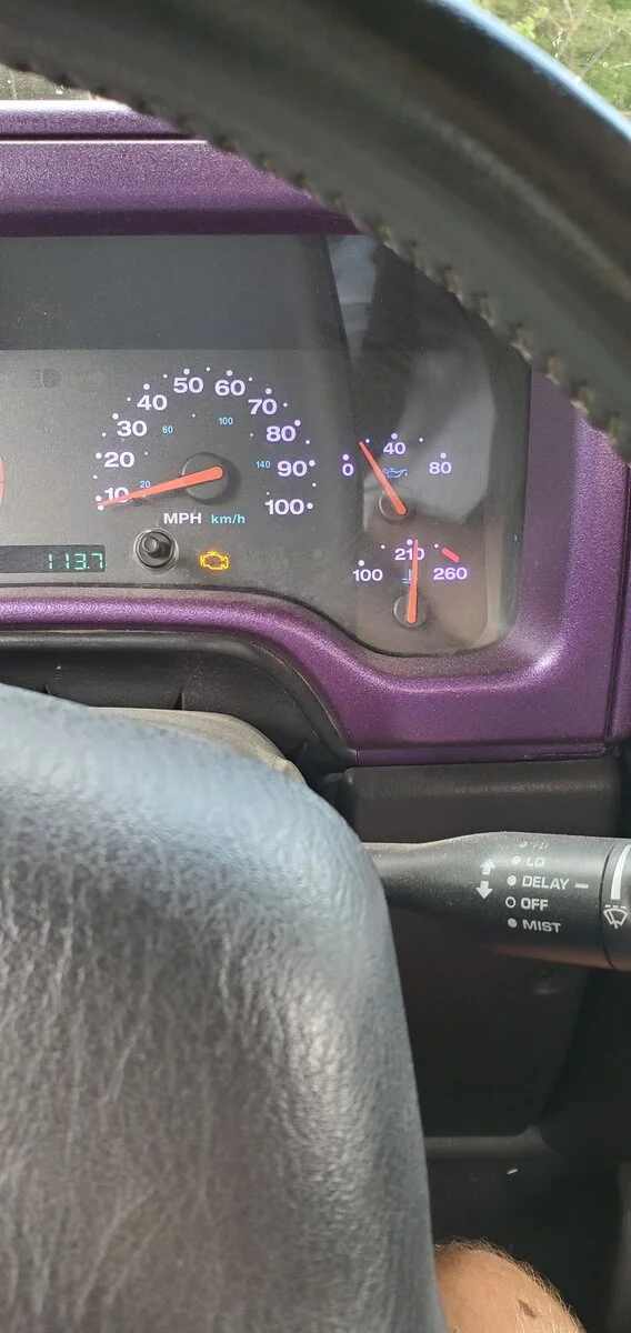

So when I go up a hill in my Jeep, it gives off a rotten egg type smell. My Jeep recently had a bad catalytic converter code. Tried spark plugs first. Ended up changing all the cats (2001 Jeep). The smell is still there at times and I'm stumped. It also gets a little warm going up larger hills. Not hot, just a bit over 210. Another thing is that when it is at a hot idle, the temp will also increase a bit. Here is a picture of a hot idle.

Why does my Jeep get a little warm going up hills and at idle?

What do yall think about the engije getting hotter at idle and up hills though?

I think you have several issues here. The overheating is possibly a failing radiator or fan clutch. Have you ever overhauled your cooling system? I had a problem with my Cherokee where it'd overheat going uphill and at idle; turned out to be a bad water pump, of all things.

Unfortunately I agree with the "several issues" statement. Probably going to start looking into replacing the water pump. The radiator was replaced before I bought the Jeep.

Replaced with what? Unfortunately the aftermarket radiators are notoriously unreliable. Mopar is best. But I'd recommend replacing the thermostat and water pump in that order before you bite the bullet on a new radiator. Might be the fan clutch, although since you are getting hot at speed that likely isn't the problem.

Oh wow. Actually I remember you posting about your cylinder head saga end of last year. Well that's good to hear about the mopar radiator. My vote is on water pump causing your issues.
