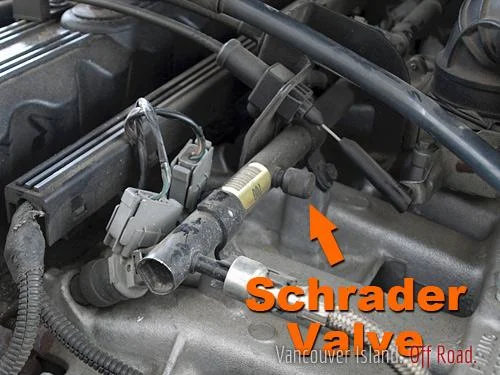

If your Jeep is a '97- '02, there is a schrader valve in the evap system, (Driver's side on engine), for just that purpose. Otherwise, you could get some fuel line connectors, cut that line, put a "T" fitting in it and smoke from there. When you're done, remove the "T" and replace it with a straight piece until next time.

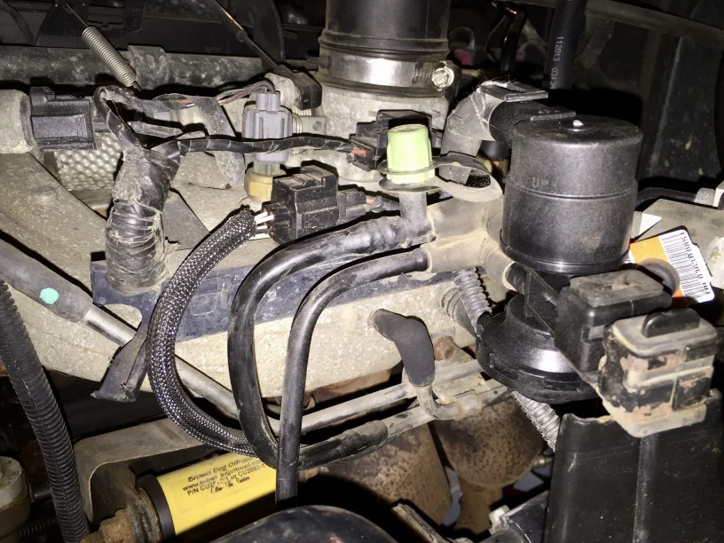

Thank you for your response. this is where the valve is, correct? mine is a 2000 TJ 2.5L manual.
