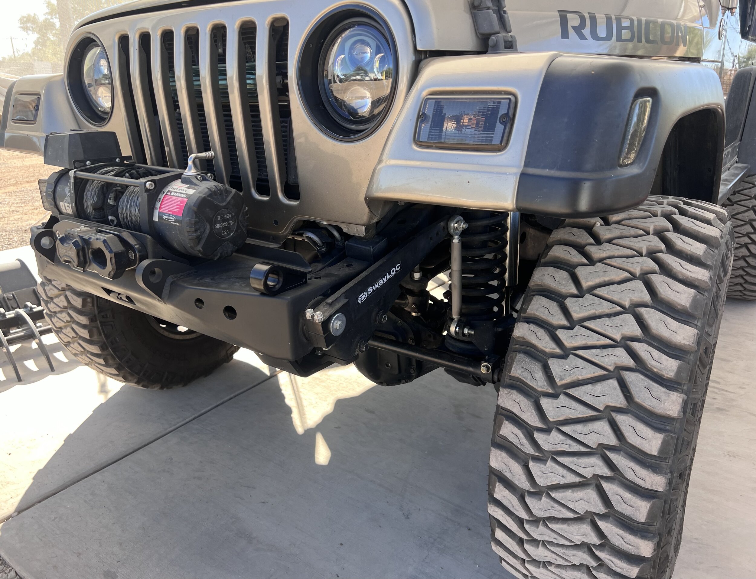

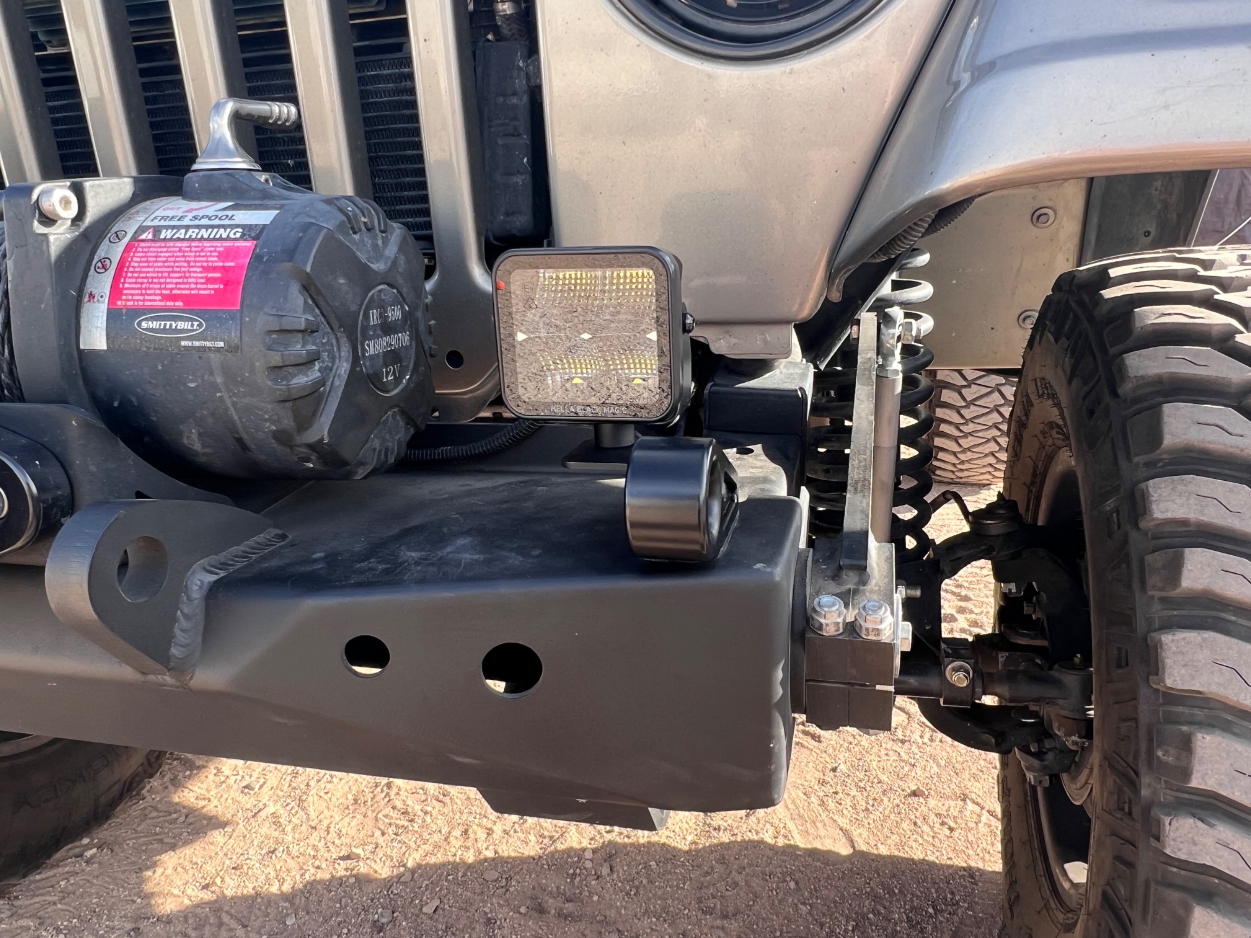

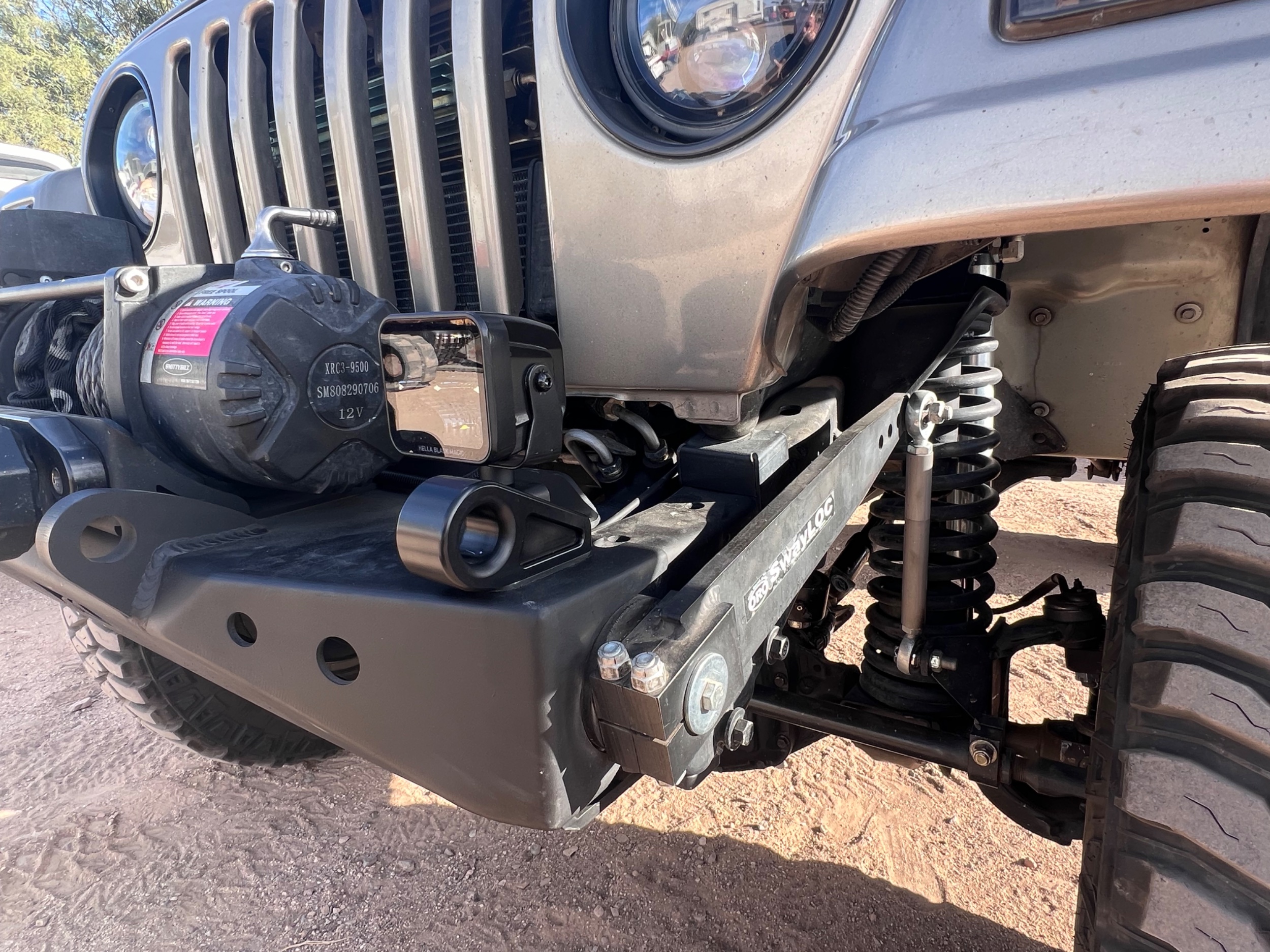

A note of reference that may affect folks with front swaybars in the crossmember tube.
The rear bolts are 2" long. Installed on the frame with NO bumper, just the frame, the bolt sticks through the inside of the tube by right at 3/4".
That means the installed amount of bolt being used is 1 1/4".
Add a 3/16" thick bumper, it is 1 7/16" of bolt being used.
Add a hoop with 3/16" base plates, it is 1 5/8" of bolt being used.
That also means if you run a 3/16" front bumper and run a SwayLOC, the bolt is going to bottom out on the swaybar. Adjust accordingly by cutting the bolts off and grinding a chamfer on the ends or get in touch with a bolt length that you KNOW will work for your situation and I'll send some out.
Your choices are 1 1/2" and 1 3/4".
The shorter would be for 3/16" bumper with nothing else between the bottom of the recovery point and the frame with a larger diameter swaybar. The longer would likely be for bumper and hoop base with a larger diameter swaybar.
The key is we need to know the length and we need the bolt to extend through the nut.

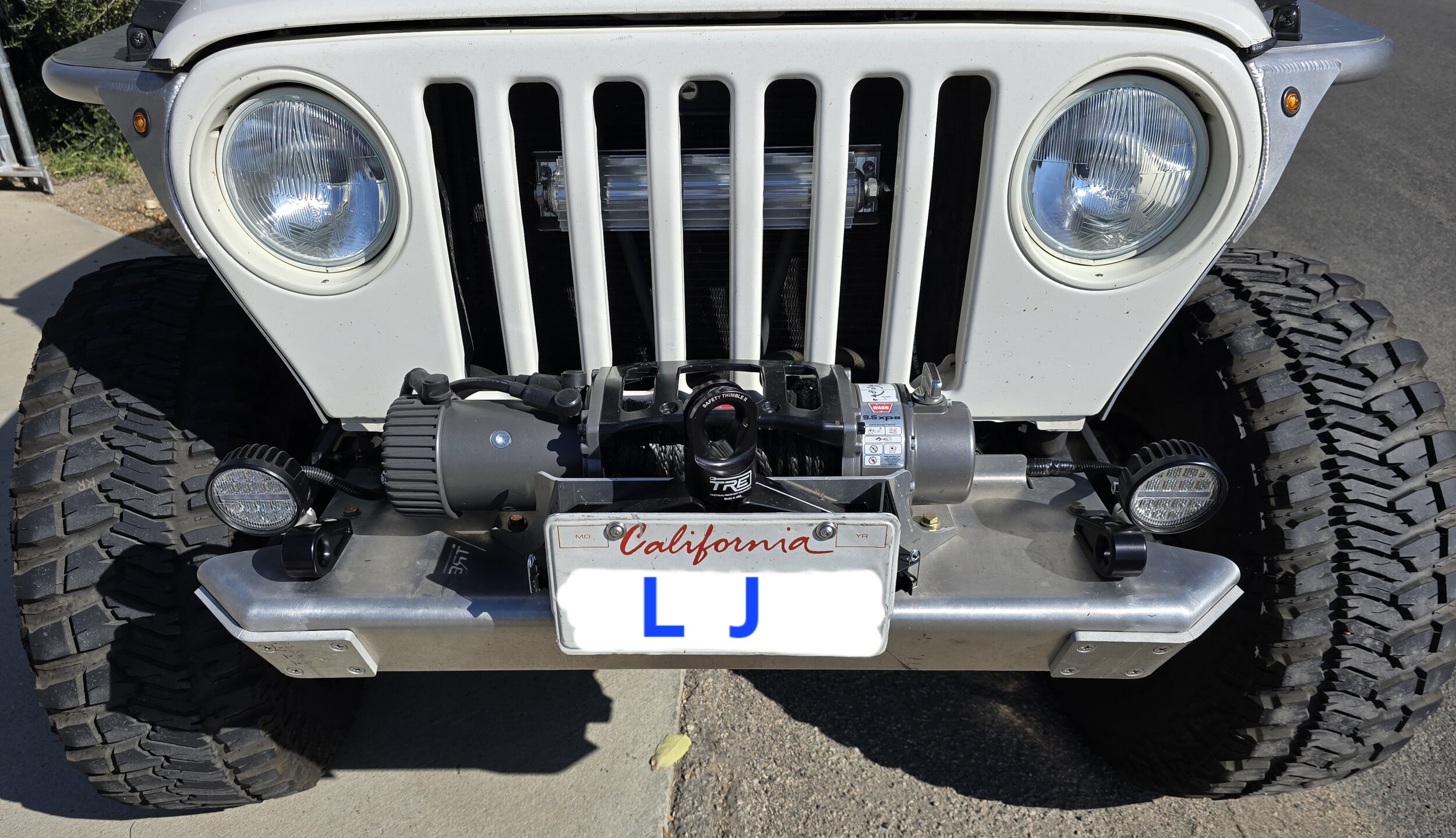

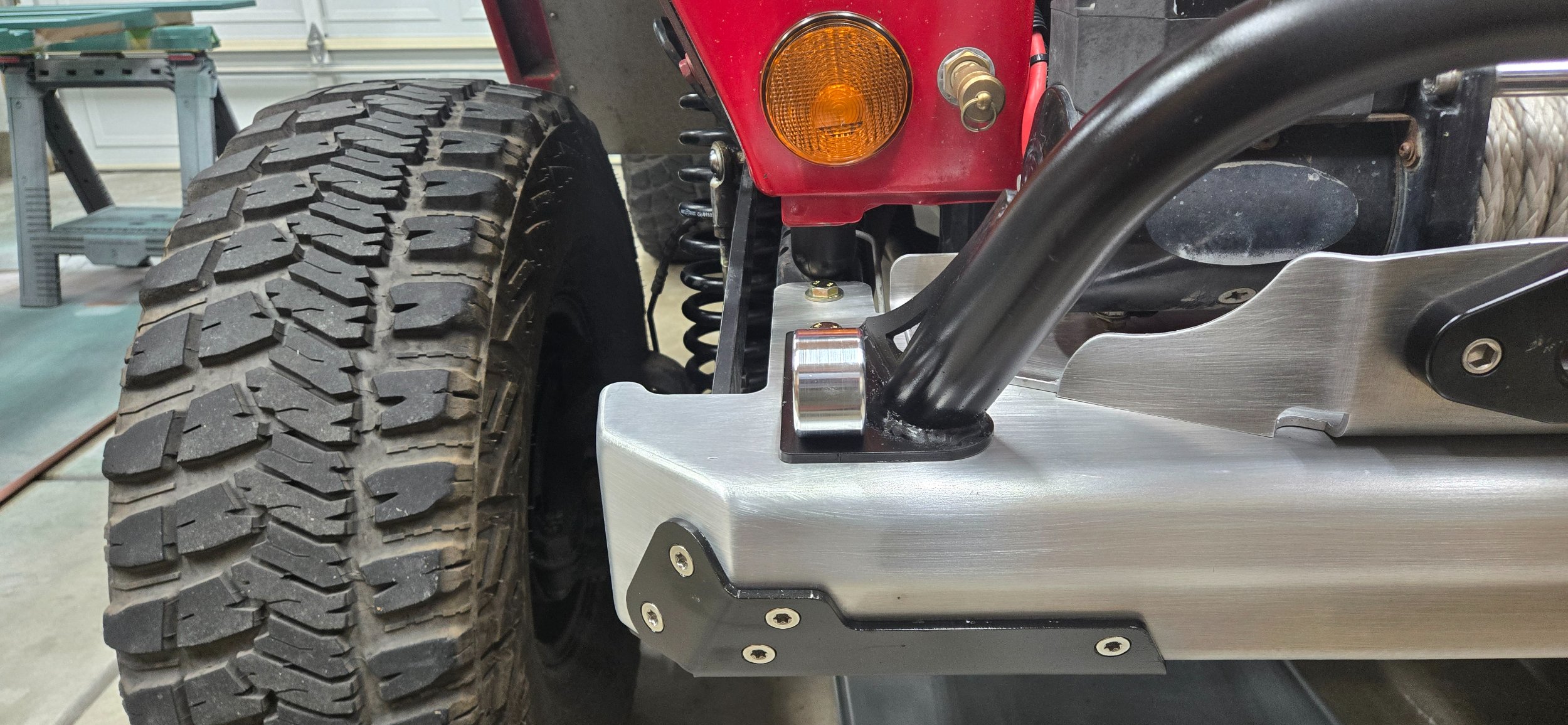

Recieved my recovery points yesterday. Quality pieces.
View attachment 562403View attachment 562404
Agreed.

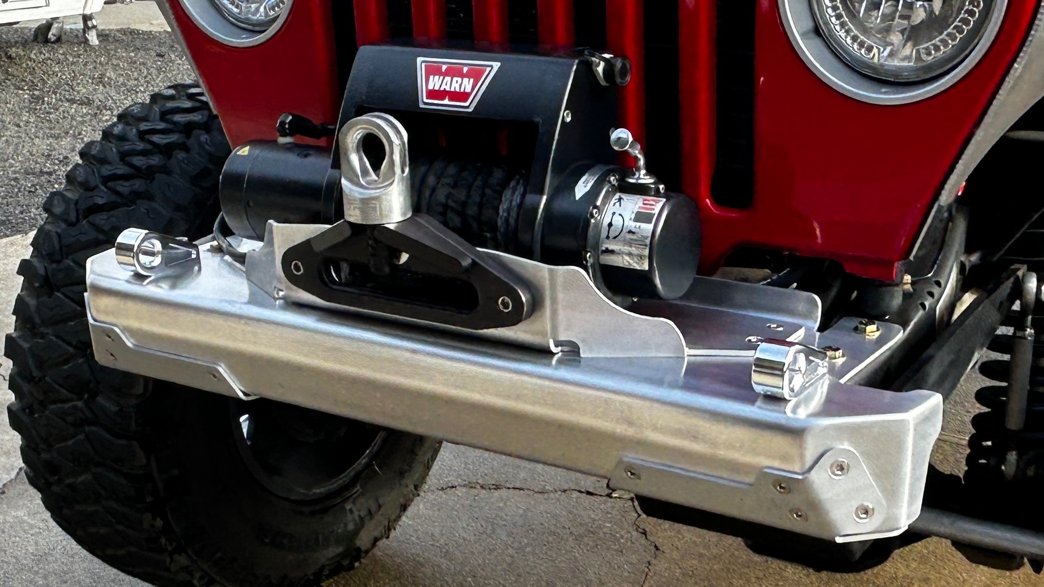

I received the UV resistant hard anodized version from Blaine’s Wizard Recovery Gear website. The quality is excellent.
Same, the machined finish looks great with the raw aluminum theme
These are so well made, and the good news with the anodized version is it will keep its color. My WRG fairlead + thimble retainer was anodized by the same place two years ago
