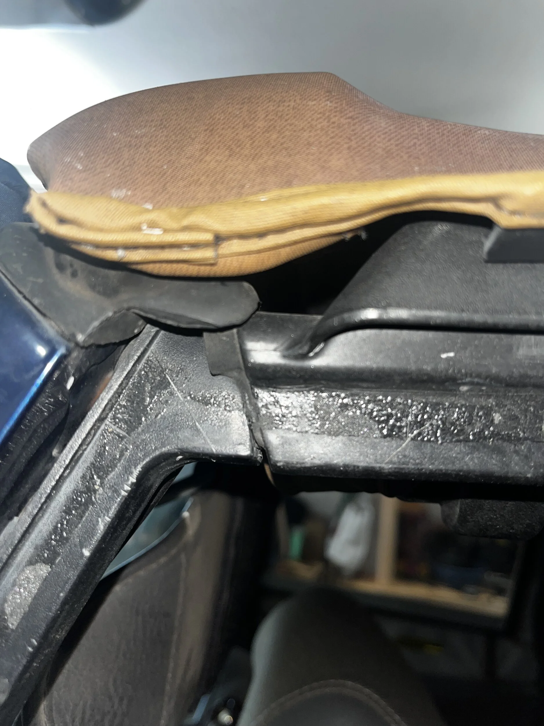

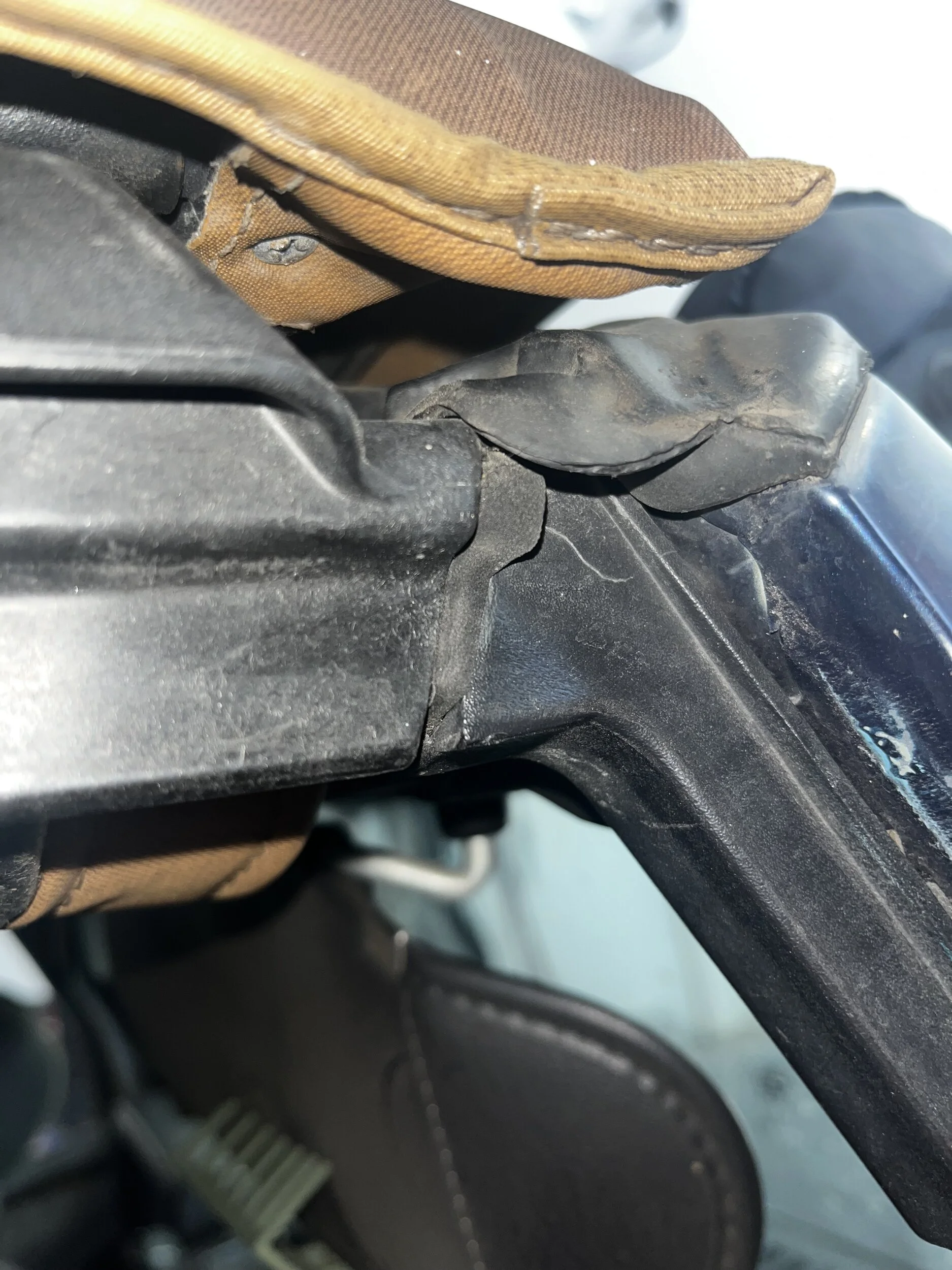

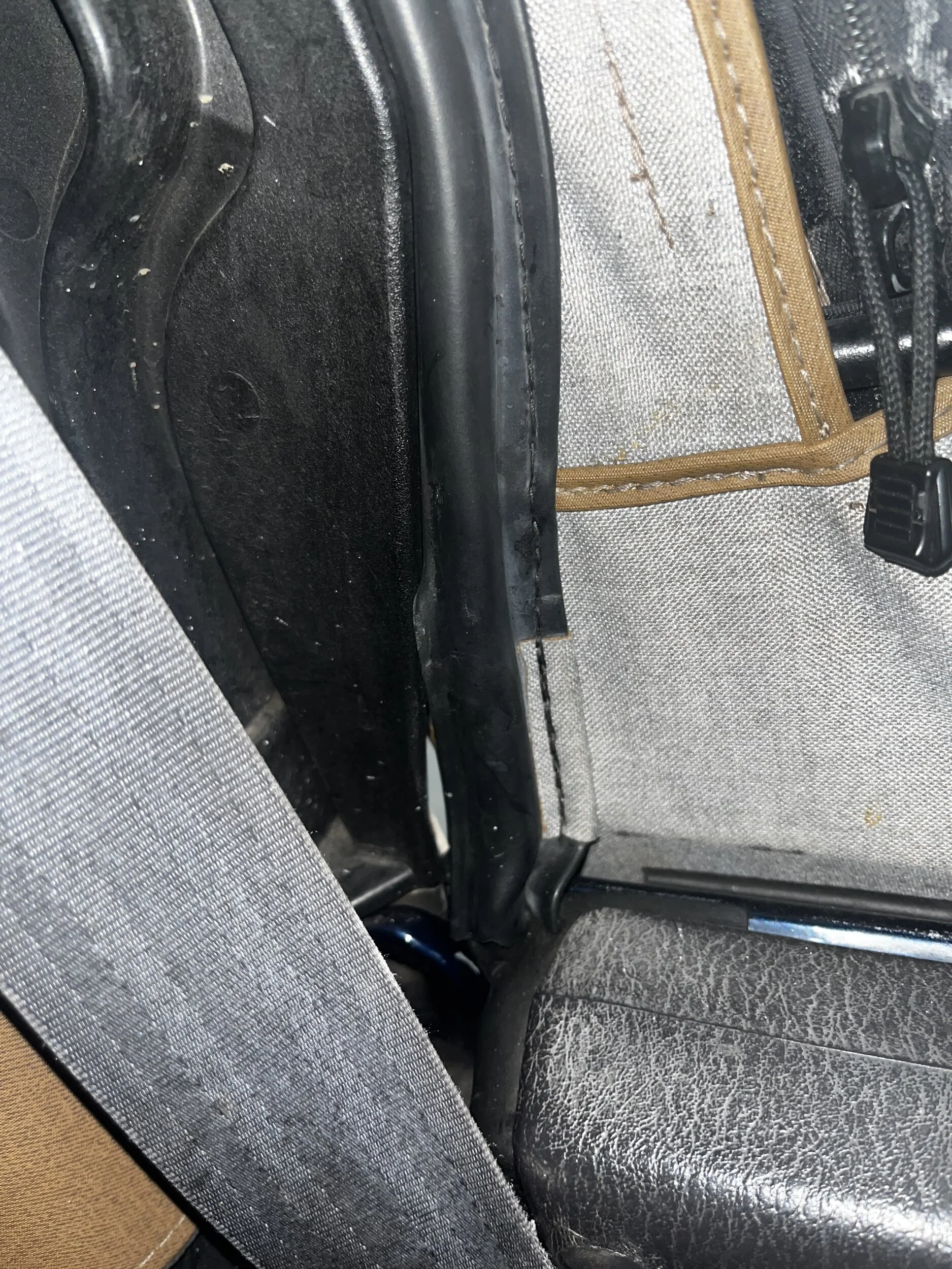

Does anyone know how to prevent leaking (from the door surround) on a soft top with soft uppers? I also have a gap at the bottom rear of my soft uppers and door surround that I can’t seem to fix/close up
Are the front latch hooks fully latched so the latch handles are all the way down? The front of the top isn't being pulled down enough to get it sealed onto the top of the windshield frame.
