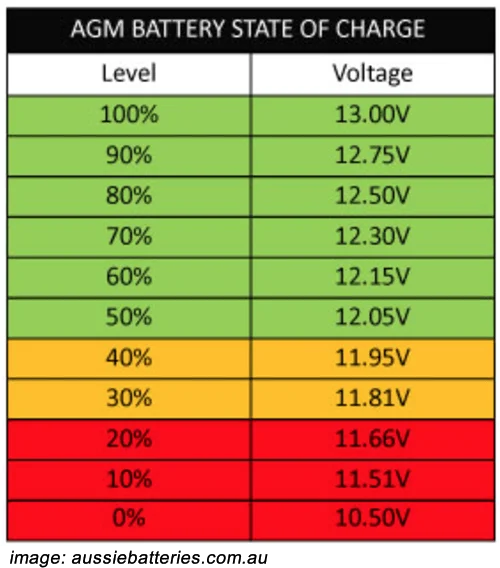

Whether or not a starting battery can handle the double duty of powering a 12v fridge depends entirely upon the Ah of the battery. 68Ah isn't a lot for running a fridge and you don't want to constantly cycle below 50% capacity or you will drastically reduce battery longevity. Starting batteries aren't built for this kind of constant deep cycling, but will work if that is the only option.
The better 12v fridges have voltage cutoffs that will shut the fridge down when the battery gets too low to start the vehicle. Unfortunately, that cutoff is often at 11.8v, which is when the battery is only at a 30% state of charge and may not be able start your rig anyway.
As pricey as it may be, the Dometic CF18 is a good size for the back of a jeep. It draws about 3 amps/hr or 72 Ah/day x 50% duty cycle = 36 Ah/day. There's your 50% of 68 Ah battery capacity right there, and power consumption will be greater if the ambient temperature is high or you like your beer just above freezing.
IMO, you should run a second battery to power a fridge or plan on adding an 80 watt portable roll up solar kit for when you are parked and the engine isn't running.
