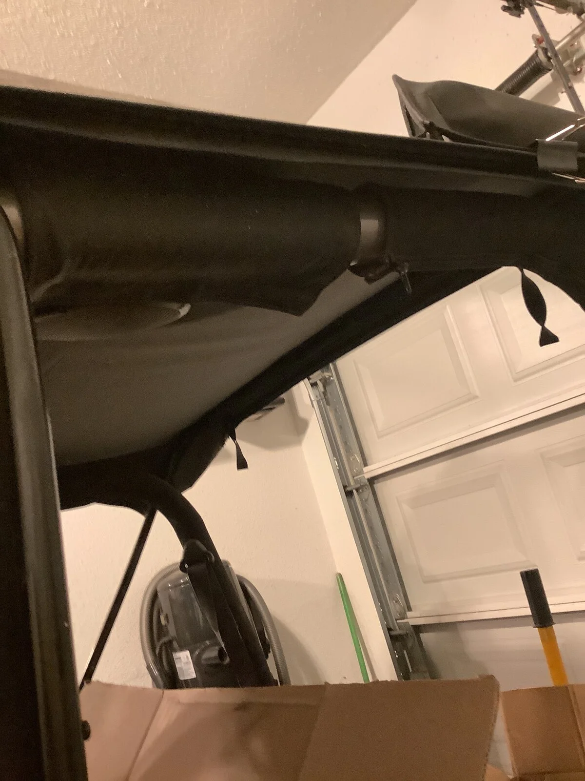

I'm adding a sound bar to my 99 tj. The rollcage has the holes already but the rollcage padding doesn't have any holes for the bolts. I'm assuming it didn't come with a sound bar. My question, is from factory, was the rollcage padding cut shorter or were holes for the sound bar bolts cut through the padding?

I think the padding is shorter. It doesnt go all the way to the cross bar, it ends at the soundbar.

Mine came with the sound bar. My pads go further than the pic you posted—all the way to the cross-bar. The sound bar wraps around it.
But then again, my pads are black with a tan interior, which makes me think they were put on later. And my build sheet says that it came with a stereo delete. So I'm guessing that the sound bar could have been added later too, and maybe was just placed over the padding.
On the early models, the padding was thinner than on the later models, so maybe it's a question of how thick they are. On mine the sound bar wraps around them just fine.
I just know mine is 02 and came like that from the factory.
I think the thicker padding started in 03 and they also switched to the sound pods that year.
